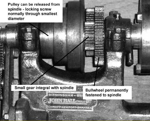

To fit an endless belt to one of those old lathes involves removing the main spindle.
If its built like this one, just unbolt the two saddles, fit the belt, and put the saddles back.
Cheers,  Tony.

Hi,
Couple of posts back ,on this subject, I,ve poster a link to my lathe and the ribbed belts.
Could  a more competent person than I see if you can download it for my post, please.
It , the photo, shows my lathes gears are on top and yes, I have dismantled the gear train a few times , for it requires an endless belt ..
Thank you
