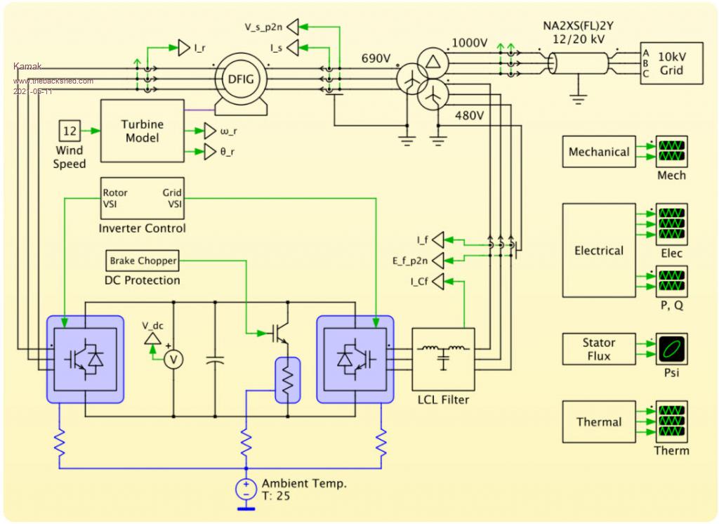

Understandably, the other method of speed control is load control, using torque. This is how some of the big boys do it. It's called a doubly-fed induction generator converter (DFIG). This demo of a modeler called Plexim describes how it works, and allows a free trial for a month, with access to the files that model this wind turbine system. I might check it out just for educational fun.
https://www.plexim.com/sites/default/files/plecs_dfig.pdf
https://www.plexim.com/support/application-examples/282

Yup. those are all really great ideas, I hope you can demo the weedwhacker idea, here someday. I am also itching for an approach that will allow charging and speed control simultaneously and something that is frictionless, in doing so. Something like a simplified DFIG idea (if that is even possibly simplifiable) or a truly simple frictionless eddy current brake/torque reactor. Also something along the lines of a "parking brake". Something manual, that once the rotor is slowed down to a stop, then locks it in place. A smallish motorcycle brake could possibly do, without adding too much mass, I suppose.
