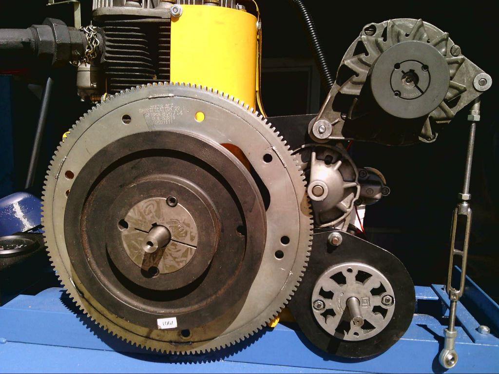

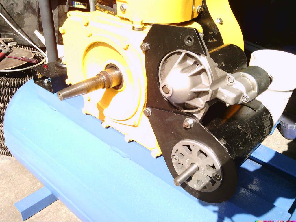

Davo99
Joined: 03/06/2019
Posts: 1586
Posted: 02:07am 18 Jun 2021
Very Nice setup Tony!
Never seen a taper lock pulley on an alternator before. Thats a great idea. I have a strong preference for the internal fan alts because I have done every torture test I can think to the things and never been able to break one. They have 2 fans, one for the windings and one for the electronics cooling.
So looking at the pic, did you sandwich the flexplate and Flywheel on with the Taper lock and I assume make up bushings to locate them with the engine keyway??
I see we use the same idea and method for belt tensioning. The Turnbuckles work Great though I have to wire the ones I use to stop them coming loose.
I have also used Unistrut to mount engines on and fix the alternator and I have put a car scissor jack between the 2 to tension up the belt. That works as well.
The problem with the engine I have is the drive is off the flywheel rather than a conventional Shaft. This is pretty much the layout.

Warpspeed
Joined: 09/08/2007
Posts: 4406
Posted: 04:29am 18 Jun 2021
The Wisconsin has a reasonably long section of one inch parallel shaft with a taper on the end.
The original 230v alternator shaft had an internal taper to jam it solidly to the end of the crankshaft as a very solid extension, with a very long draw bolt to keep it all up tight. There was then just a pretty small ball bearing at the extreme end of the alternator shaft. Cheap and simple, but it seemed to work.
That is a two groove nine inch pulley, and much heavier than the original Wisconsin flywheel that is still there at the other end of the crank.
The taper lock fitting grabs pretty tight, I did not bother to take the crank out to cut a suitable keyway, although I will if the engine ever has to come to pieces.
Looking at the picture of your diesel, the flywheel should come off if you remove the big nut. Then set it up in a lathe along with a suitable flex plate so it all runs true.
Then re drill the three holes in the bosses right through both flywheel and flex plate. Bolt it all together, problem solved.  If you are lucky there may be a means of spigoting the flex plate onto the flywheel at the back. I did not bother, just three  6mm bolts, and the flex plate runs within just a very few thousandths of both eccentricity and run out.
The starter can then project outwards like a sore thumb.
For correct rotation you will need a starter off something that has the starter fitted on the engine side of the original bellhousing.
