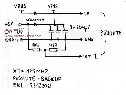

I keep having data that needs to be saved every minute. But I write them in the RAM of the Micromite. At regular intervals, e.g. B. every ten minutes, I then write from the RAM to an EEPROM or to an SD card. In the event of a power failure, the last data is saved in the micromite with VAR SAVE data (). When the power returns, the data is read out again with RESTORE and is available without loss.
The following simple circuit is used for this, which manages with a few components and without a battery. This circuit has also proven itself for years with the MM170, MM470.
The application with the PICOMITE is shown in the drawing. With these values, a data array from data (0) to data (16) with a content of 16 bytes can be safely stored. If you want to store more, you only have to enlarge the support cap.
Very
I think that I have a similar use for this

@Mixtel90
I was considering the battery backup feature but all I need is to preserve production part-count. This capacitor device will respond to a power-outage and give me time to store the part count.
