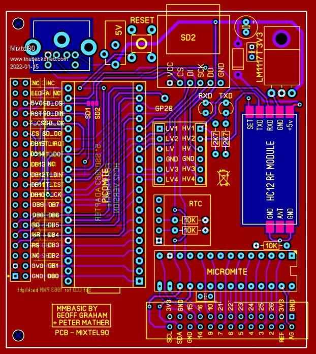

I was unhappy with the location too - I've swapped the text and connector positions.
Unfortunately I can't get RHS mounting holes. The board piggy-backs on the back of the display but, in order to keep the board within the cheap PCB offer, I can't use the full width. However, my board is only 75mm wide and snapping 1.6mm FR4 board over that distance is no mean feat, even when you've scored it on both sides and put one side in a vice. :) I would recommend putting a spacer on the back though, to prevent it shorting something on the back of the display. I've put a 3mm hole to use for one, it lines up with a relatively blank area of the display board so a nylon spacer should be ok.
The SDcard module has a row of SMD, but they are a bypassed supply cap and 10k pullups on the signals. You can use the "pins up" version on the back of the pcb or the "pins down" version on the front. Or you can find a version with no pins and fit your own.
The RTC module is also common on ebay.

Well, I did the other end...
Unfortunately the HC12 has covered the "safe" hole that I'd found for a spacer.

  Mixtel90 said  I was unhappy with the location too - I've swapped the text and connector positions.
Just had a thought for the RS485 PCB - you might be able to fit two RS485 header connectors instead of one to allow daisy chaining multiple boards?
For the HC12 PCB I think layout for the 5 pin through hole header might be a better choice than the SMD version:
1. Can easily swap RF modules if required
2. Modules can be preprogrammed with channel etc on a test jig PCB and simply swapped to actual nodes.
This might be important as there have been fake HC12 that use different crystal, preventing communication between real/fake HC12s.
Didn't mean to cause extra work, never occurred to me that you might layout for SMD rather than header connector so apologies for not specifying.
Of course, doing a separate PCB for HC12 probably allows space to throw in JDY40/HC12 RF modules (both same pinout) and CDEBYTE 7-pin modules to allow flexibility in RF module selection. Let me know if you want to implement these, I can post my notes for those modules.

Posted: 01:18pm 15 Jan 2022
You shouldn't daisychain RS485 like that. Common the loop wires in the same plug-in connector so that when you unplug a node the rest of the loop stays running. Alternatively, connect the loop to a local box and plug the node into that on a short stub (not as good - it can sometimes cause all sorts of echoes on the loop and reduce the range).
I'll consider a header type for the HC12, but the SMD version will probably be more stable from an RF point of view. I won't be making any of these boards anyway. As a radio amateur I know that there's enough c**p out there on the air without adding more.
The only HC12 modules I can easily find that have pins are a short black version with the antenna already soldered onto one end (usually out of stock).
I'm quite happy to give you the SL6 file if you want to make a version in Sprint Layout.

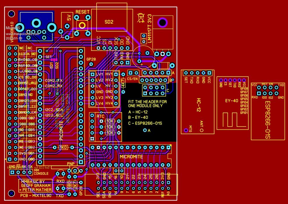

Here's a version for the HC12 and EY-40 wireless modules.

With some leverage I've managed to squeeze the ESP8266-01S in.

Nice. I can't tell for certain, but do you think you have enough capacitor to get the ESP-01 over the humps? The LM1117T is very capable, but weediness in the power supply is perhaps the biggest problem with the ESP-01.
Posts: 9230
Posted: 08:16pm 18 Jan 2022
Hopefully. The incoming reservoir is 1000uF and the LM1117 is 800mA rated. In theory I think it should handle it, but space is very tight. lol
I'm more bothered that the antenna isn't really far enough away from the ground planes. Even if it were, the board will be close to the display so that might cause problems with any module that uses a PCB antenna.
The voltage on the ESP is wrong in this pic. I've shown it on 5V. :(
Posted: 08:39pm 18 Jan 2022
Ah, +now+ I see the cap.
