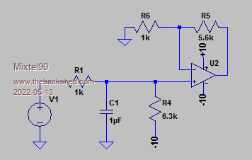

Posts: 9228
Posted: 12:32pm 13 May 2022
I found this on a search. It seems to be ideal:
This is the source.
A bit of tweaking in Circuit Simulator leads me to:
1k + 6k2 along the top to set the gain.
16k input resistor, 2n2 cap.
97k to -10v
(allowing +/- 12v supplies for the op-amp)
Edited 2022-05-13 23:17 by Mixtel90

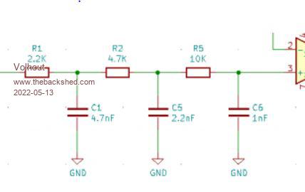

Posts: 6190
Posted: 01:57pm 13 May 2022
Check how much resolution Craig needs. If you have 125MHz pico, and run the PWM at half that (62MHz) and need 16 bit resolution on de analog output, the PWM should run at 1kHz (62MHz / 65536). Then 2N2 is not adequate.
If you run 100kHz, you have around 9 bits resolution (620 steps) then 2n2 may work.
It is nice to see that you envision 16k series resistor.....my 100kHz PWM filter...
Maybe for goodness sake you should re-calculate R4 to connect to -12V (not -10)
Edited 2022-05-13 23:58 by Volhout
