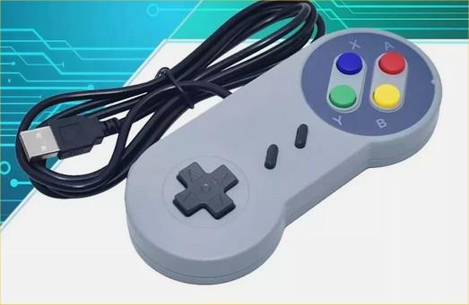

FWIW I think the USB host/HDMI/PICO2 should now be the default games machine. This can use one of the cheap car monitors as per your "rig" and the assumption should be a basic USB controller would be available as an input device with 12 buttons but no analogue joysticks.

  matherp said  FWIW I think the USB host/HDMI/PICO2 should now be the default games machine. This can use one of the cheap car monitors as per your "rig" and the assumption should be a basic USB controller would be available as an input device with 12 buttons but no analogue joysticks.
I agree with regards the USB host, though I'm not prepared to give up on my RP2040's yet.
Note however that there may be a wrinkle to sort out with the generic 12-button USB controllers; @Mixtel90 has one where the D-pad is not reading as button presses but instead as the left-analog stick pushed to its maximum extent. If/when I escape MMB4L I will do some testing of my own.

Thanks for the controller which I have sorted. RC3 on the main thread will have support so please check with your other device.
Should be supported on any USB variant RP2040 and RP2350
Edited 2024-10-01 22:32 by matherp

Just tested it. It works beautifully. :)
