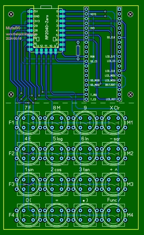

Just playing with a concept.
Overall size is about 120mm x 72.5mm.

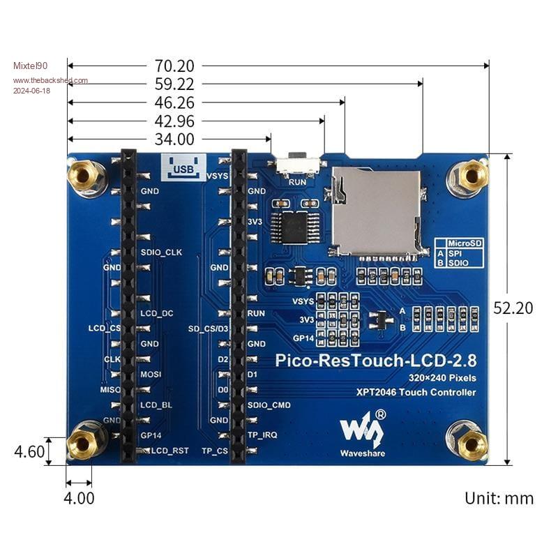

This board has male header pins onto which you plug a Waveshare Pico Res Touch 2.8 display. The RP2040 Zero obviously can't be plugged in under this because of height, so I've surface mounted it. Power is provided via the USB-C connector. I'm wondering if I could squeeze a rechargeable battery in. :)
I've shown the keypad with two different sorts of buttons so it's a bit of a mess. It's just to see what will fit. The KS01 buttons are the round ones, the larger ones are the cheap Chinese "clicky" buttons, which can have round or square caps. Others could easily be used.
Touch is supported, which might be handy for something like program selection.
[Func] controls the keypad as 2-level, activating the alternative function for each key, so to get / you press the [Func] key twice.
Pressing [Func] then F activates F1 to F4 function keys.
Pressing [Func] then M activates M1 to M4 function/memory keys.
The RP2040-Zero hasn't got a RUN input so GP8 is programmed as an active low interrupt input to reset the system.
The keypad is scanned in the background, using the KEYPAD command. This scans the keys continuously and executes an interrupt on every key press. That routine decodes the press (via an array) and keeps track of a "keypad level" flag, which decides how the current key is going to be decoded.

Hi Mick,
As a calculator you would expect yhe display horizontal. Rotate the whole pcb 90 degrees cc.
Then, after 90 cc, the keypad is not in right orientation(7,8,9 are at the left side, should be top side)
This is just silkscreen..
Edited 2024-06-18 00:49 by Volhout
Posts: 9220
Posted: 03:22pm 17 Jun 2024
This is just playing. :)
The display is landscape. The Waveshare module is fixed to this PCB using spacers in the four holes. Normally you would plug a Pico into the rear of the display module in a "vertical" layout with the LCD in landscape. I've designed the board to simulate a Pico. The pin arrangement you are seeing is from the top of my board, i.e. the mirror image of looking at the back of the Waveshare module.

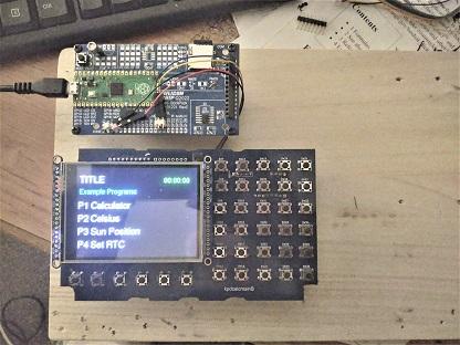

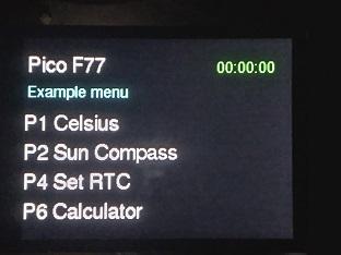

Added a simple menu type display... calls up relevant program.
Mashing some bugs (but looks better than the photo      )

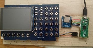

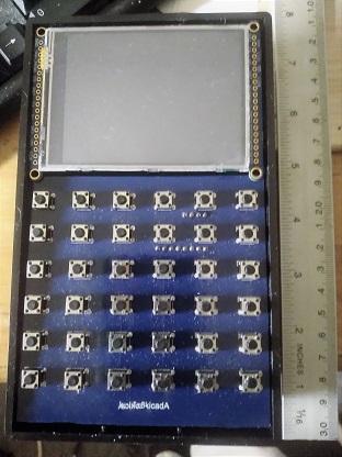

The lateral/landscape pcb with the keypad, keypad IC module, display and display uno. It is all driven by an I2C connection. AS such it forms a I2C terminal.
Here it is connected to a Pico via I2C, (a SC backpacK) and  the four wires can be seen. Tho photo is a bit fuzzy sorry, it looks better in real life.
Now I am confident the implementation/hardware direction is solid.

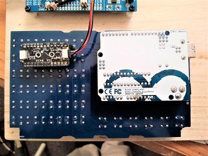

the other side with the tca8418 and uno

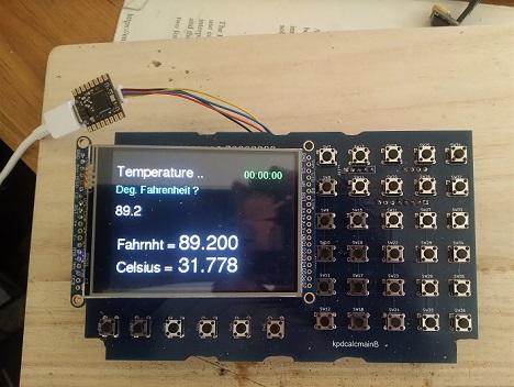

An experimental port (so far without SD micro) to a rp2350 is reasonably OK.
Example program loaded from the PC usb/serial link, prompts for fahrenheit number, converts it to celsius, displays .
[ Using a "Tiny" 2350 board which just has usb and I2C sockets - above display ]
The uf2 is for a generic build so it is on thin ice.

The "QZ" statements just populate/sequence the display fields and data.
