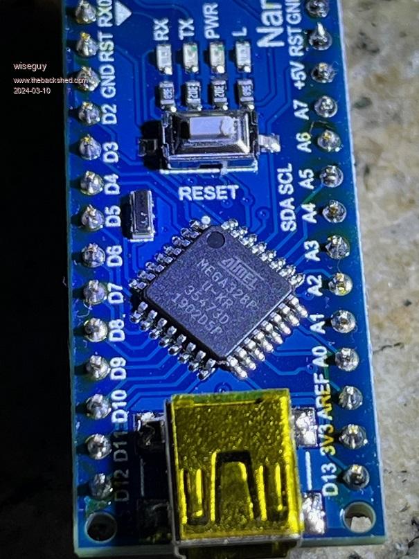

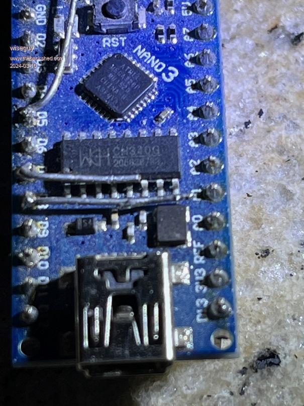

Roger I've decided to answer the question and as its for you I'll do it for half your suggested payment.
Typical Good Nano, note only the main mega IC on top
Very Bad Nano (maybe I just got a bad one?) Note second IC on top
Look for the one similar to the top picture and note there are 3 different USB connector types on Nanos - I use the USB mini as per the pictures, there is a USB micro and a USBC type. A listing light just have the one you want in the big picture but maybe not all the ones they sell are the pictured ones so look closely at the smaller picture that you click on before purchase.
A seller or two with good Nanos is a good idea to post a link - Ill leave that to Poida.
