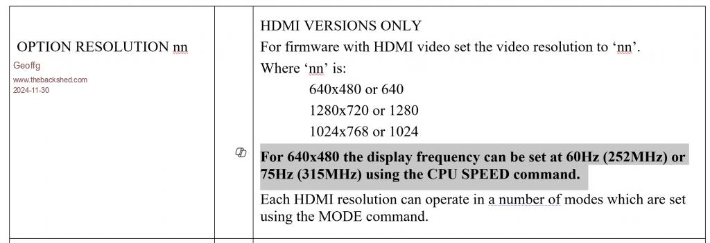

OPTION RESOLUTION 640/640x1280 [,252000/315000]
In the case of HDMI 640x480 you can choose the display frequency 60Hz (252MHz) or 75Hz (315MHz)

  matherp said  Geoff: another trivial one
Sorry, that does not make sense.  What page, what context?
And anyway, how can you have a resolution of 252000/315000.
  matherp said  In the case of HDMI 640x480 you can choose the display frequency 60Hz (252MHz) or 75Hz (315MHz)
Is this correct?
