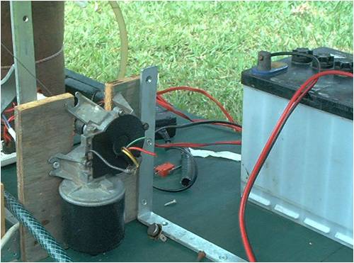

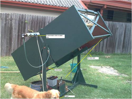

Tracking was achieved using a circuit that a technician friend of mine built using a couple of green LED's but just noticed you can buy one ebay for $22!
http://cgi.ebay.com.au/basic-LED-Solar-Sensor-unboxed-solar- tracker-DIY_W0QQitemZ200419562043QQcmdZViewItemQQptZAU_Gadge ts?hash=item2ea9efd23b
The sensor circuit controlled a windscreen wiper motor hooked to a 12v battery. A cable was wrapped around the spindle & seemed to move at the right speed. A counterweight was used on the other side. I used thin cable that would break in event of a failure (tremendous torque potential of motor) There were some reed switches at each end to stop it going too far. Seemed to track the sun pretty well.

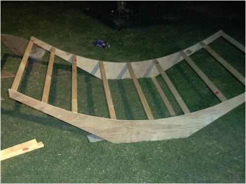

This design of trough has a major flaw. Because the sides are enclosed, as the sun goes off axis, the light shines on the sides (caught on fire once!). What you need is open sides & the receiver needs to extend further out the sides. It's probably better to build wider rather long as I did.

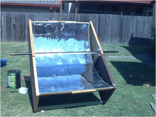

Here is a second prototype which was better. I'll see if I can find more pics of it.
The receiver is actually black. It's copper pipe that I painted with flat black paint. It just looks shinny when the light is concentrated on it.
Hope this helps.
