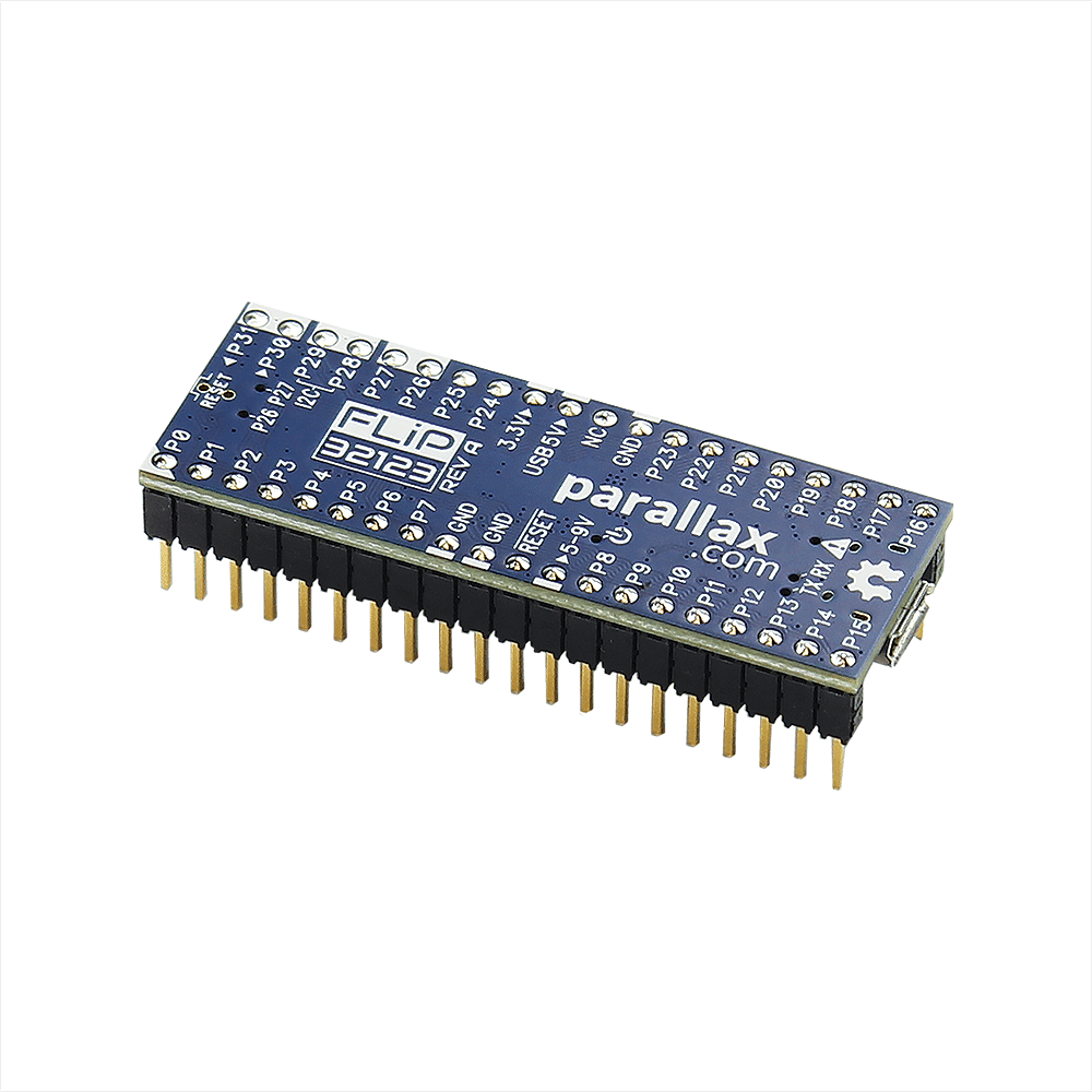

Well if we are suggesting other processors, the Propeller simply cannot be beat for this sort of thing and no messing with interrupts.
FlexBasic is like using MMBasic but compiled and the supplied IDE is super lightweight.
Perfect timing with zero latency or jitter.
Propeller Flip Module:
FlexBasic is part of the
FlexProp suite
PDF manual is in the zip file.
