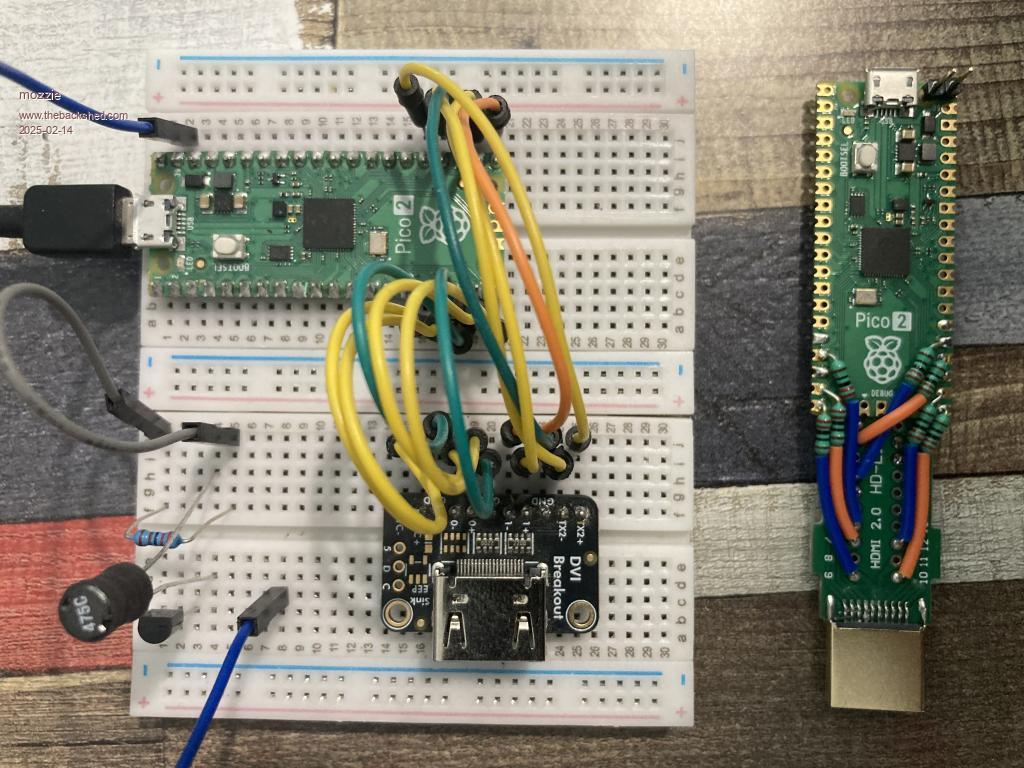

G'day Tom,
I wouldn't worry about the wiring too much, these are 2 of my test setups and they work perfectly at all resolutions tested
If you look back at some of the HDMI threads there are all sorts of setups and for the most part they just work surprisingly well
Regards, Lyle.

Thanks folks, I'll stop over-thinking it .

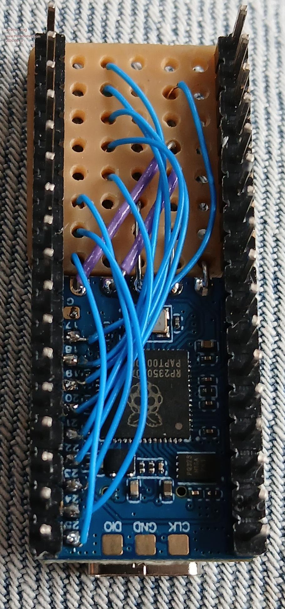

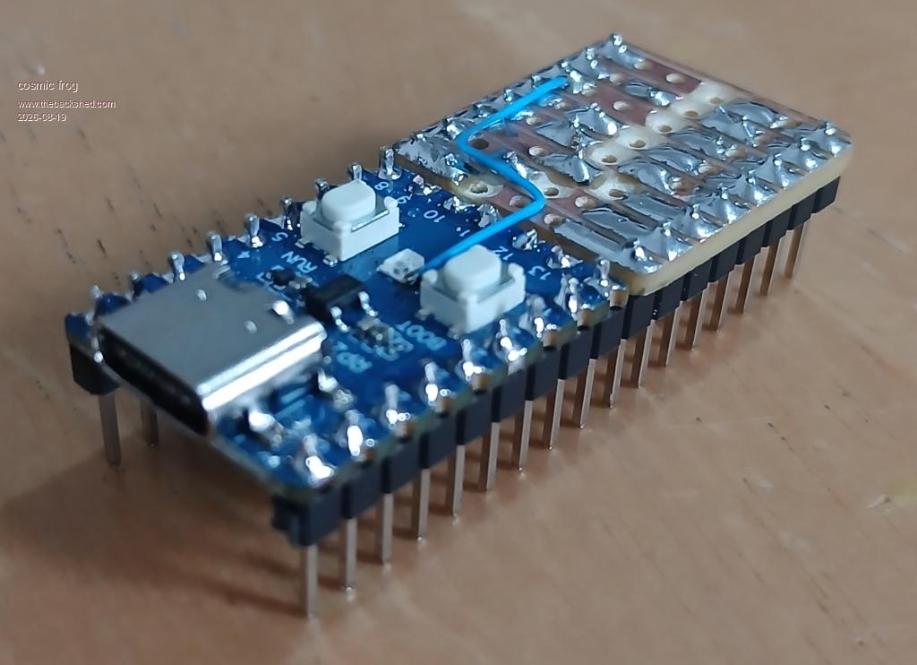

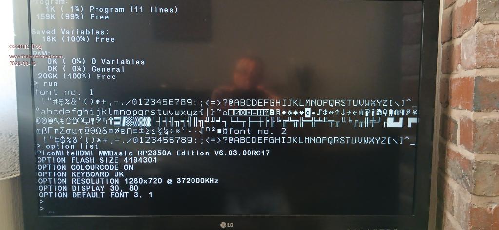

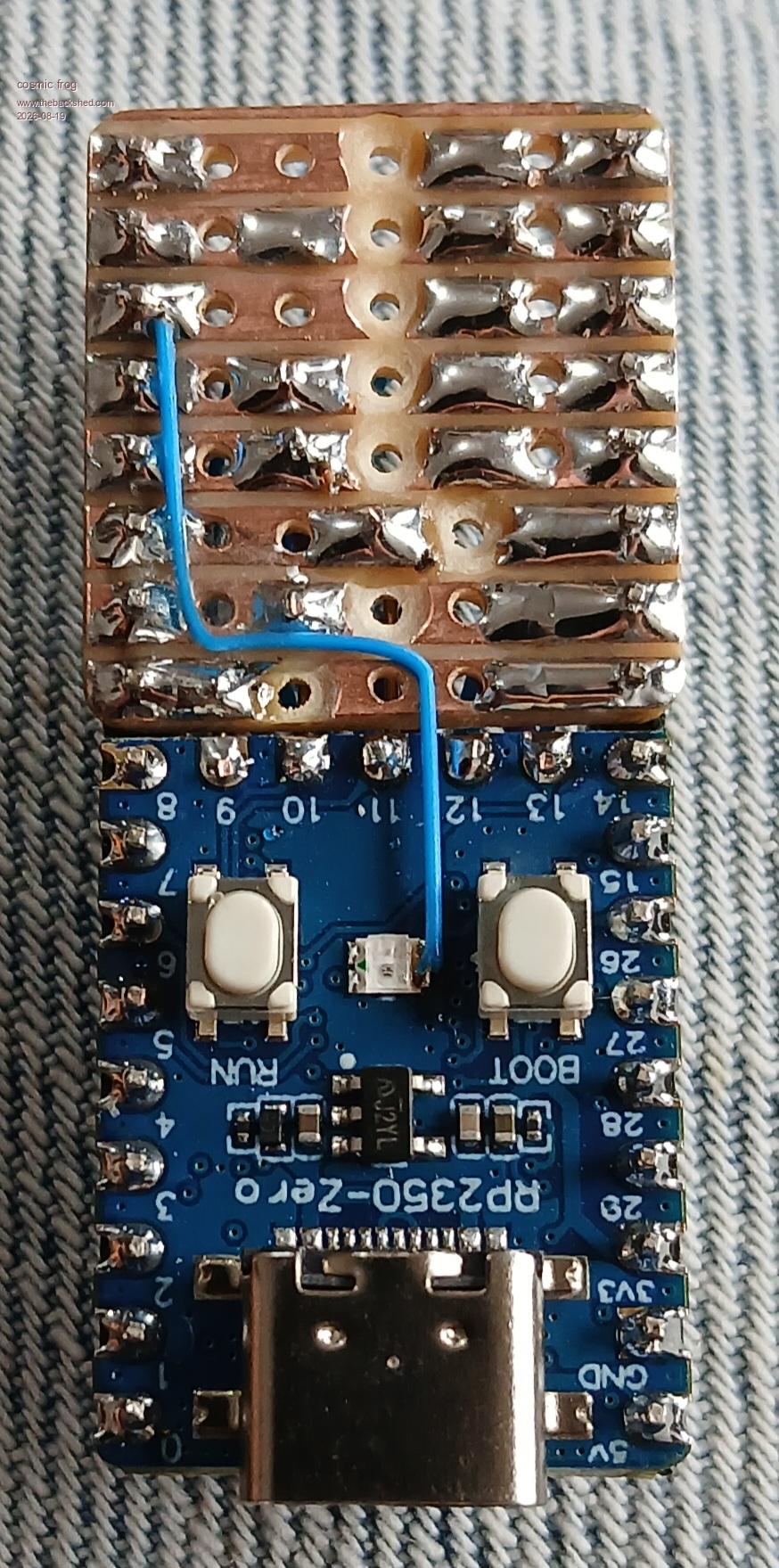

I managed to get HDMI out of a RP2350 Zero by extending the board. But, because the chip is on the underside of the board it tends to heat up and reset after about 10mins. You can fix this by turning the board upside down and adding a small heat sink.
Notice how GP16 is taken from the onboard LED.

@cosmic frog
Are you sure it is the RP2350 overheating ? Or is it the SOT23 linear regulator for 3.3V ?

  Volhout said  @cosmic frog
Yes, I think it was the main chip. Once I put a heatsink on the chip and turned the board over so the chip/heatsink was facing upward, I had it running ok. I think I left it on for about an hour or so. However, I never thought about the regulator.
I don't think I would use this method again as it was very fiddly to wire up and took a lot of time.
