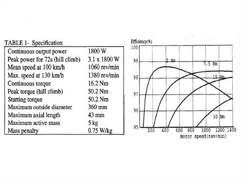

[Quote=JB@Marand]At what price point would you be happy to pay for a 98% efficient device?
98% efficient?!?!?!
Heck, ain't nothin' that effecient except maybe a growing plant! 98% is bordering on God!
Copeville, Texas
JB@Marand
Joined: 13/01/2010
Posts: 4
Posted: 11:40pm 13 Jan 2010
If you go to http://www.csiro.au/resources/pf11g.html#design and hit download you will get all the technical details of the motor and the configeration drawings. Attached is an image of the basic specs and efficiency curve.
Jamie
Better is the enemy of good

For JB@Mirand. The figures are useless at this stage. I will check your site later, but it is the coil impedance/resistance I would be interested in. Your figures will drop like a rock using it as a generator driving a near zero impedance load. The axial flux is near 100% efficient at cut in, and will drop to 50% at maximum power. At this point and onwards it will continue to output, but burn up is likely. Mine will do 5kw all day into a R load, but less than 1.5- 2kw continuous into batteries@ design voltage, and 3-4kw into my 96v bank.
An indication will be coil (EMF (DC)- battV)^2/starphase R. or phase R if using independant rectification or Delta. This will give you your stator losses. 98% is when your doing no real power into the batts.
