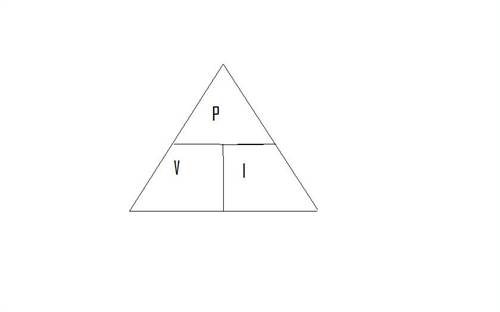

Maybe the old VIR, PWV triangles would help as well.
Cover the one you want to calculate. ie. Power(P) = Volts(V) x Amps(I). Amps = Power/Volts
