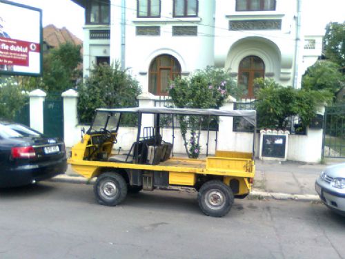

I looked for a photo with an old electric car used by Romanian Mail for loading/unloading the trains. No success yet... maybe I will make a photo on a first occasion.
Edited by vasi 2014-06-21

Edit: Sorry, is not what I thought it is, it is a Steyr Puch Haflinger, but looks very much like the electric car we use for postal transportation inside train stations...
______________________
I found one, but is tuned by his owner...

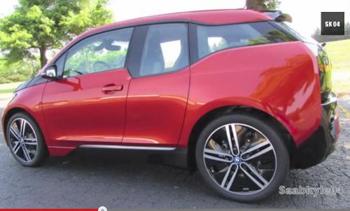

I would like this BMW i3 more than a Tesla.
