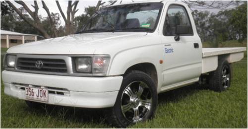

Progress is being made with the equalizer circuits.
Recently been involved with Qld Fire & Rescue, State Road Crash Rescue Challenge. Posted here.
Eco Expo 2011 is coming up soon, 5th June.

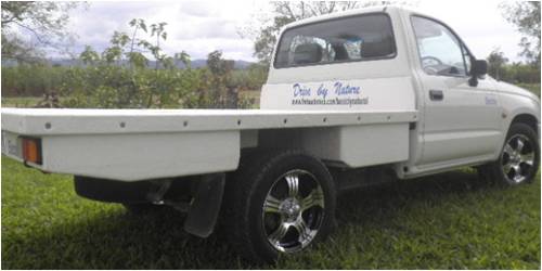

New wheels have been added.

Flash looking set of mags there Trev

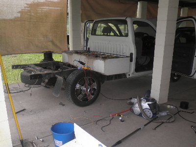

Some more changes with the EV Hilux.
The test samples of the equalizer circuits have arrived and so needed to work on re mounting the 2 Zivan chargers. They used to be under the bonnet, but I had trouble with one (the first and so was the oldest). It eventually stopped working due to water ingress and dust. I bought a new one.

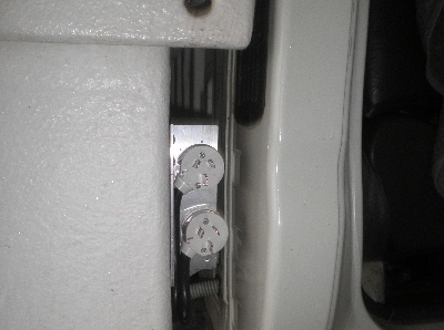

The 2 Zivan chargers are now mounted behind the drivers seat. No more water and dust. The Zivan charger has an open/closed circuit in the end (facing up in the picture below) that can be used to switch on the equalizer cicuits, when the Zivan charger reaches trickle phase. This is now connected as well. I just need to get a different relay to make it work.
These equalizer circuits have been improved. They have an output of 4 amps, but also are physically bigger as well. These 2 have been tested and worked well. I have ordered a commercial quantity.

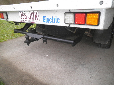

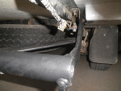

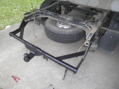

Also have fitted the original towbar back on. First cleaned and painted. With this towbar fitting, I had to cut the fibreglass back to allow room where the towbar bolts on.

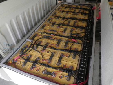

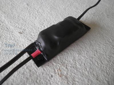

Some more to add about the DC/DC equalizer system testing.

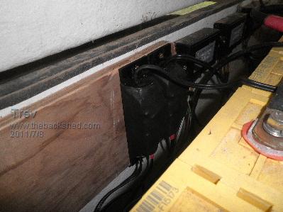

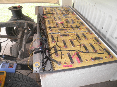

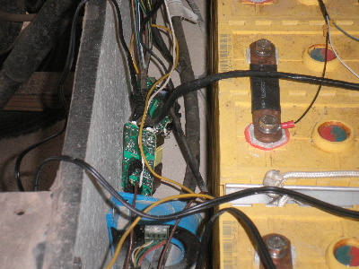

These samples I have sealed them up and mounted in the battery box. Tested well for a while but then they stopped working. I put the multi meter in the output wire to see how much current, if any, was flowing.

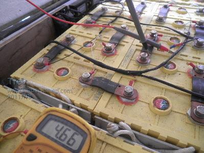

They worked well, too well, more amps then they are supposed to put out. The pic below shows 4.66 amps. I had seen as high as 5.8 amps, at one stage. But then, take the multi meter out of the circuit output wire and they did not charge.
It was found that they only worked with a small resistance. So I calculated the resistance provided by the multi meter - 0.047 ohm or so. The smallest resistance I could find was 0.1 ohm. It worked, but cut the current back too far, back to 2.4 amps. I have requested that the manufacturer add a small resister to the output of the circuits.
This is charging the low volt cells from the higher volt cells.(far better than the 0.6-0.8 amps that some burn off systems have from other manufacturers).

Trev, 0.047 Ohm could be easily provided by a short length of wire. A little experimentation should give you the right size and length.
If you prefer to use a resistor use 2 x 0.1 ohm in parallel, giving you 0.05 Ohm which is very close to your target.

Yeh Tinker, I tried that with higher value resisters and got lower, but not enough. When I doubled the 0.1 ohm resisters it didn't make any difference when I measured it. Don't know why. It should have been half the resistance.

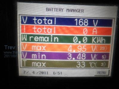

Posted: 10:21am 01 Aug 2011
Equalizing stuff up.
I have 1 cell in particular (cell 23) requiring a top up every week end to maintain comfortably the range I need. I have these 2 equalizer samples on cell 23 (centre of the pack, & always the hottest) and cell 5 (which isn’t really bad). Cell 5 did not have the resister and therefore was not charging (no problem anyway), but cell 23 did have the resister.
Cell 23 was low so I switched it on, without the main charger on, holding pack voltage, and thought I would come back later and switch it off before it got higher than the other cells.
I forgot. That in itself is not a problem because the equalizer charger will only go to 3.75v.
The problem occurred the next morning after I had charged the pack with main charger. Cell 23 was higher than the others and so became over charged, by 0.7v. As pictured.
This would not happen if a complete system was in place. These are samples in test. The complete system requires all cells have their own equalizer charger and they are only switched on with main pack charger holding full pack voltage.
As a result I noted a huge internal resistance in cell 23. With a full pack voltage, at 300A, temperature at 18C the terminal voltage drops to 1.7v. Remove the load and terminal voltage comes back to 3.3v. As the cells warm up, the terminal voltage under load drop is less, but even at 40-50C the terminal voltage of cell 23 drops below 2.5v with load. I see the same pattern when charging. The load of the charger pushes the terminal voltage of cell 23 higher, but as the charger cuts back at the end of charge, the terminal voltage comes back to normal.
I also note that heat generation is now higher in cell 23 than it used to be.
On a positive note, I have not noticed any drop in capacity in cell 23.

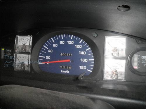

Posted: 09:12am 23 Aug 2011

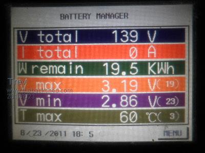

The EV Hilux has now passed the 50,000km mark with the LFP Thundersky (now called Winston Batteries) battery pack. They were fitted with speedo reading 350153 and now is 400231. That is 50,078km.
Range check, did 91km using 19.5kWh, driving mostly at 100km/hr.
Some capacity drop from last range check, but a lot better than I thought it would be.These LFP batteries were fitted in August 2008. It is now August 2011. 3 years. My guestimation is something like 800 cycles at high currents & very deep discharges. Temperature is often around 40 to 50C, at the centre of the pack (cell 23). The edges of the pack are 5-10C lower. Today with range test the centre reached 60C and the edges are at 43-46C.
These batteries still do not have any automatic equalizing system on them. Balance every weekend, basically I just keep the pack at full voltage and switch on the 2 x single cell DC-DC converter chargers shown in previous post. Once a month I do a rough manual balance with some of the other cells. As said cell 23 is the one that most of the fuss is about, but as just proven, still has the capacity, so is still worth the effort to keep topping it up.
Really, these batteries have taken a flogging (& still going) compared to what lead acid would give. I am impressed to say the least. They will be in the Hilux for some time yet.

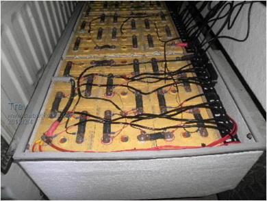

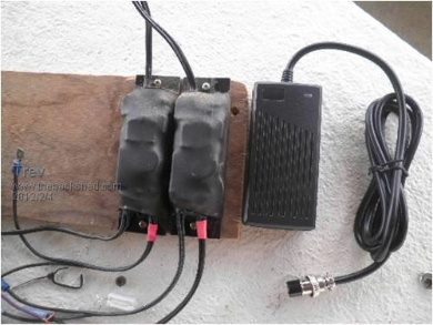

It has been a long time since I said I had ordered a commercial quantity of single cell chargers. Well, because we discovered that they stopped charging after a while, and needed a resister in the output, we asked the manufacturer to add the resistance. They refused. I cancelled the order and took close on 6 months to get my money back. Thankfully they did eventually refund it.
I was not keen on spending the time to add the resistance and have a product with reduced output current as a result. I still had to do the packaging. With the original test circuits, I used heat shrink over the circuit and base board, with potting in both ends to seal it up from dirt and water. All this hand work would make them too expensive for sale.
A new supplier and a new product were found for single cell charging. The output of these chargers is 3.7vdc. Input is pack voltage, 167vdc.

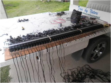

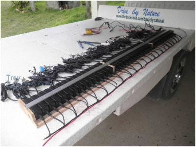

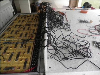

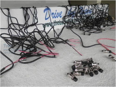

I set about installing them. All the input wires were connected in parallel. The input was to be switched through a solid state relay from the Zivan NG3 charger. The relay fried itself before I even connected it up properly. I tested the function by holding the coil wire (12v) and the output just went closed circuit, but would not reopen. So the test was conducted by manually switching the 3.7v chargers on.
When you look at all the wire it looks a bit scary. But just work on one at a time and it’s all easy connecting. It doesn’t look so bad when all cable tied neatly.

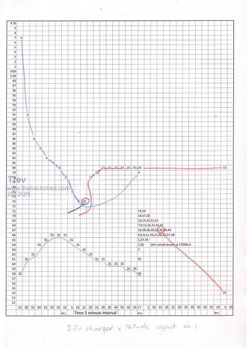

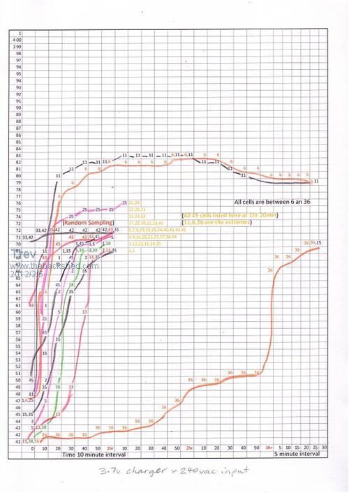

Test 1
The Zivan charger was to charge to it normal voltage of 167vdc and holding battery pack voltage, the 3.7v chargers are switched on. The high volt cells do not get charged, because they are higher than the 3.7v output of the charger, but drain off because the chargers on the low volt cells are taking power to charge. The idea was to get them all to be of similar voltage.
The pack at 167v, the highest cell, no.6 at 4.07v and the lowest cell, no. 35 at 3.58v. Only the highest and lowest cell was monitored until it was evident that it was not working. Note, cell voltage come down but then go up. Cell voltage go up but then come down. Output of the chargers were not stable and fixed. Mostly however the cells remained fairly close together in voltage, but not reliable with a number of cells going haywire.
Edit: attempting to see what happens with resizing pictures.
Pictures need to be 501 pixels wide or more to get the watermark.
Pictures above 500 pixels wide will auto resize to 500 pixels wide.
Pictures need to be 390 pixels wide to fit 2 side by side with a space between them. No space to picture underneath.
To get the water mark on pictures smaller than 501 pixels, upload as normal. Copy the picture, resize to required size and edit post, re-uploading picture with watermark. Or put your own watermark on first.
I used to have all my posts with pictures side by side. New software changes the rules.
Scanned the graph with different dpi trying to get it bigger, but makes no difference to view size when uploaded.
To view bigger, on your web brouser, click tools, click zoom.Edited by Trev 2012-02-06

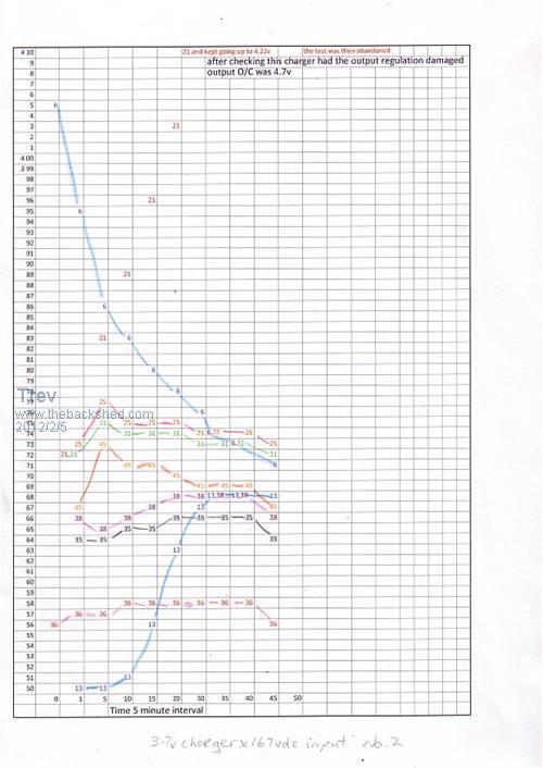

Test 2
All cells were monitored. I took hundreds of photos of my Battery Monitoring Screen. Then many hours going through the screen shots to trace the behaviour of the cells. A random sample has been added to the graph, including the highest and lowest cells of the pack.
Cell 21 mucked me up. The charger output open circuit was too high and so the test was abandoned after 45 minutes when cell 21 became 4.22v.
The results seemed to be a bit more like the expected. High volt cells coming down and low volt cells going up. But take a close look at the cells in the random sample in the middle. The voltage they start from is exactly the same voltage they finish on, no real benefit.
So with a pack voltage of 167vdc, high cell,6 started at 4.05v and low cell, 13 at 3.50v and finishing up at high, cell 25 at 3.73v an low cell, 36 at 3.56v. That's 0.17v difference. The chargers are all measured to be close on 3.7v, so the results are not as they should be.

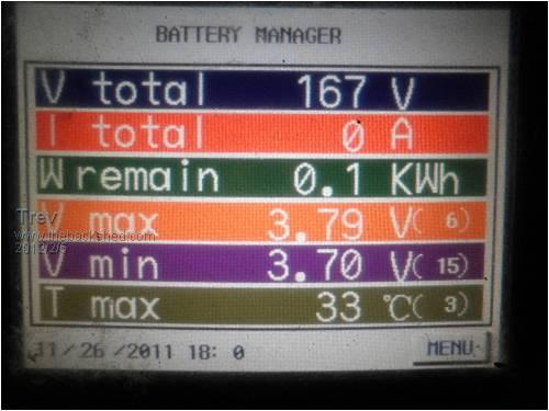

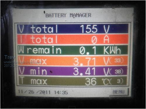

Here is the pictures of the BMonitorS main screen at the start and finished of the graph in the previous post.
Every morning, within 1/2 an hr, finished at the same, high 3.79v and low at 3.70v. A difference of just 0.09v.

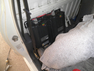

I have 4 cells x 90ah LFP in the Hilux EV as the 12v pack and has not been balanced since I tested the first Relativities Active Balancing circuits from Gordon. I have no problem with them.

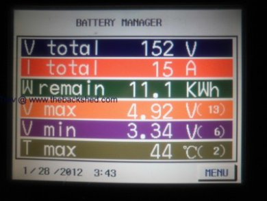

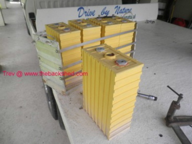

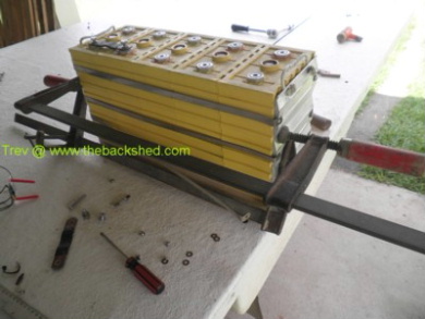

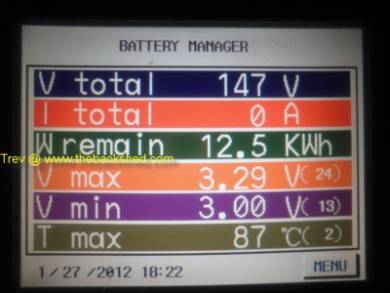

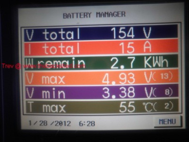

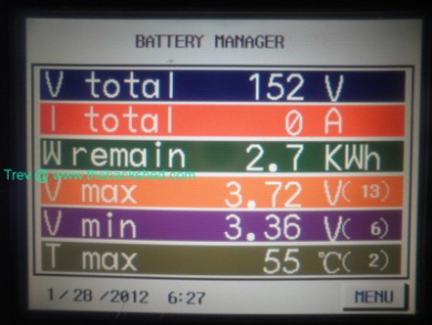

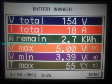

Cell 13 was cell 23. Position 23 is the centre of pack and is always the hottest. This cell showed signs of greater internal resistance. Then appeared to charge higher and discharge lower than the others.
I shifted it (the whole 5 cell block) to position 13 so that it would be able to cool better. As stated in a previous post, I had over charged it by quite a bit. This over charging created a masive internal resistance. I continued using it but under normal discharging (driving) it always sagged to 1.0 -1.5v. As soon as discharge stopped it sat on 3.0v +. It was not empty. It still drove me round trip of 75km each day for a good while.
It has now been removed from the series string. The last couple of trips was driven with it sagged to 0.0v when pulling around 100-150A. It showed normal voltage 3.0v, with no discharge. Then you can see what happens with 15A charge. The resistance in the cell pushes the voltage up. I believe this is only tension, not really what is in the cell. Terminal voltage only if you like.

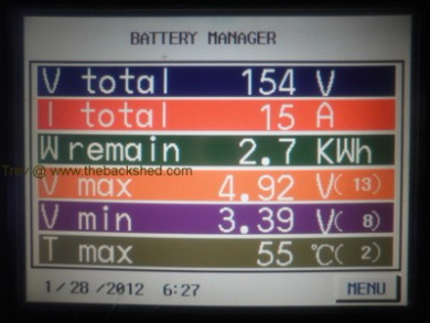

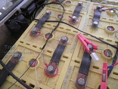

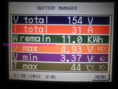

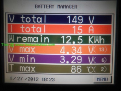

Then the next day I run the charger for a little while. Pictures are charging at 15A and 31A. You can see it doesn't need much current to give the voltage rise.
I let it charge with both chargers (31A) and near the end of charge the voltage rises quite high. (Originally I had the chargers set to 167v, but currently is set to 156v). 1 charger is set slightly lower voltage to the other and so 3A still coming from the 2nd charger. I disconnected the 2nd charger to show 15A.
I switched off the charger and then switched it back on. See cell 13.
Seperated battery block, shifted cell 13 to the end and then put back together. Clamps hold it together to get the srews back in the stainless stell bands. Back in the Hilux, cell 13 now is cell 45. It just takes up space. It is not connected in the series string. I had to put it at the end so the Battery Monitoring Screen still reads corectly.
I still have been driving my usual round trip of 75km with some capacity spare. The loss of one cell is not noticeable.
