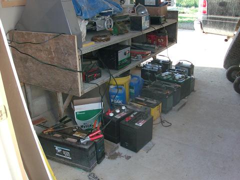

Strange things these lead acid batteries, seem to have a personality different form each other. I may have brought back one of the two bulldozer batteries from extinction, and the second one is showing some vavorable response.
Here is a picture of the batteries infront of one of my work benches. This is'nt all of them, I still have some in equipment yet, most of the batteries in the picture are old ones, not able to be used any more. The desulphinator is bringing them back to life again. I'm gaining knowledge and faith in restoreing old batteries to usefulness.
VK4AYQ, and Yahoo2, thanks for the advice and tips.
