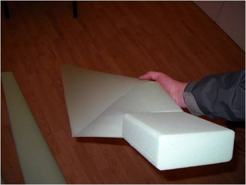

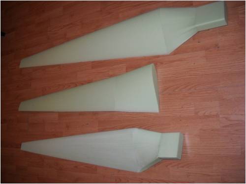

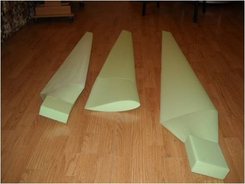

  Xmaswiz said  Have you considered selling the plans, and instructions as a DIY kit?
Very interesting idea!
If I will have requests, I can sell them as a DIY kit.
Now I am developing two standard projects :50x25x12 magnets with 2.80m diameter blades and 60x30x15 with 3.60m blades.
Waiting for clients!

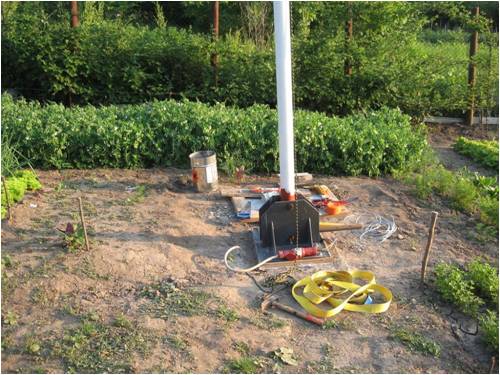

First of all, I have to test the blades even up to the breaking point. This must be done in order to have some technical characteristics.
I don't know what will be the shipping costs.
Now, I must add an extra 6m steel pipe to have a 12m tower.
Any ideas for the lifting procedure?
Keep in touch.

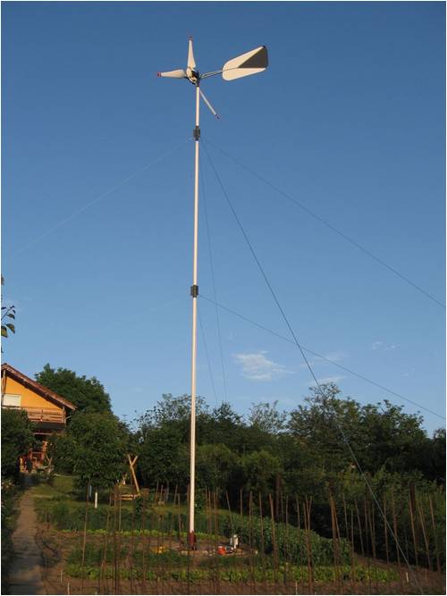

Posted: 11:22am 30 May 2011
It's up.
Now I have a real wind generator!!
Posted: 11:25am 30 May 2011
Nice
fillm
Joined: 10/02/2007
Posts: 730
Posted: 11:44am 30 May 2011
Definatly do have a real nice Wind Generator , Nice Tower & nice Vege Garden.
Keep us posted with the performance!
WELL DONE

Posted: 08:28pm 30 May 2011
Congratulations, super professional work
SpitsFire
IPSA SCIENTIA POTESTAS EST (bacone)
JimBo911
Joined: 26/03/2009
Posts: 262
Posted: 11:55am 31 May 2011
Feels nice to have her up and flying.
May the wind gods be with you!
