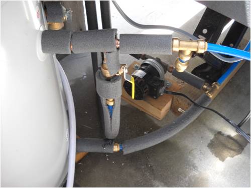

No project is ever complete without a few little "bugs" and this one is no different.
Last evening, as I took my FREE solar shower, I noticed the water was not 110* as measured at the tank, but was, in fact, several degrees cooler; 103*F to be sure.
What is happening here is what a plumber calls "cold-water dilution" and it's caused by cold water being introduced into the hot system as heated water is drawn off the receiver (tank). I studied my set-up and saw immediately the problem. When I built this, in my head I "calculated" (read that guessed) the added resistance of the pump impeller and check valve would be enough to resist cold flow through the solar panel when the pump is off and the panel was not gathering heat.
I was wrong. Not the first time ever, but maybe the first time today! Anyway, I decided to put a manual valve in the output line between the panel (and ultimately the cold-water source for the panel) to prevent cold water from diluting my precious hot water as it leaves the receiver and heads for my backside as I stand waiting in the shower.
Here's a picture you can compare to previous shots to see what I did:
The valve has a little yellow vertical handle. Doing this will ultimately mean I'll be making water too hot to shower in directly, so I'll have to mix cold against it, which is the "normal" way a shower works. My hope is that this will help someone else build their own solar water heater. No sense reinventing the wheel, eh? (Although I appear to be quite adept at that!).
In case anyone's wondering what that "T" fitting is doing hanging in the air, it's there simply because I ran out of couplings and "improvised". Rather than run out and buy a coupling, I had a tee and a cap, so I just cheated!

Posted: 10:20pm 24 May 2011
MacGyer,
Is that "Pec's I'm looking at in the picture? "the blue lines", and the copper/brass fittings and valves, is that because of the potiental of high temperatures and so you could'nt or did'nt want to use "CPVC"?
I have a water "prewarmer" now, that warms cold well water to ambient temperature before going to the hot water heater. This acts like a air cooler in the summer if we're using alot of hot water. I get some condensation on the copper tubes.
Great project! I'm about to stick another "iron in the fire". Is it really that simple, and/or would a storage tank painted black be as efficient?

Mac46
As for the pipe, yes, it is Pex. The reason I used it is I had to make a six-inch repair in a line on my coach and the supply house I use had it in 100-foot rolls only, so I had to buy an entire roll. With it just sitting around and already paid for ($35) I decided to use it. The "SharkBite" fittings are about $8 or so each, but you'd have to pay someone to help you mess up with them. All you do is line up the pipe and fitting and shove them together and it's a done deal.
Only in America! Larry the cable guy would be so proud.
As for a cistern exposed to sunlght and painted black, I suppose it would do the same thing as a panel, but the fact that a tank whose side was the same square footage as a solar panel would likely hold 5,000 gallons and if it weren't well insulated on all remaining exposed sides, it'd never even get warm. My little contraption swaps a trickle of water whose total volume is only 20 gallons and it takes all day to raise the temp from an ambient of 65*F to nearly double that come evening.
I think if you want a solar-powered domestic water heater, you'd better build just that. Just copy what I've posted here and you can build the panel for under $100. Connect it to any existing insulated water heater and you'll have free hot water forever. You may even be able to scrounge up an existing used panel, but be sure to pressure test it before installing it, because if it were ever to have frozen, it'll likely have leaks. Also, if you build your own, make sure you put a hose bib openable to air both at the top of the panel as well as at the bottom so you can drain it come a freeze.
I look forward to seeing your solar water heater post!

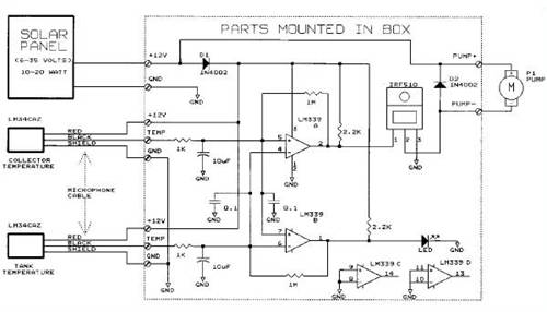

off topic a bit Mac but i found this litle cct a while back ....
its a simple differential pump controller...might be some use to someone
its not to hard to build on vero board ...
this should really be in electronics mac ...but seems better tied in here

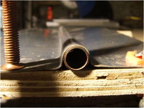

Hi all
I like the idea of wraping the aluminium sheet around the copper pipe for better heat transfer.
Mac this may not have much to do with your project as it is not thermo-siphoning but an idea i have for better circulation through the collector is to have it set up like a water tube boiler.
As you can see the tubes that collect the heat are not horizontal as i see on most solar collectors, Having them angled should increase the water circulation, this could be done by angling the copper pipes in the collector or angling the collector itself.

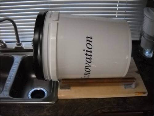

Anyway, here are some pics:

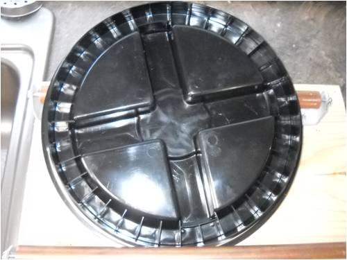

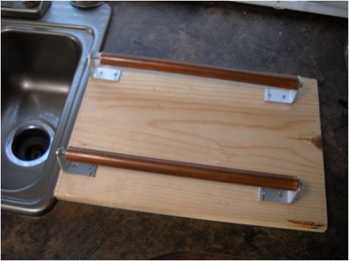

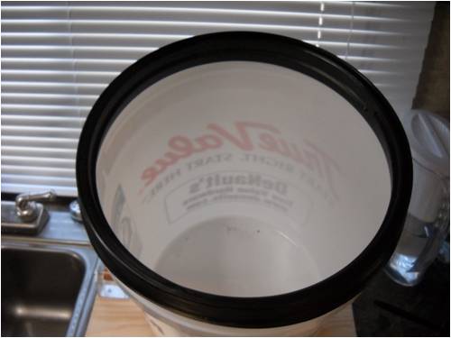

This is the whole thing mounted on a set of 'tapered' rollers I manufactured
out of copper pipe and some Delrin (plastic) bushings I made on the lathe.
These are the two rollers mounted onto a board. They are angled ever
so slightly so as to match the bucket's taper.
This is the opened bucket end with half the Gamma lid jammed on it.
This is the screw-out portion of the lid with the O-ring in its edge.
I haven't used it yet, but as soon as I install the little paddle inside the bucket, I'll wash a shirt or something just to try it out.
Never a dull moment around here!

The results from your collector are very encouraging. Yesterday I cleared of my work bench which took most of the day and dosnt happen very often.
