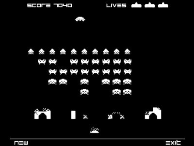

Just for fun, threw this together this morning. Space Invader animation, with two of the alien characters. Very basic, but proves the Maximite has more than enough speed for the full game if written in MMBasic.
10 FONT UNLOAD #4
20 CLS
30 FONT LOAD "SPACE.FNT" AS #4
40 FONT #4
50 X1=1:X2=50:XStep=2
60 FOR Y=1 TO 200 STEP 5
70 FOR X=X1 TO X2 STEP XStep
80 LOCATE X,Y : PRINT "010101010"
90 LOCATE X,Y+20 : PRINT "030303030";
100 PAUSE 100
110 LOCATE X+(XStep/2),Y : PRINT "020202020"
120 LOCATE X+(XStep/2),Y+20 : PRINT "040404040";
130 PAUSE 100
140 NEXT x
150 IF X1=1 THEN
160 X1=50 : X2=1 : XStep=-2
170 ELSE
180 X1=1 : X2=50 : XStep=2
190 ENDIF
200 CLS
210 NEXT Y
220 END

  Gizmo said   Just for fun, threw this together this morning. Space Invader animation, with two of the alien characters. Very basic, but proves the Maximite has more than enough speed for the full game if written in MMBasic.Glenn
All good. Certainly programmable characters makes this possible, something I've been calling for since day 1.
Now do it for 55 invaders (that's how many there in Space Invaders), make them fire lasers, explode, move a laser base that also fire, barriers that break down, sound effects and scoring and your done!
Our simple game of Space Invaders for the Maximite!
