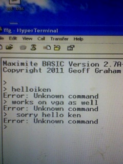

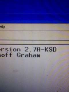

sparkey
Joined: 15/06/2011
Posts: 819
Posted: 03:14am 05 Nov 2011
works as a firm up grade and on vga this is a hy -term pic i only have a camerea in my phone ...///...
just fired up the editor "loks good" houston i think were good to go on those numbers "ken"

sparkey
Joined: 15/06/2011
Posts: 819
Posted: 03:27am 05 Nov 2011
editor does not run in hyper term but runs in vga ...regards ..///...//
