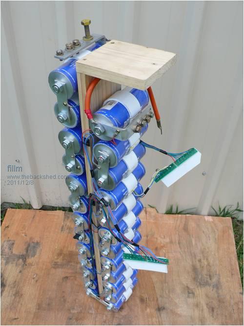

Below is an Ultra Capacitor bank I have fitted to my system mainly because of the High current that is produced buy the wind generators during gusts ( up to 4kW or 80A @ 54V+) and the solar bursts from cloud edge effect ( 45A ) trying to be absorbed by a 225A/Hr Deep cycle battey bank .
There are 25 x 3000F 2.7V Ultra caps which give me a total of 120F @ 67.5V . As my system works between 52V to 64V which the 2 x 1200W grid inverters work at , or I should say the 52V is the disconect V and the 64V is the Regulated Upper voltage set buy the dump loads and Solar Regulation, that then determines the working voltage capacity of the Ultra Cap bank .
So using the caculation ( 1/2 cv^2) to work out what the benifit of these will do to my system is ( .5 x 120 x 64 x 64 = 245760J )-( .5 x 120 x 52 x 52 = 162240J )= 83520J , / 10 = 8300W for 10sec or . /30 = 2784W for 30sec is the storage that the capacitors can absorb on top of the Battery storage. This isn't much when you have large amounts of power being delivered and the inverters do not respond as quickly but fitting the ultra Caps for this purpose is what they are designed for .
By adding more capaciors to this bank will reduce the working storage capacitance but increase the safety margin for no benifit.
This is my Ultra Cap Bank " 25 x 3000 Farad 2.7V " set up and each capacitor electricially isolated from each other as the case is also the Neg terminal , the balancers are fitted .

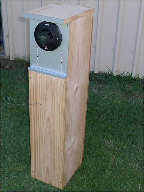

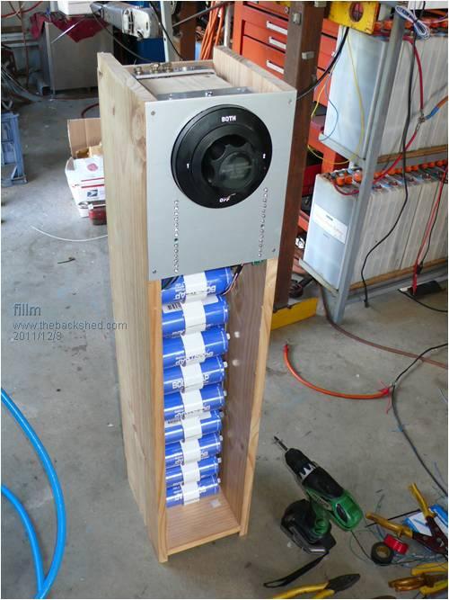

I fitted these into a purpose built timber cabnet , having them laying arround fully charged with exposed terminals is not a good idea , the power stored in these is lethal.
The finished enclosure .
The bank in place with my existing system , I have set up the 3 way switch to be able to isolate either the batteries or Ultracaps or run on both . The leds started to light up at 43V when charging the Bank and due to some internal leakage a couple are dim compared to the others .

Nice set up and construction, it is a shame these caps are so expensive. Just a thought are they separated from the battery on the initial charge cycle? It seems to me that they would load the mill excessively until charged.

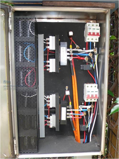

I opened the controller and lucky I did I found that I need to rewire some parts of the controller using a heavier wire and connecter, some of the connection's showed signs of overheating and replace some power resistor's that are discolored from overheating. I have to investigate and find out why this happen. I read the markings on the diode's and I am using a zener 1N3718 these are old stock unit's and my data sheet list them as 2.2 zener's GPD#3 general purpose diode they were laying around here for year's, leftover's from the old days still have a few more in the bin mixed with some 1N3712's. I checked the voltages in the 1st 6x6 grid (6 row's of 6 ultra-caps) as well as the other grid's and all voltage's in the grid's of the system ultra-cap's are reading correctly.

You are right , there is no way in heaven or hell these balancers can carry high current to balance, they are passive balancers and basicly bleed of a small amount current all the time to balance the voltage , I gave a link to the Ebay item on the previous page which explaines the workings .

Tinker;Bob,
I have my bank in paralell with a 48V /225Ahr Batt bank , and connected with a slightly higher resistance of 5m of 6mm cable , all other loads and inputs are connected to the U/Cap +&- bus bars .
It only took slightly over a week for 3 caps to become quite out of balance with one at 1v low as previously stated .
The problem that could arise is as caps go out of balance then the others of course are compensating at higher volts which compounds with cycling, if a sudden rise of power is absorbed then it could push the higher Ucaps voltage past their recomended high limit causing damage in a severly out of balance situation .
In lower voltage banks that are closely matched to the upper voltage limit would be more at risk but adding extra caps to increase the safety margin then reduces capacity.
Because of the LEDs different brightness levels I would not have had a visual check to see the problem I had, and I still have not fully investigated whether it is in the balancers or internal leakage.
Tinker , I like your idea with the rotary switch to be able to easily check voltages which would also make it easy to manual equalize if needed, but I would think the need for reliable auto balancing is a must have.
