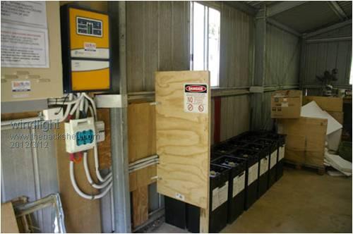

The installer wanted to place the batteries (lead acid) under the inverter and his man was quite indignant when I said it was not acceptable, he claimed they had done 50+ installs like this, yea OK, they had to move them, all equipment was within the 3x2.7M room.
Over here everything is in the 6x9M garage with a plywood separator between batteries and inverter, and an open window above the batteries, rain is straight down here , mostly.

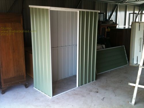

I bought a cheap garden shed for $185, its about 2m high, 1.8m wide and .8m deep. Lots of ventilation holes around the roof, it's as air tight as a open window. Here's a pic of it nearly assembled, I still need to fit the door. Mongrel of a thing to put together, but what do you expect for the price.
I'll mount it next to the workshop shed on some timbers ( I'll make a concrete slab for it later when I'm sure on its final location ), and run the battery leads through the back of the garden shed into the workshop shed to the inverter.

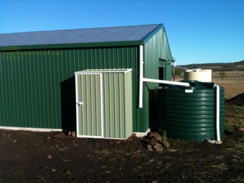

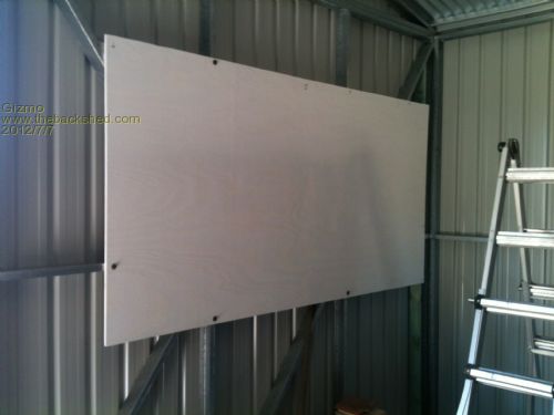

More progress. Positioned the "Battery Room" next to the workshop.
Painted and mounted a 2400*1200 sheet or 12mm plywood onto the workshop wall. This is where I'll mount the inverter, power board, controller, etc, etc.

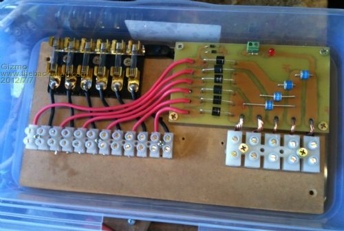

This is the solar panel lead in box.
It has the fusing, gas arrestors and blocking diodes. Yes, its built into a plastic lunch box. It also has a couple of extra diodes to monitor the solar panel voltage independant of the charge controller, and a LED just to let me know I'm getting power to this point. The solar panels are connected up into 3 groups, the first group has one panel pair, the 2nd has 2 panel pairs, and the third has 3 panel pairs. These groups can be switched ( in the charge controller, more on that in a later post ) in combinations from 1 to 6 panel pairs. The idea is the charge controller can match the solar panel input to the inverter load, by switching in and out different combinations of panels. This is to avoid cycling the batteries too much once they are fully charged, not a big issue, but something I wanted to play around with.
The two little diodes are to provide a night time / low light sensor input to the charge controller, so it can tell if the panel voltage has dropped below battery voltage, and go into night mode. In night mode it switches off the control relays, saving a few watts. It also means I didn't really need the blocking diodes, since the controller will open circuit the panels at night anyway. But they still offer protection if part of the panel is shadded.

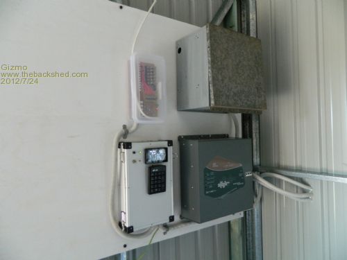

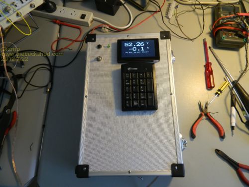

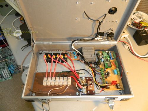

Pretty much finished the solar controller. Its based on a Maximite computer, and build ito a small tool case. The screen can display setup, basic view ( shown ) and detailed view, where it displays watts and watt hours, peaks, relay state, etc etc etc, and a cool graph of the last 2 minutes/hours/days of battery current. The display is a little composite reversing monitor, and the keyboard is a numeric type with PS2.

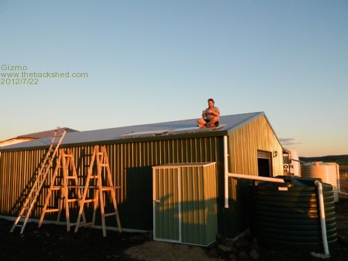

Mounted a couple of the solar panels on the roof of the shed. These are just get some power into the batteries and keep the system ticking over. I'll mount the other 10 panels in a couple of weeks. Pic of my brother giving me a hand.

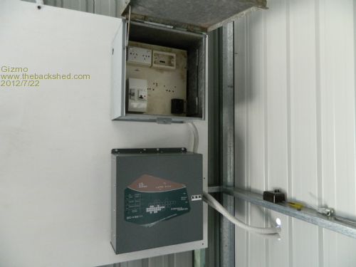

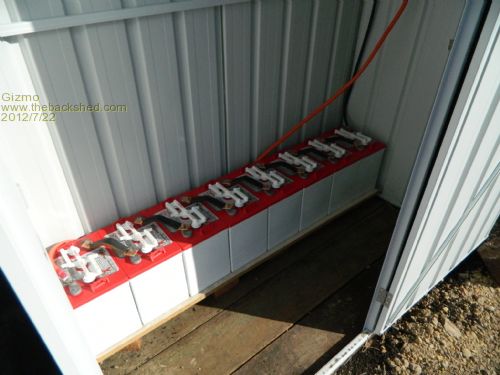

The batteries are connected up. I used 19mm copper pipe flattened out with some push bike inner tube as a insulator.
Mounted the inverter and power box, and gave it a test, all working fine.
Getting there.

It's using a CGMMSTICK Trev, its like a mini PC, a Maximite clone. It measures battery voltage, panel voltage ( so it can shut down at night ), current into the battery from the panel, and current from battery to inverter. That way it can track watt hours in and out of the battery bank, making it easier to keep track of the state of charge. It logs the data to a SD card. It drives 3 relays to switch the panels in and out as needed. Originally I was using MOSFETS, but was having problems with leakage so changed to relays as I needed to get the controller into service as soon as possible. Once I've settled in I'll expand on its software to add more functions, like remote display, battery equalisation, etc.

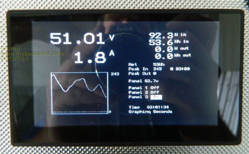

Another little update. Installed the controller and got the system going.
This is a photo of the controller screen.
The graph shows the rise and fall of watts as clouds passed overhead.
With the two panels installed, the system will have enough capacity for my power tools, lights, etc while I finish the house and start moving in.

Cant remember the make off the top of my head, the invoice is buried in paperwork, but they are a deep cycle 230Ah 6v battery. 8 in series to give 48 volts.

Its a 4.3' TFT LCD reverse Rear View Car Video Monitor, model CZ7. Search eBay for "CZ7 Monitor" and you'll find heaps for under $25, brand new. It accepts PAL and NTSC. In PAL mode or the Maximites NTSC mode, most of the screen area is used, but there is a blank border around the edge. Not really a problem, as you can see in my photo. The DuinoMite running version 2.7 had a NTSC mode thats fills the screen much better, with a higher resolution then the Maximites NTSC mode.
Current draw it tiny! About 100mA from memory.
