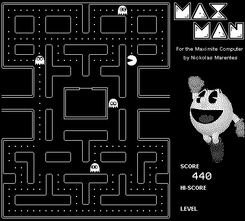

Been a bit busy lately and haven't done much to my Pacman so I thought I'll just type up a bit of an update on where it's at.
First thing, a name change. I've renamed the game from Pacman to MaxMan.
Code wise, I have the ghosts chasing you in a semi-intelligent fashion. Still some work to do here. Many instances where the ghosts don't make an obvious move, like if they are an inch away from you and they decide to take a turn at the next corridor, sending themselves away from you.
The Power Pills are half operating. They flash and register when they are eaten but the code to put the ghosts into a "run-away" mode is yet to be done.
All 4 ghosts "launch" from their Ghost pen in the centre of the maze and you can get "eaten" by them.
Speedwise, it's good. It looks very much like the original game.
The biggest challenge is finding free time to keep working on it but little by little, it gets done.
It's all keyboard driven so far but eventually, I'll need to get me one of these Wii Nunchuck adapters. Can anyone tell me what the code would be to read the 4 directions from the Nunchuck. I can add the code in so it will have dual controllability.
I haven't even looked at sound yet. I don't know what the speed penalty (if any) would be when that goes in.

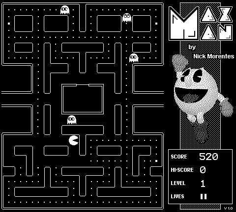

Posted: 07:58pm 05 Mar 2012
Getting close now. Can play a complete game from start to finish.
Still not happy with the ghost's intelligence and what is causing the biggest problem is that I have reached the speed capacity of MMBASIC where I feel the game starts to become slower than I would like.
I have taken the scissors to the code and tried to cut out as much as possible to the main game loop part of the code.
I have also found that the insertion of even a space in a line of code takes up cpu cycles as the BASIC interpreter has to skip the space in search of the next piece of code.
As a result, REM lines are removed to avoid losing cycles as it skips the REM. Heavy use of multi statement lines provides a slight improvement and generally looking for every optimisation I can.
Game speed is very important and so the coding has become a game in itself of sacrifices and optimizations.
