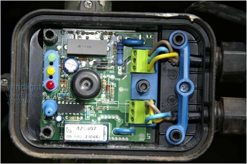

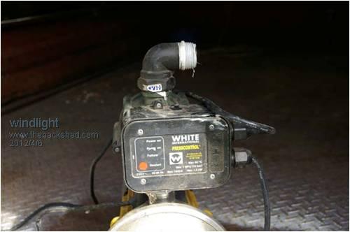

Posted: 06:04am 06 Apr 2012
Pics of presscontrol, in the pic of the control board the capacitor is the grey oblong upper central and the dropping resistor is the blue one mounted vertical to the right of the capacitor.
If either or both those are burnt it is usually high voltage, if you have any chance of warranty don't remove the three speedy nuts to reveal the control board, they frequently break of the plastic stud.

Our pump is exactly the same presscontrol as the one above. I haven't taken the nuts off to check the resistor or capacitor as yet but I rang my sister and she doubts we would get any warranty as the last one was melted so I'll give it a go

If you are not going for warranty then take the three speed nuts off the circuit board cover and as before, if that capacitor and resistor are chard then it is an over voltage problem. With the pump plugged into the generator the control board is still receiving power even when the pump motor is off. Was the generator powering any other load when the pump failed or just the pump?

Looks like the resistor was never soldered in properly. I've soldered it back and it's all go for the moment but i'm not game to use it

nope. just the resistor was not connected. I doubt it was ever through the board as it should have been
