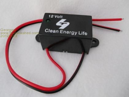

I found US made desulphator, It says about application, that it is good for AGM battery too:
RV ATV Jet Ski Boat Sailboat Deep Cycle Battery Desulfator Optimizer Desulphator
" This is one(1) 12 volts lead acid battery desulfator to recondition a lead acid or sealed dry cell AGM battery "
Does it look like something I should get, or I need something else?

I am not versed with one like this...so no openion other than you get what you pay for. I would suggest that if you plan on restoreing batteries that you consider a larger unit.

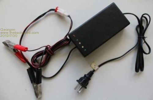

Found anothere desulphator, on paper it sounds OK
Link will be dead at some stage, so I made copy of details.
[quote]
12V Battery Desulfator & Charger Std Lead Acid, GEL, AGM, Deep Cycle, Calcium
OPERATION:
On connecting the battery correctly the green light will illuminate. If the red light is illuminated it indicates an incorrect reverse polarity connection and the charger will not initiate until the battery is connected correctly.
Once correctly connected the charger will initiate charge (whatever the battery voltage is, 0-12V) and attempt to charge the battery at 2A. Even if 0V (dead battery) the charger will attempt charging until the battery achieves 14.4V then stage 1 terminates.
At this point the blue light then indicates the second stage is initiated and when the battery drops to 13.1V both charging and pulsing continues.
In stage 2 the charger monitors the battery and the charger will re initiate at 0.5A and again charge the battery until the battery voltage returns to 14.4V where it will terminate stage 2.
Next the yellow/white light indicates the third stage is initiated. Pulsing continues and again the charger monitors the battery and as battery voltage drops to 13.1V the charger will re initiate and charge at 0.25A until 13.6V.
The charger will then terminate stage 3 and enter float mode (13.1-13.4V) while continuing with the pulse desulfation function. At this time the green light indicates float mode operation.
In this final maintenance-recovery mode the charger will continue pulsing the sulphates while cycling charge between 13.1V-13.6V. By this point in the rejuvenation process a viable battery will recover (if possible) to its achievable voltage and A/hr capacity.
[/quote]

That sounds just like the desulphinator that I have. Not knowing for sure, it sounds like you have found a good one. This is one item that you don't want to be cutting cost on as it will be doing you alot of work and saveing you $$$ in the future, also because some of the cheeper models are prone to failure and just a waste of money.
I have been happy with mine so far.

Looks that copy of picture loaded this time.
Thank you Mat46 for post.
Just find it interesting, that Gel and Glass Mat batteries can be treated with desulphator too.
Not sure what Calcium stands for.

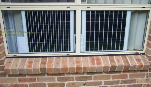

Posted: 04:00pm 10 Mar 2013
Few things changed since last post.
I am kind of alone with my pursuit of inexpensive fun power.
(Would find it difficult to be able to have 100Ah battery or larger)
Ended up with 2 off 40W panels in lower part of my computer room window and it has to be enough for the time being.
Why? Somebody might ask
Well started to chase some proper roof brackets and with cables it would cost 3 or 4 times as much as both solar panels.
As they are now, they are ‘safe’ from any weather until window is smashed by hail storm or hurricane strength wind.
My AGM battery got checked few times and in the end I added 4 cm cube extra to each cell, so I don’t worry all the time if it is dry already or not.
Battery behaviour did not seem to change much and since battery is quite old and small in reality it works as an absorber.
Most work is done during sun hours.
Lost rechargeable screw driver as gear box got jammed and after pulling it apart there is no way I’ll put it back together not to mention that battery is dead too.
Added Ioniser that is connected when there is way too much electricity generated and shredder that is used from time to time.
Pieces of cardboard placed between window glass and panels fine-tunes power output.
(At the time of picture I experimented with envelopes as shade creation)
When I am not home panels are disconnected as well as are disconnected at night, so morning Sun is not going to boil the AGM battery.
