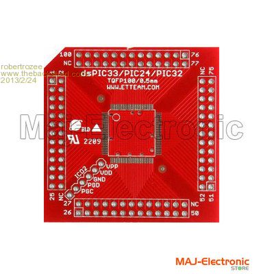

Posted: 04:57pm 23 Feb 2013
  bigmik said
I feel the two biggest flaws with a user constructable MM is SMDs (admittedly only one in the latest CMM) and the extreme price markup for the kit.
agreed 100%, although there is a fairly simple solution to this.
someone provide one of these (us$2.70 delivered, on ebay):
populated with the PIC32 and all the SMD parts on the reverse, and pre-programmed with either MMBASIC or the required bootloader. this should be thin enough to send anywhere in the world in a $2 envelope. i suggest this particular carrier PCB as it seems quite generic and readily available in quantity.

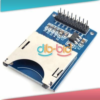

a parts kit could then consist of one of these (au$1.40 on ebay):

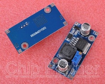

and one of these (5v buck regulator, us$1.80 on ebay):
along with a single-sided PCB to connect it all together and other odd components. the carrier PCB could be attached with fixed pins, or a suitable socket made up. for the keyboard use a USB socket, as this is what most dual-interface keyboards seem to have now, while the VGA socket could be attached with flying leads.
everything would then be of a suitable scale for the average constructor to solder together. the goal would not be small size, but easy construction. if the user blows up the PIC, then it is easily and cheap to replace just the carrier PCB.
