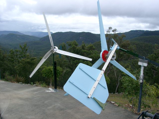

Thanks for the positive comments - yes, as suggested by Gill, we'll increase the tail size significantly. The blades were a prototype set cut from a single length of 150 mm UPVC and I'll accept the advice that they need to have a bigger area.
The clutch plate because it was found unidentified at a wreckers and just happened to fit. I think it is Hyundai but I.m really not sure. Anyhow, it is not an ideal solution because you can't drill the spring steel and that is the reason the blades are aligned the way they are - the bolts had to work with existing holes. The next one will use a splined pulley wheel that can be drilled as needed for better blade alignment

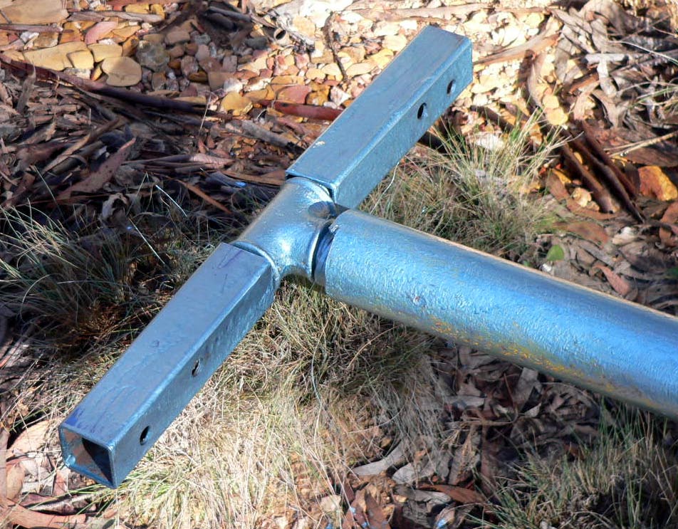

The stator has been rewired into three phase and no, I'm not planning to test it on the traier - it was stuck there just for the picture. A serious mount has been made from lengths of Acro props bolted together on a swivel base Dynabolted to a concrete pad and guyed with adjustable wire stays

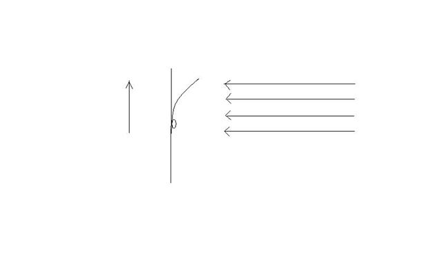

Although the lads insist the two pictures above have clockwise rotation while mine is anticlockwise, I am dumb enough not to be able to see any difference. For example, each blade pointing downwards clearly has the leading edge on the right side. This includes my unit though it may not look that way because of the light reflecting off the paint.
Assume I'm stupid, but in any case, I do not understand why the blades need to rotate in one direction or the other because it is generating AC - not DC.
If anyone can help clear this up, it would be appreciated

You could weld a larger steel disc to the clutch plate and then attach your blades to the disc avoiding the springs etc, to me it looks like your machine uses a clockwise rotating prop as the wind will push on the root of your blades this way and yes it doesn't matter which way the alternator spins output will be the same.
look from your tip towards the hub, imagine the wind hitting it.

Thanks Storm - exactly what I thought would occur. Welding a larger plate to the clutch assembly is a good idea - will probably do just that to modify this prototype - and increase the blade width at the same time.
For the next unit though, I shall not use a clutch plate because of the ripoff prices charged by wreckers or the problem of having to sort through a mountain of parts just to find the right spline. Pulley drive wheels are much easier to find cheaply, the centres can easily be reamed out and most have a flange that takes a lock screw onto the FP shaft. Going to say, a 250 mm diameter also makes it easier to secure larger blades
