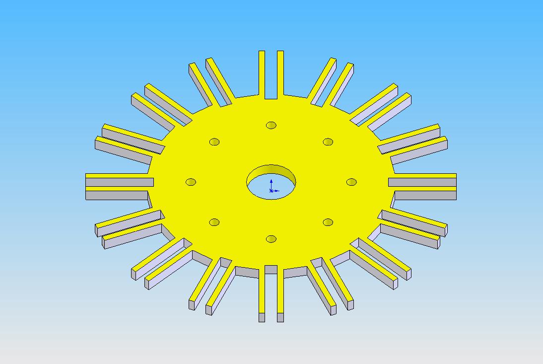

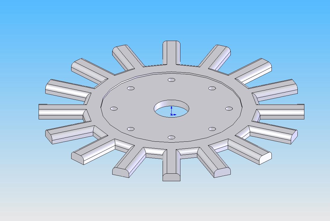

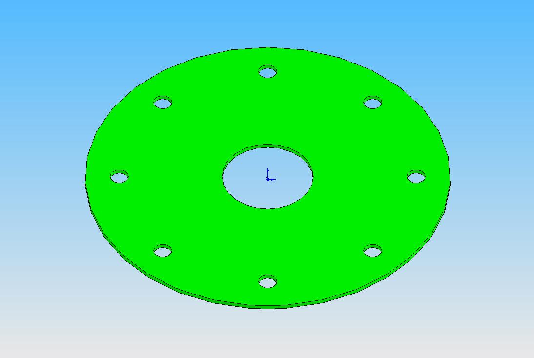

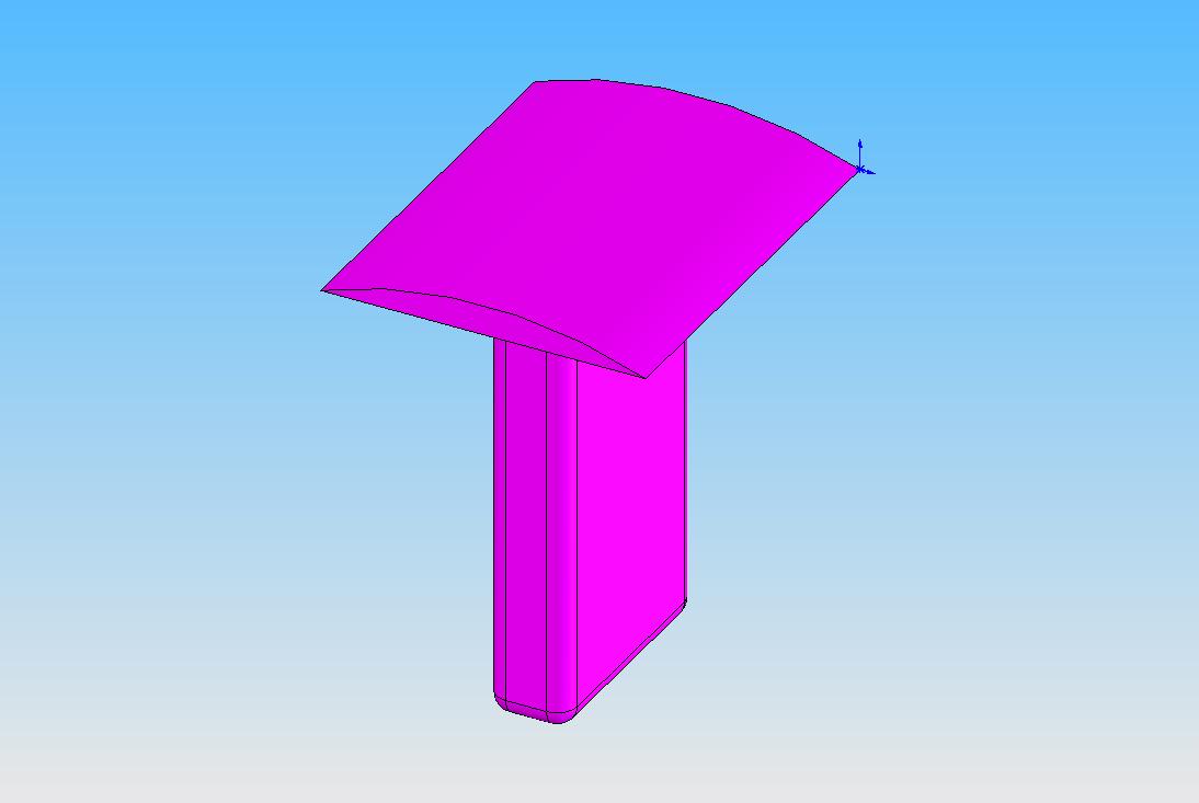

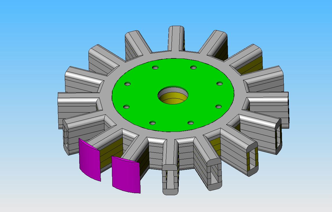

I have finally been able to put thoughts on this idea into an image. The idea is to have pieces routed out in a material that I use here at work (PVC sheeting) it is light strong and easy to work with cost is a little on the high side but would be cheaper than using aluminum. For strength I have included aluminum plate disk (green). And the idea of using the powdered iron was an excellent idea except if you made the whole stator out of it the stator would be very fragile. So I propose a mushroom (purple) shaped piece of the iron powder.
The parts would be possibly glued and bolted together.
Anyway here are the pictures of the model I did in solidworks.
Anyway the other part of the idea is to have a metal drum spun up by some metal spinners in say aluminum or in gal. doing it this way is extremely cost effective they would probably work out at around the $20 mark maybe cheaper.
Please everyone comment on the ideas as this is the best way to progress.
(please note I have not included things like bearings and carriers as I'm not sure what would be the best solution as well as the main shaft)

Posted: 10:08am 27 Jun 2007
Great design, also can be made from wood and sealed. We hope the copper is close enough. I think is time the others join us .
Elvish name: Mablung Miriel

Hi
good to see you working on design rotorhead. I am very interested in use iron powder my main application is in the area of hydro at high pressure so always need to slow down FP to get eff. The concept I feel that would keep things simple would be to get building blocks like leggo made and build up stators by stacking together and gluing (with resin impregnated with powder ).
at present i am brushing up on magnetic circuit theory to see if we can replace steel core. Iron powder does not carry fields as well as silicon steel we will need to enlarge pole piece and shortern no problem there at present instead of reconnectig i rewind to replace a 100SP FP u only need 6 turns per pole looks wrong but works like dream so no need for space between poles.
