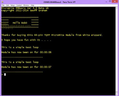

Just about to start up one of White Wizard's 44 pin circuits and I can't find what size Tera Term window to use. Help please.
Posted: 01:29am 15 Apr 2014
Hi Bob,
I use 80x36 if thats any help!
Give it a go and let us know how you get on . . .
Posted: 01:31am 15 Apr 2014
. . . and don't forget to set baud to 38,400

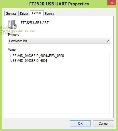

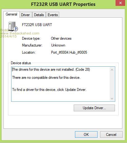

Don, not quite sure I follow you but I did some checking and my alternate system (win 8.1 64 bit) automatically installed FTDI driver version 2.10.0.0. When I tried updating with the latest driver from FTDI I was told by Windows that I have the latest.
My main system, as I said, would not install a driver even when I tried to push it down its throat. See the pic below.
Windows identifies the chip OK (I think, anyone confirm?).

  BobD said   Don, not quite sure I follow you but I did some checking and my alternate system (win 8.1 64 bit) automatically installed FTDI driver version 2.10.0.0. When I tried updating with the latest driver from FTDI I was told by Windows that I have the latest.
On my second entry, that is: USB serial Converter properties, I get precisely the same info as you.
Are you trying to let the software find the file(s), or are you forcing it with an exe file?
If you haven't tried the exe file, I would try the latest 30 version first.

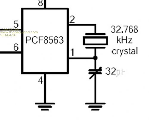

don't know if anyone else has noticed this, but in the manual several of the diagrams have slightly 'mangled' pieces of text. for example:
the "pF" is printed in what looks like a 'hollow' font. i suspect this may be due to the text being not-quite black, and not converting to monochrome correctly when assembling the pdf. i'm using adobe acrobat reader 11.0.5 as my pdf viewer, 1024x600 screen attached to a netbook running XP. it is not impossible that this is a rendering problem only visible on certain setups.
see the following diagrams for other occurrences:
pg 58, "or similar",
pg 62, "Outputs"
pg 22, "2" (pin number on chip)
pg 19, "V" (of +3.3V)
i'd also suggest pushing the manual out to 67 pages (or, in general, any odd number of pages). this means that when printed out double-sided and stapled together like a book, the last sheet is not left with writing exposed (to get dirty) on the back. it just makes for a nice touch.

Rob, I gave up using Adobe Reader a few years back because it seemed to be always a target of scammers and Adobe were always trying to push crapware with their updates (nothing has changed there, try updating Flash). Adobe just generally annoyed the hell out of me. If things are different now let me know please.
I may have just discovered a plus for Adobe Reader. My PDF reader shows nothing at all for those items that you note. I don't mind the problems on P19 or 22 but missing chunks of text is a bit off and I can't even detect where the text would be missing on pages 58 & 62.
I just opened the manual in Word and it did not show these items either. Looks like we need some adjustments to the manual.
