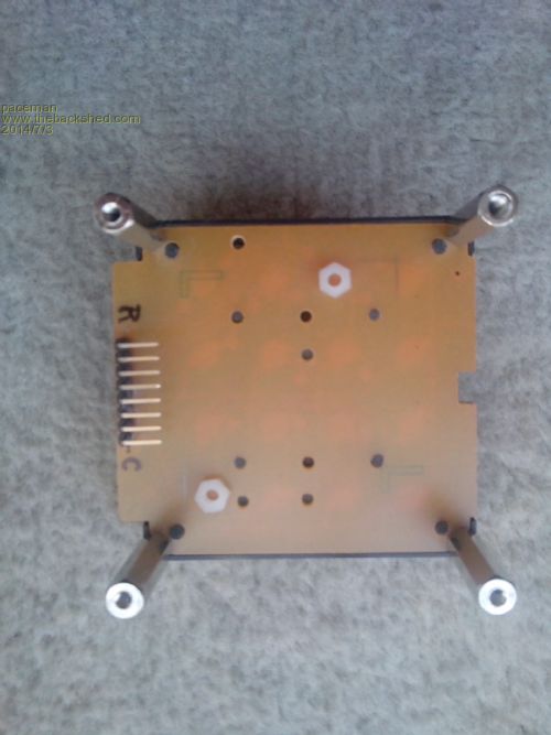

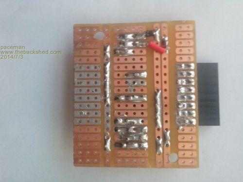

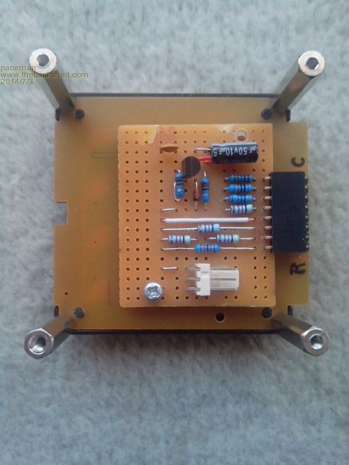

Thanks Peter, actually SMD on stripboard (or proto board) works pretty well. That controller has an 0805 10K resistor, two 1206 capacitors and the SOT23 3.3v reg on it. The spaces between the "strips" isolates each end of them nicely, and cutting a 1mm break in a strip for them also works well. The reg slotted in nicely with a separate strip for each of the three 'pins' and the live 3.3v base on the 'rail' strip - you can see it in the photo.
My program to drive it is here UV Box Timer . The final post gives the code with the PWM brightness control added.
This link 4x4 Methods has a discussion on methods for using analogue input for a keypad.
And this link 4x4 Keypad is good documentation for the original work. Since doing the board for that I've changed the ribbon cable connector method shown in the photo to a much simpler right angle pin method as in the photos below. This method is great as it's quick to do and allows you to quickly swap the board in and out to change between the analogue and parallel methods for proto-ing. It's also a solid permanent connector.
There are several other threads - search the forum with "4x4" or "4 x 4" or "keypad" etc.
