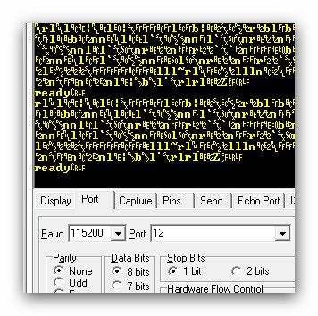

Ah at last ! Wired it up as per CONEECTIONS.jpg but left CD_PD floating. Started the nodemcu flasher then connected the CH_PD to +3v3 and the log window showed it was programming. After a little while I got the green light and now it defaults to 115200 and the AT+GMR shows

paceman
Joined: 07/10/2011
Posted: 09:19pm 10 Jun 2015
Feels good after a struggle doesn't it. If only mine had stayed that way!
I doubt floating the CH_PD pin made any difference to you though Gordon, mine's hardwired to 3.3v and it flashed OK. The GPIO0 pin being held low for flashing is the main requirement.
Is the double spacing you've shown above how it responds? If so you've probably got your terminal program set to CR/LF on Receive. That is needed for the Transmit but not the Receive.

I would suggest connecting the module and monitoring the output, each time you connect/disconnect the CH_PD to 3v3 you should see a heap of garbage in your terminal window with a ready at the bottom. If you don't then it may be that your baud rate is not set correctly. You may find that it is because the module has defaulted now to 57600 or 115200 baud. Mine had old F/W that was locked in at 9600 and the command set to change it did not exist. With the 'new' firmware you can change the baud rate but of course you have to be communicating first.

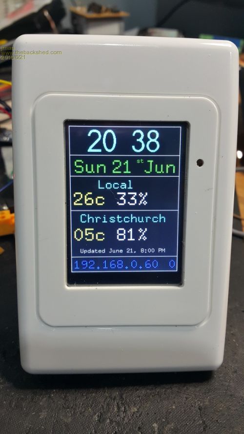

Ready to be installed in a faceplate from Bunnings

Posted: 11:23pm 20 Jun 2015
very professional looking. You have me curious about the Local and Christchurch observations. How do you get such differing readings in your area?

Posted: 11:27pm 20 Jun 2015
  BobD said   John
Bob
The Local one is in my house the other is from the Airport
So it's cold out :)

Looks pretty sharp John - Apple eat your heart out

John - this is really good stuff.
Can I make two suggestions for 'improving' your display content (please; these are NOT criticisms):
1> Make any single digit temperature a single digit with a leading space. So in your photo - the '05' will simply become ' 5'. This makes 'low' temperatures stand out more clearly on this type of gadget.
2> Make the Updated time the same format as the main time. Your main time is in 24hr format, but the updated is with a AM/PM indicator. Initially I thought the update was in the morning, and it was now well into the evening according to your clock; however, it had actually updated just over half an hour previously.
PLEASE - these are just recommendations from a 'user' point of view. I spent many years designing user-friendly systems (yes, they do exist!) and I believe I have a good eye for little details. There may well be good & valid reasons why you did what you did, but then again you may not have 'noticed' the above.
Anyway - like others have said; a really nice looking unit
