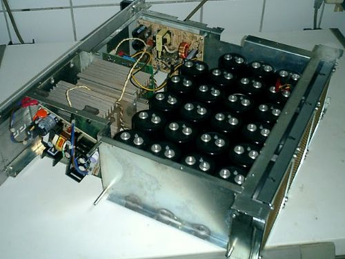

I got very lucky at the time when I wanted to build my cap-discharge spotwelder. Was contemplating it for years but never found either the capacitors or the SCRs. Then by sheer luck I found both in a matter of weeks - the SCR was free, the caps were ridiculously cheap (0,80 euro per piece; 1.20 US$). Everything else was made of junked parts.
The SCRs that I found were both mounted on a large cooling fin. One was broken, but the other one was still working. I strongly suspect it came out of a thyristor welding machine. If there are welding machine repair shops in your area, pay them a visit and ask to have a look in their garbage bin (maybe bring a 6-pack for the guys in the shop?). If they are replacing a complete thyristor module and throw out the old one, there's a good chance one or two of them are still working....

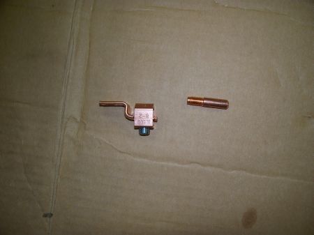

One good idea for electrode tips I found a few days ago was using MIG nozzles (on the right in this picture):
Idea came from here: http://hackaday.com/2009/06/23/how-to-build-your-own-spot-we lder/
If you drill and thread a hole in the aluminium pinchers and install those nozzles as electrodes, you'll be able to spotweld in much tighter places. Also, replacing those nozzles will be quick and easy. Last time I bought a bunch of them, they were dirt cheap too; 1E/pce or so. I can't make electrodes cheaper myself....

After procrastinating for a few years I got inspired by this thread to finally build a capacitor-discharge spotwelder. My previous spotwelder, built around a microwave transformer, wasn't a big succes, but the CD welder is !
http://www.anotherpower.com/gallery/album92
It basically consists of a large bank (1.564 F) of capacitors that gets discharged through the workpiece via a large thyristor (SCR). The sudden flow of high current heats up the joints enough to make a weld.
It was originally only intended to weld thin (0.003-0.005") nickel strips to batteries, to make and rebuild my own batterypacks for powertools. But to my surprise I find I can weld stainless steel up to a thickness of 3 mm too...
Full schematics, construction pictures, etc. can be found in the above link. Please notice that it's not entirely finished, I still need to make a decent front plate for it. But it's technically 100% functional as it is. Also, I'm at the moment building some extras to make it more userfriendly, such as handtweezer-electrodes. A footpedal (old one from a sewing machine) makes a very handy trigger (removes the need for a 3rd hand).
Next project will be another transformer-based spotwelder, but this time much more beefier.
Maybe it has given someone on this forum an idea on what to do with that box of capacitors sitting in the corner of the shop... :)
