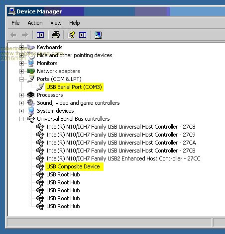

if your windows 7 does not find the correct drivers itself, you may need to provide them. the drivers are available from microchip's website as "MCP2221 Windows Driver" here:
http://ww1.microchip.com/downloads/en/DeviceDoc/MCP2221%20Windows%20Driver%202014-10-09.zip
the fact that you are seeing a "USB Composite Device" is a good sign.
as an alternative to the rather large microchip download, the two small files required (not drivers as such, but just description and signature files) are contained in the below zip file:
2016-10-01_050211_mchpcdc_2014-10-09.zip
unpack the two files, right-click on the file called mchpcdc.inf and select "Install". this should set things up so that windows can then install the device correctly. when things are working right, you should see (under XP at least) something like this:
