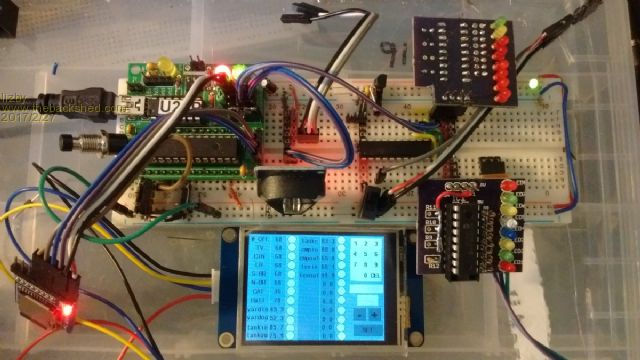

BigMic--still just playing, but I love what can be done with the MuPv3. Like this xmas tree. Thanks to White Wizzard for pointing me in this direction.
