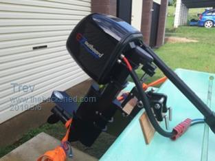

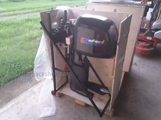

We received some new design outboards from Golden Motor.
Kerme has been sitting under the tree since we had it in the water back in February last year. It has faded a lot and was very dirty. Had to put the gernie over it and scrub it with brooms. It really looked neglected for a long time.
Fitted up a new motor.
The new motors are adjustable in leg height. Absolutely a brilliant idea. They also have heat exchanger, no sea water through the motor or controller. It takes the normal car coolant for corrosion resistance, another brilliant idea. I do like the coolant pump too, much quieter than the older design. Also for corrosion resistance, it is fitted with a zinc anode. No air through the propeller centre. The old design still had an air line where a petrol exhaust would have been, which let air through the centre. This new motor stopped the water spray up the front of the leg much better than the old design. 10kg lighter than the old design, this new outboard measured to be 40kg. The motor shaft is horizontal and runs a tooth belt to the prop shaft, much quieter running, and very smooth. Well done to Golden Motor for developing a brilliant outboard.
Some performance data
Amps Km/hr
30 9
40 10
45 11
54 12
70 13
72 15
88 17
100 18
110 19
125 20
142 21
182 23 182A was full throttle.
We lowered the leg a little bit, and achieved 24km/hr at 175A.

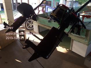

Trev
Joined: 15/07/2006
Posts: 676

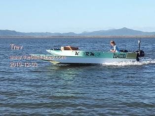

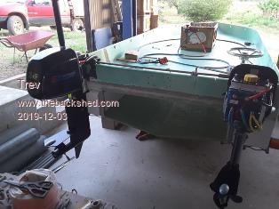

Posted: 12:51am 03 Dec 2019

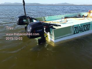

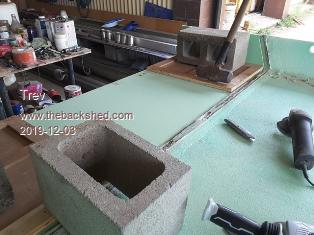

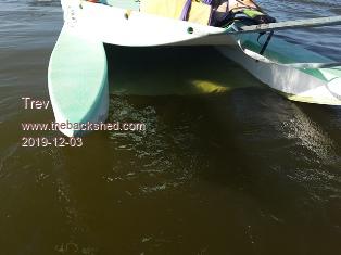

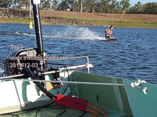

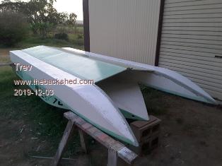

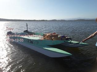

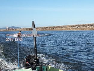

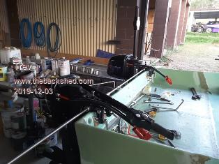

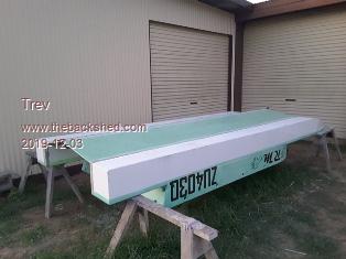

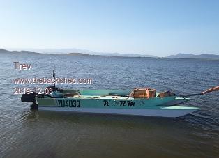

Some more changes to Kerme.
Cut out the second width pontoons. Added a V-Bottom. More planing surface and more tunnel space. A little less buoyancy though, so draft is more. Fitted 2 Golden motors.
Off to the water for testing.
It feels to skip a lot better at high speed, but the numbers don't indicate anything better. With the 2 motors, it never achieved any better speed than with one motor, but used more electricity. Pulling power is ok. Knee board was easy, and I got up on 2 ski's, but single ski could not get up.

Trev @ drivebynature.com

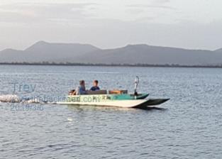

Posted: 09:55pm 11 Dec 2019

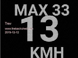

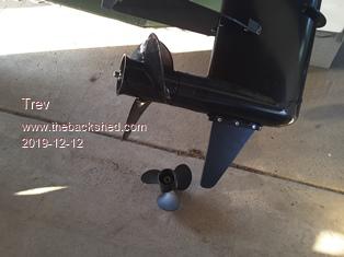

Got 2 new propellers. 9.25 x 10. Original propellers 9.25 x 7.
Headed out to the water for another test
At rest, battery voltage measured at 53.1v. This test was heading into the wind
15.6A     6km/hr
23.3A     6km/hr
40A       7km/hr
52A       9km/hr
69A       10km/hr
88A          water sprayed up in the wind, over the bow so give more throttle quickly
170A      17km/hr
176A      19km/hr
180A      21km/hr
210A      25km/hr
225A      27km/hr
273A      29km/hr
277A      30km/hr

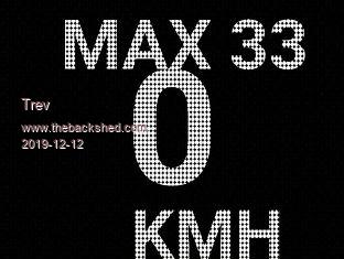

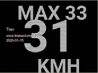

Screen shot the speedo after we stopped. Max at 33, but mostly could only achieve 30km/hr
I wanted to see what one motor could do on its own so lifted the other motor and disconnected the power cable. Flat out at 13km/hr. Bear in mind though this was with one motor on the side of the boat so not a direct push. steering turned to get boat to track straight.

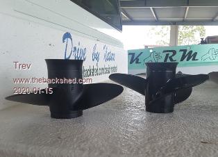

Trev
Joined: 15/07/2006
Posts: 676
Posted: 12:41am 15 Jan 2020

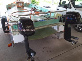

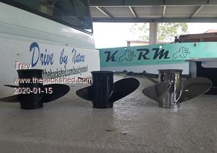

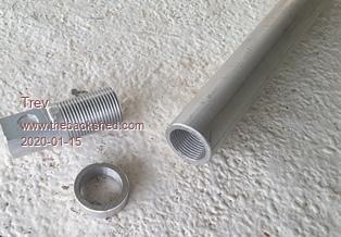

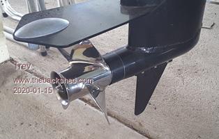

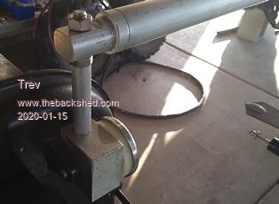

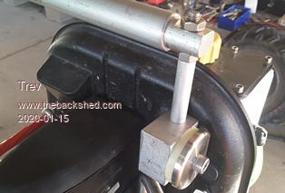

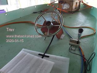

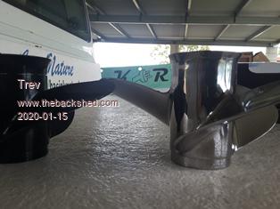

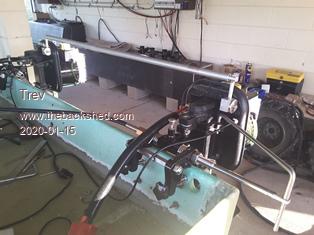

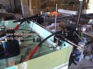

Another set of propellers. 9.5 x 13. Stainless steel. There is not a lot of visual difference between the 9.25 x 10 and the 9.5 x 13.
Made some changes to the steering setup. We now have a temporary forward control.
Numbers for the stainless steel props. Probably not what they should be. The cav plate was borderline with the smaller props. With the slightly bigger diameter stainless steel props, they cavitated a little. Achieved similar speed with less amps.
15A    6km/hr     Planing at this speed
31A    7km/hr
45A    9km/hr
50A    10km/hr
70A    11km/hr
100A   16km/hr
120A   18km/hr
160A   20km/hr
170A   25km/hr
200A   28km/hr
250A   30km/hr
256A   31km/hr     Max throttle could only get 256A
The highest speed we saw was 31km/hr, but mostly could only get 30km/hr max.

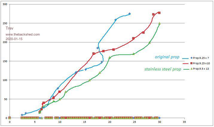

Here is a comparison of the 3 propellers
Edited 2020-01-15 10:47 by Trev

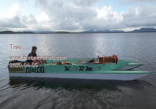

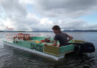

Posted: 02:38am 05 Apr 2020

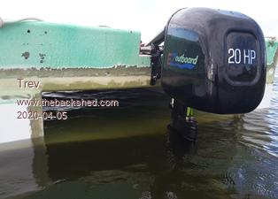

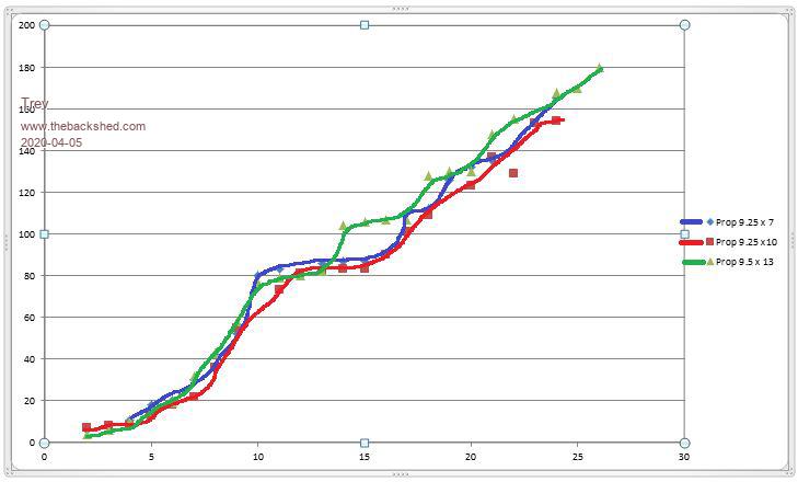

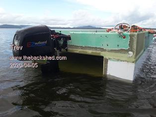

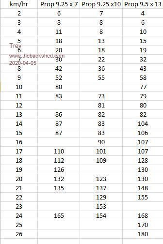

Several weeks ago we changed back to 1 motor. And went out to the dam for testing.
Had to cut the transom / motor mount down so the cavitation plate would be below the bottom of the V-Bottom. There is less boat draft at rest, but with the extra 100mm cut out of the motor mount to get is low enough, bring the motor about the same height to the water level as the 2 motors, mounted higher, but weighing down deeper draft.
I need more buoyancy, to reduce the draft.
We tested all 3 props on this single motor and boat configuration.No significant difference with the 3 different props.
The first column is speed,km/hr, then under each prop size is the current (amps) at that given speed. Of course my measurement reading is probably not all that accurate, but gives an idea of what is happening.
Edited 2020-04-05 12:45 by Trev

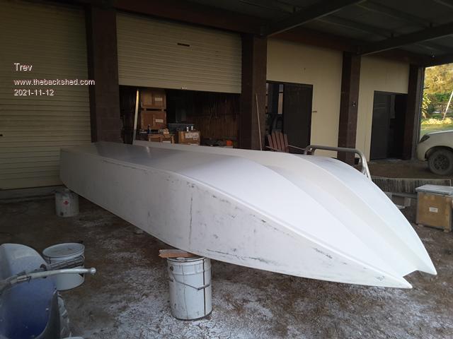

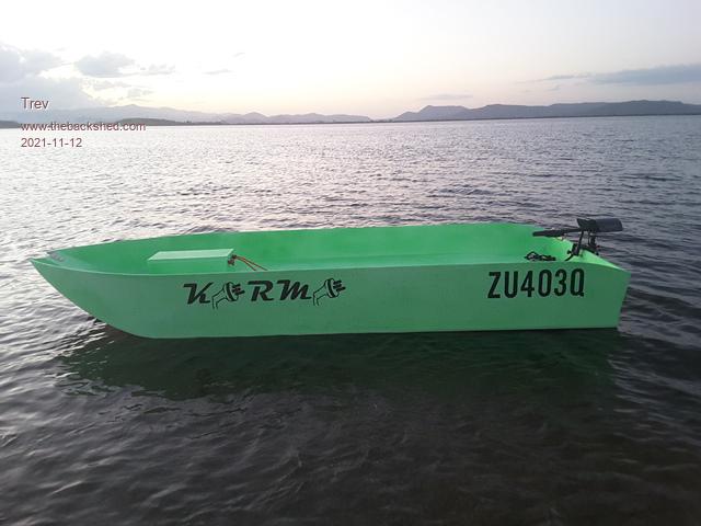

Posted: 02:50am 12 Nov 2021

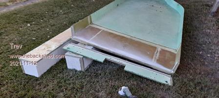

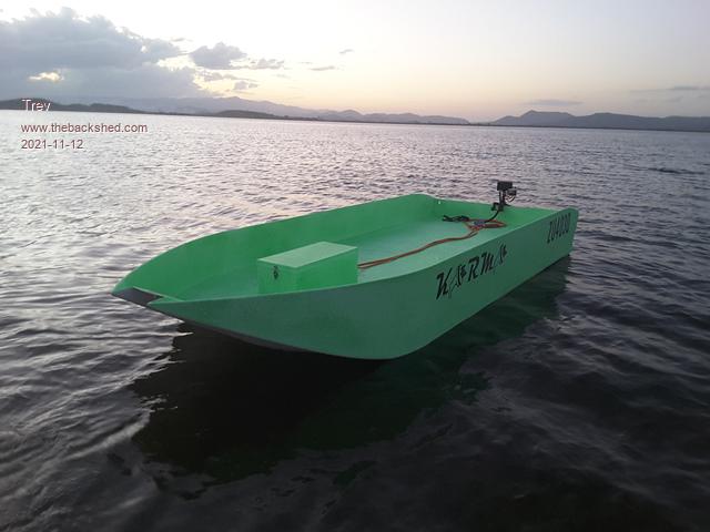

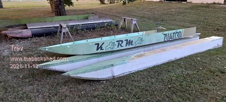

It is around a year and a half since testing.

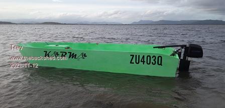

Kerme has been cut up.

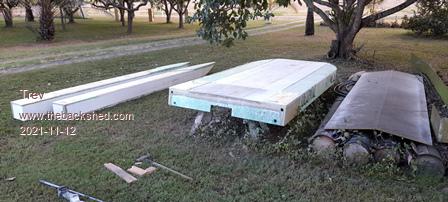

And re-modeled. I won't go into all the details of the fibreglass work, but we have cut a lot of weight out, and used much lighter foam for buoyancy. The floor is above waterline and no space for water to catch in the boat. No need for pump. Any water runs out for itself. Basically it is a floating cork. Around 70kg for the hull.
The battery pack is 48v 100Ah. Around 50kg.

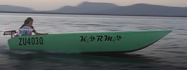

The first test is with the pod motor L10, 22kg. And 2 people, add another 120kg. Total weight on test around 262kg.

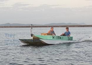

Here is Kerme with the L10 pod motor in action.
The data numbers
km/hr     Amps
 4         3
 5         8
 6        11
 7        15
 8        23
 9        32
10        40
11        53
12        66
13        68
14        77
15        90
16       104
17       107
18       108
Also measured distance traveled during testing, 2.02km and used 24Ah. Of course this is not all that relevant as the speeds were all varied.

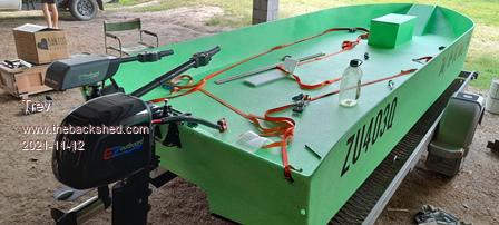

Then was the test on the 20hp motor, 40kg. Total including 2 people 280kg.
There is a few gaps in the data numbers. The water was very rough with strong wind that day. We did the testing cross wind to avoid the wind hindering or helping. The choppy water didn't help either. Don't know why but could only get 158A on that day.
km/hr     Amps
 5         6
 6        13
 7        23
 8        35
 9        37
10
11        66
12        73
13
14        76
15
16
17       100
18
19
20
21
22
23
24       158
In comparison
1) Original shape. 114kg plus .. Total 346kg. No performance numbers. This is like a bath tub. But still can't sink. Floor is above waterline with self drain holes.
2) With the second pontoon width added, 130kg plus .. Total 362 or 372kg depending which motor. Max speed 24km/hr with 191A. With motor height adjusted a little, got 25 km/hr 189A.
3) With v-bottom tunnel and single width pontoon. Probably still 130kg plus .. Total 362kg or 372kg But I don't think I tested the heavier motor on this configuration. Achieved 24km/hr at 175A.
4) No comparison drawn with the twin motors.
5) New Kerme shape and weight has resulted in some better efficiency, 24km/hr with 158A. Top speed should be higher but don't know why it didn't give more amps.

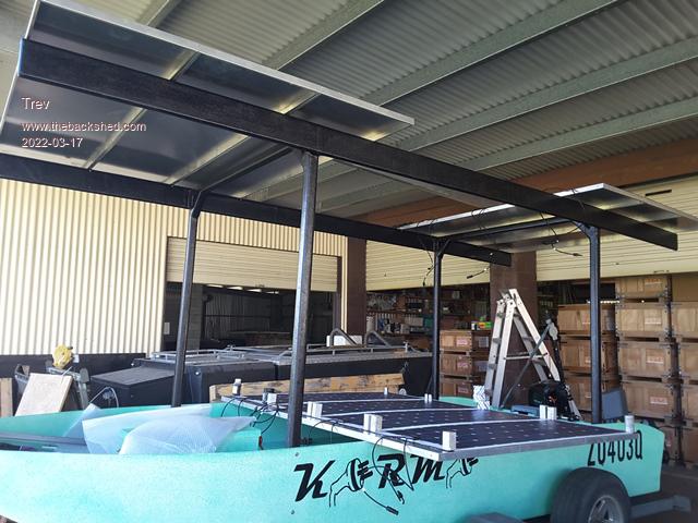

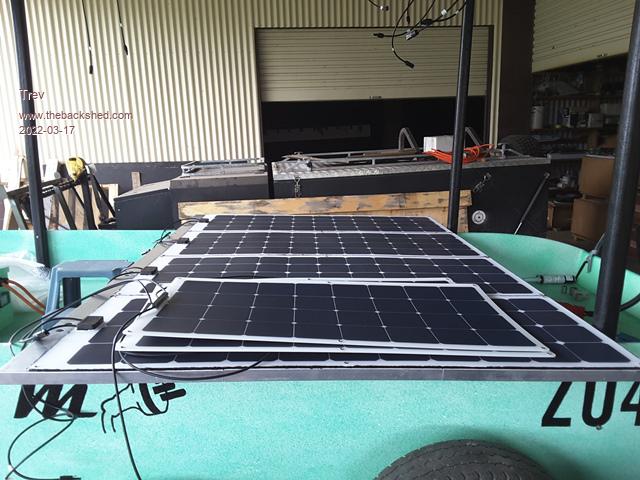

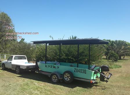

Kerme gets the solar panels.

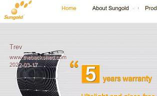

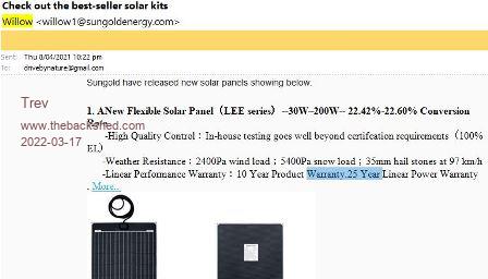

I bought Sungold flex solar panels (whole pallet) quite some time ago (years) with this idea in mind (and also as a business proposition). However, a high number of these panels sold to customers have returned. They don't last and Sungold factory won't honour their original warranty terms. They told me 5 year warranty, but many panels are not lasting even 1 year. My brother is one of those customers. I decided to keep him as a test pilot of these panels. He is up to 5 or 6 replacements now. I needed to put up some panels for charging an electric quad, so decided to mount some Sungold on alloy (better cooling) because most returned panels were sikaflexed on surfaces without cooling.
They have 5 year warranty on their old and new website
https://www.sungoldsolar.com/lee-series.html
https://www.sungoldsolar.com/Flexible-Solar-Panel-LEE-Series.html
Then several emails stating 25 year warranty. They can't be trusted.

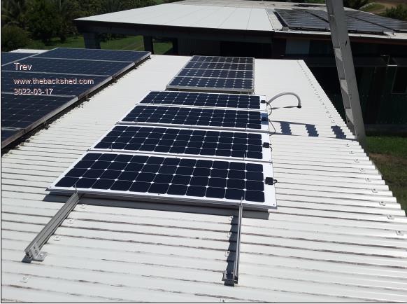

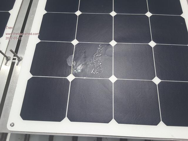

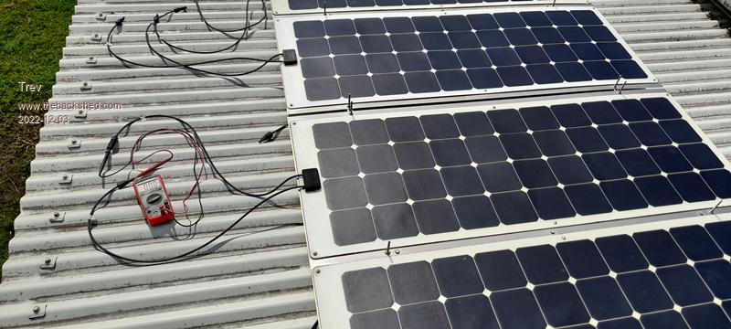

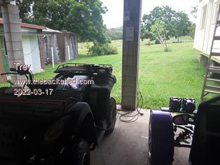

Here is a picture when installed for charging the electric quad, 9 April 2021. They are fixed with screws, no glue.
Here is a picture I have taken just now, 17 March 2022. One is obviously failing, not quite 12 months.
They are still charging, but not as much as they should, or did when first put up. I have seen as high as 3.2A, but should be 6A or just over 6A.
Anyhow, just needed to give a little history on these panels. Kerme gets 8 of these Sungold panels (140W each) as another test run. Sure have to keep a good eye on them before each trip out to sea. It will be a real bugger not being able to get back to land.
Kerme also gets 4 of the Symmetry panels (110W each). We will see which panels last the longest.

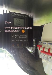

Posted: 03:11am 30 Mar 2022
Yes occasionally we used to ride the hydrofoil (or slow ferry) from Circular Quay to Manly on a Saturday night and eat ice cream and wait for the last ferry back. That's when we were young and silly. Once they cancelled the last ferry!

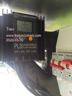

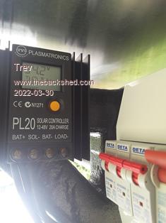

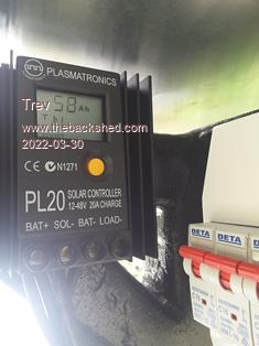

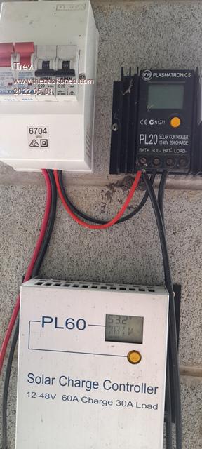

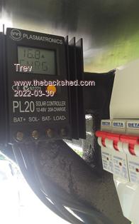

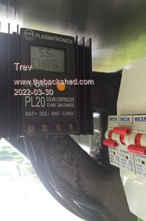

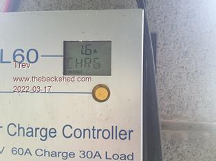

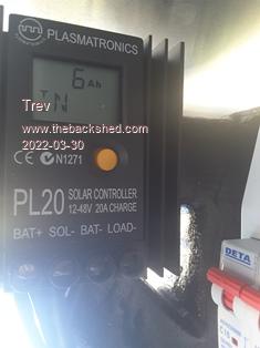

First day for charging.
The battery pack was empty, most cells were discharged down to 3.0v, or something like 48v for the pack. After being parked in the sun all morning, the pack voltage now in midday sun is 54.2v.
Back set of panels. Sungold 140W x 4 series. Midday sun 5.6A
Middle set of panels. Sungold 140W x 4 series. Midday sun 5.5A
Front set of panels. Symmetry 110W x 4 series. Midday sun 5.4A.
Sungold are not really any better than the smaller wattage Symmetry. Symmetry are also smaller size, so with this roof area, I could have 4 sets of Symmetry, but only 3 sets of Sungold will fit.
Total charge in midday sun is 16.8A
So far have put in 58Ah. I will update on anew post how many Ah I get for the day.

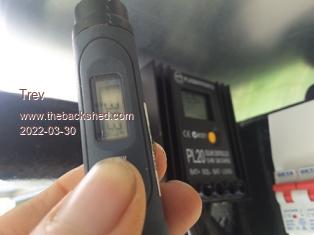

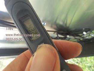

Temperature is generally around 38 -42 degreec C. But one point I did measure 48 degrees C.

Posted: 07:04am 30 Mar 2022

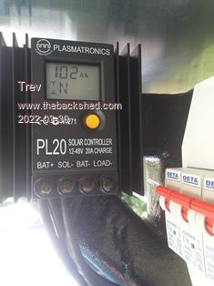

The internal clock started yesterday after noon when I connected the battery. 102Ah in over the 24 hour period. Another 6Ah in after the clock changed to the new day, to get the battery full again. The battery size is 100Ah. Still have sun available, but the shadows are getting longer.

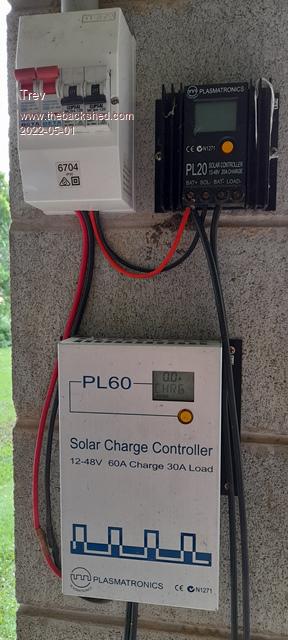

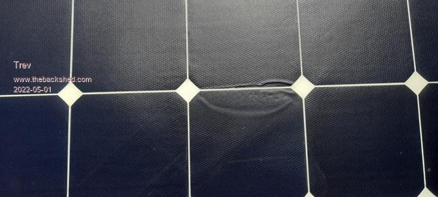

Posted: 03:00am 01 May 2022

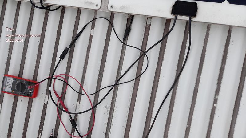

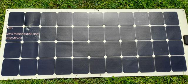

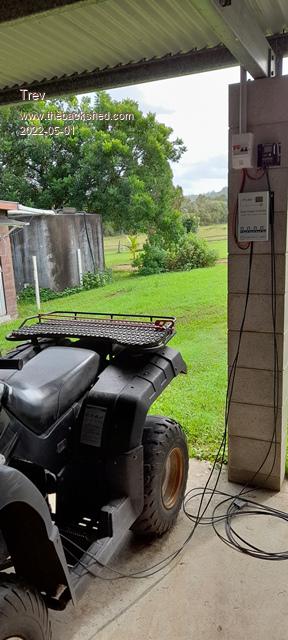

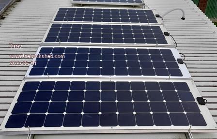

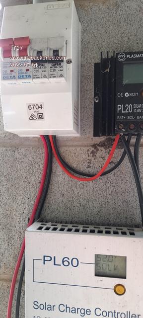

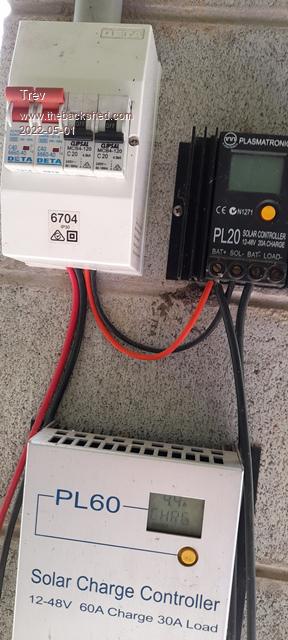

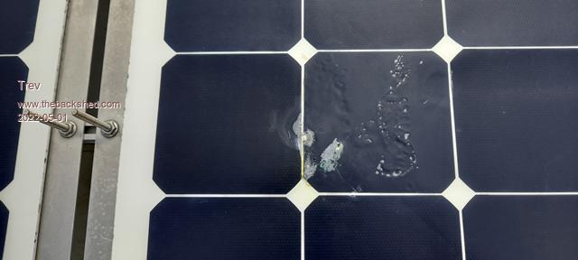

An update on the Sungold flex panels on my roof for charging the quad bike.
That failing panel, has failed.
I noticed last week sometime when I plugged in the quad bike for charging that it didn't charge. I didn't have time to investigate until today.
Battery voltage 53.2v. Solar voltage 52.0v. So zero charge.
Check the panel
Replaced the failed panel, and we get charge again.
So If I take today as the fail date 1 May 2022 and the install date was 9 April 2021, then we are just over 1 year. That is extremely poor performance.
Edited 2022-05-01 13:04 by Trev
Revlac
Joined: 31/12/2016
Posts: 1309
Posted: 07:39am 05 May 2022
Thats not very long lasting at all.
I had a friend that wanted to use flexible solar panels to cover the entire roof of a Bus, this was about 8 years  ago, at the time the solar panels available were low wattage and after some research most were not Supposed to be connected in series or parallel, for those reasons we decided it was a no go.
They were intended use was for 12v battery charging, I wonder if the 1000v series rating in these panels is some what exaggerated.
Cheers Aaron

Back in late October, another Sungold solar panel has failed on my Quad Bike charge system. That's around 1 year and 7 months.
Edited 2022-12-03 11:21 by Trev
