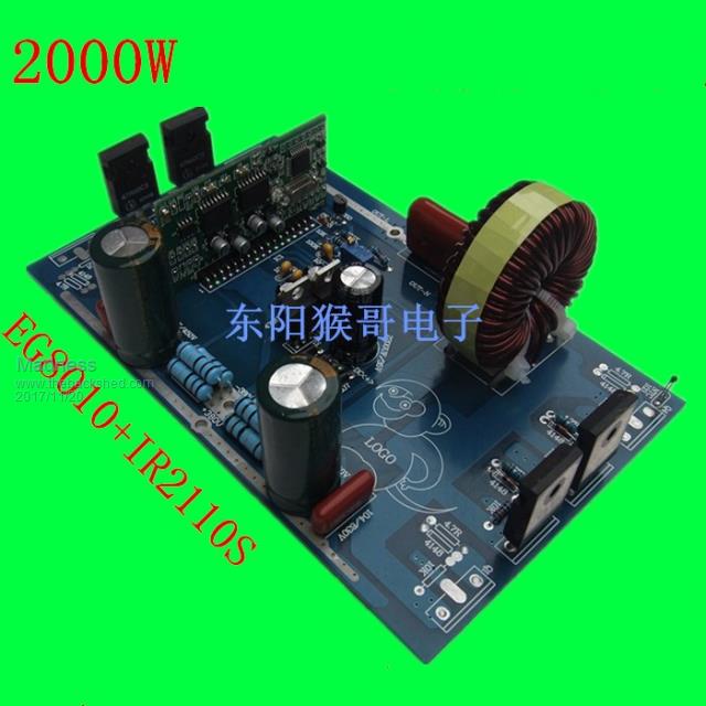

If you are wanting a high voltage DC to AC inverter this kit using the EGS002 board might be worth having a look at. I have not had anything to do with these but it might be an easier way for you to achieve what you are trying to do.

I bought a couple of these boards (not the one pictured)to ease building. Check pictures carefully. The board I got had a lot of surface mount components making it hard to work with.
