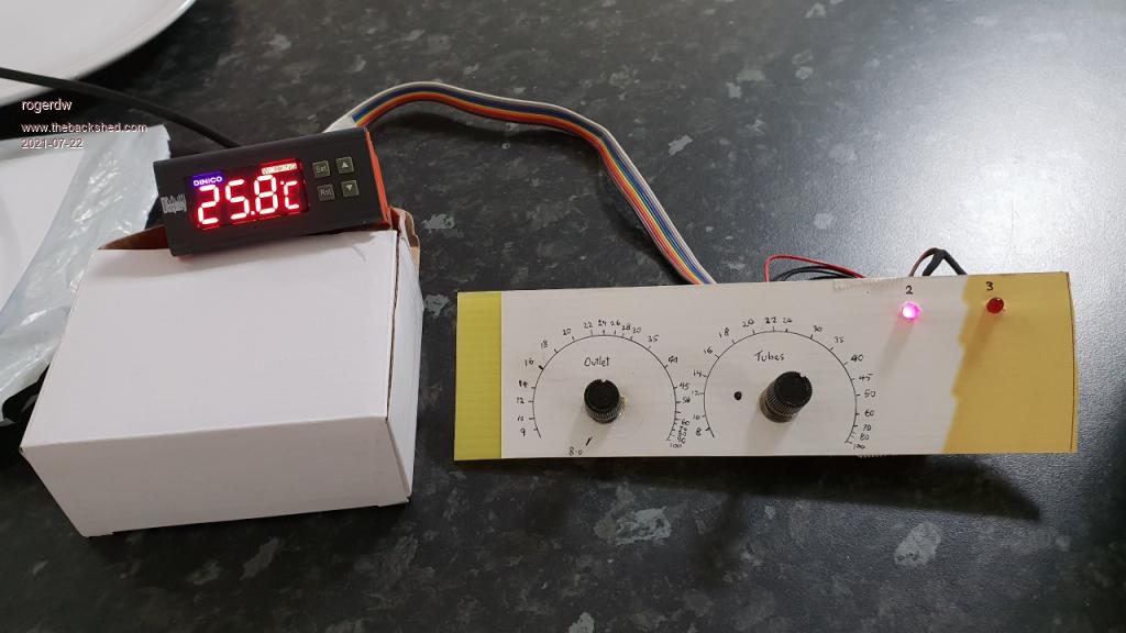

The picture at the lower right of a pumped water solar system is exactly what you want.
Connect  your air blower to the "pump" connections, terminals I and 3 in series with your air blower.
Low temperature sensor T1 will be your "room" temperature sensor.
High temperature sensor T2 will be your "tube" temperature sensor.
Set Ld to lowest diff temp where you want your blower to turn off  (<5C ?)
Set Hd to highest diff temp where there is sufficient heat worth harvesting (>15C ?)
You can then set the display to monitor the current differential temperature "d" or the tube temperature "CA2" or room temperature "CA1".
At least that is my interpretation of what it does......
Cheers,  Tony.

Thanks very much Tony, I need to get out and try it. I don't know why I wasn't able to work it out  ...  it all becomes a jumble when I try to think it through.

You are not alone Roger.
I hate these things you have to program before they work.
Where there are multiple layer menus, and complicated sequences of key strokes, and where the instructions are vague, indecipherable if not self contradicting.
Try first connecting it up on the kitchen table in reasonable comfort with a cup of coffee, with an ohm meter across contacts 1 and 3.
It should be possible to get it switching on and off from just body heat by holding onto one or the other temperature sensor.
Cheers,  Tony.

Well I did as you suggested, and played with the device. Almost felt like I was getting the concept, but it still alludes me. Bit like my 60 y/o tractor  ...  a couple of pops and bangs and a cloud of black smoke  ...  but not starting yet!
I need to substitute the sensors for a couple of 'calibrated' pots  ...  and fit a 12v light globe on the output relay  ...  then I reckon I'll get a grasp.
ATM I still keep coming back to thinking I need an 'absolute' temperature sensor in the system somewhere  ...  but I'll work it out.
I'm still some way away from needing a sensor to stop the room getting too hot  ...  at least for my wife  ...  she'd be happy to see the paint peeling off the walls.
Cheers,  Roger

Its basically operates like a temperature diode.
When one sensor is hotter than the other, the blower starts up.
When the temperature difference is zero or almost zero, (or in the wrong direction) the blower stops.
Absolute temperatures do not matter, its the temperature difference between the two sensors that causes the blower to start or stop. So as everything heats up throughout the day it still works normally.

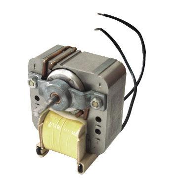

The motors in these exhaust fans are of the shaded pole type, with a single 230v winding.
Its not possible to reverse the motor electrically.
What needs to be done is the rotor needs to be removed by taking out two long bolts, and turned around, so drive shaft sticks out of the back instead of the front.
Then if the whole motor is turned around and reinstalled in the housing, the fan will turn in the opposite direction and blow air instead of extract air.
Cheers,  Tony.

  Warpspeed said  Its basically operates like a temperature diode.
I think that's where my sticking point is  ...  it's not unusual for the tubes temperature to be sitting at say 35 degrees (a very useful temperature)  ...  and for the outlet temperature to be a degree or two higher.
And even if the outlet is a degree lower  ...  I still don't want the fan to turn off.
In fact, I only ever want the fan to turn off if its temperature goes below about 25 or 26 degrees.
As you can see, I still don't understand the controller principle yet  ...  I need to do the next step with the pots and lights! Sorry, slow learner here.

These are all exhaust fans, but the motor rotation is easy to change with a bit of mechanical disassembly and reassembly. Not sure what opens and closes the shutters, but hopefully it may be by an electrical solenoid.
Anyhow, it should be possible to duct heat to more than one place, even to select some kind of heating priority based on time of day for example.
A whole range of possibilities open up.
But the differential controller will indicate when heat is available, and when it is not. That will become the master controller for the whole system.
I didn't realise you can reverse that style of motor, very handy to know. I probably don't need them here  ...  but I do have a heap I saved from wrecked microwaves.
If the room is only at say 5 degrees first thing in the morning, you want the fan to come on whenever the tubes are usefully hotter than the room is at 5 degrees. Maybe at 20 degree tube temperature or more.
If the room is up to say 20 degrees, you want the fan to come on whenever the tubes are perhaps at 35 degrees or more.
Its not absolute temperature that controls things but the DIFFERENCE of how much hotter the tubes are than the room.
If you set your differential controller to come on at 15 degrees positive difference, that is what it will do. You can set the fan turn off point lower at perhaps 5 degrees positive difference (still hotter) than room temperature, so it can then never blow cold air.
So when its freezing cold in the morning, the system starts up much earlier.
But as the house heats up, the temperature controller follows that up.
Cheers,  Tony.

O/k here is an example.
Set Ld (low differential) to 5 Celsius
Set Hd (high differential) to 15 Celsius.
First thing in the morning, room temperature only 5 degrees.
Fan starts up at 20 Celsius (5+15) tube temperature, turns off at 10 Celsius (5+5) tube temperature.
Mid morning room temperature rises to 17 degrees.
Fan starts up at 32 degrees (17+15) tube temperature, turns off at 22 Celsius (17+5) tube temperature.
Mid Day room temperature 22 Celsius.
Fan starts up at 37 Celsius (22+15) tube temperature, turns off at 27 Celsius (22+5)
Mid afternoon room up to 29 Celsius
Fan starts at 44 Celsius (29+15) tube temperature, turns off at 34 Celsius (29+5)
Cheers,  Tony.

I had a light bulb moment last night (I hope).
I've been trying to understand this differential controller with the view to using one sensor inside the tubes  ...  and the other sensor in the hot air outlet  ...   duh!
I gather I should have the second sensor picking up the room temperature!
Cheers,  Roger
Warpspeed
Joined: 09/08/2007
Posts: 4406
Posted: 12:53am 22 Jul 2021
Yes indeed !!!!!
Hot sensor in the tube, cold sensor in the house.
The blower then starts when the tubes are hotter than the house, and stop when there is no worthwhile heat to transfer.
Cheers,  Tony.

Okay, so I've finally just fitted this controller  ...  and I set it how you suggested Tony  ...  with the Ld at 5 degrees and the Hd at 15 degrees. You've been spot on with everything else so far, so I need to listen for a change.
Yesterday was our coldest, darkest, wettest day so far this winter  ...  so I didn't get anything from it.
The highest I saw in the tubes was 24 or so  ...  but turning on the fan still had the output at around 15  ...  so switched straight off.
This morning on the other hand is back to a nice sunny day. By the time I wired it up it was 11:30 and the tubes were up over 90 degrees  ...  actually over 110  ...  because even the differential controller is showing an error on the tubes temp sensor and its maximum reading is 110.
I've put the fan onto high speed because I (hopefully) won't have to keep an eye on it myself any more  ...  and let the control do its job.
When I first fired it up  ...  the outlet went up to 60 degrees within seconds and as high as 88 degrees inside a minute.
After 15 mins or so  ...  the tubes had dropped to 61 and the output 50.
I suspect the output will drop to 30-35 if the sun stays out  ...  or nose dive if it gets cloudy.
20 mins later  ...
Well, I just had another look and cloud has come over and tubes have dropped to around 30  ...  and the outlet is around 28.
I realised that because the room is still only 16 degrees  ...  5 degrees on the controller means that it will keep pumping until the tubes are down to 21. That is too cold, coz the outlet will be a degree or two below that  ...  maybe 19.
So I reset the Ld to 10 degrees  ...  and I watched while the tubes dropped to 26.3 (room 26.4)  ...  and the fan switched off!!!
Now I can wait until the cloud moves, and the tubes get back up to around 31 when the fan should come back on.
Haha  ...  and while I'm typing this I realise the fan did come back on already. I went and had a look  ...  and saw that the temp was dropping again.
Amazing, this is working exactly like it's supposed to. When it switched off  ... the outlet was pumping at 24.8. May be a couple degrees too cool  ...  but getting close already. Just needs fine tuning like you said Tony. I know, I know, oh ye of little faith!
It's done a couple cycles already  ...  I can hear it from here. Amazing.
Cheers,  Roger

Fantastic progress there Roger, it might need a little tweaking still, but basically sounds like you have a goer.
