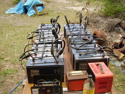

Just a quick jump back to my battery bank I am trying to save.
It has been a month now since I started this recovery
The good news is that 23 batteries have responded positively to the treatment.
The bad news is I have lost four, three to complete dehydration and one to a shorted cell.
When I started this adventure I had no idea how bad the dehydration of the cells was and thought 50 or 60 mills of water would top them up, what a stupid optimist.
So far I have used up 30 liters of distilled water over the 24 survivors and still adding. In reality it amazes me that they where still working (most that is) they must of had only a bit of dampness in the matrix to go on.
I haven't done a load test yet as I am still trickle charging and desulphating the resting voltage of all batteries is 6.5 but the charging voltage varies across some batteries from 6.8 to 7.1 volts showing there is a variance in internal resistance due to sulphation, I will give them another week on the desulphators to see if I can get the voltages more even before load testing.
SLA batteries certainly are good from a low maintenance view but the gradual evaporation of the water out of the electrolyte is their killer, the internals are very robust and good quality but the slow dehydration limits their useful life, also the higher the temperature the worse the condition, I had a set of batteries from a mine that lived in 40 plus temps and they failed very quick, on dismantling they where as dry as chips inside but I got to them to late to rehydrate them and had to scrap the lot over 2000 AH on 24 volts was a big loss, then stupid nearly let this set go the same way.
All the best
Bob

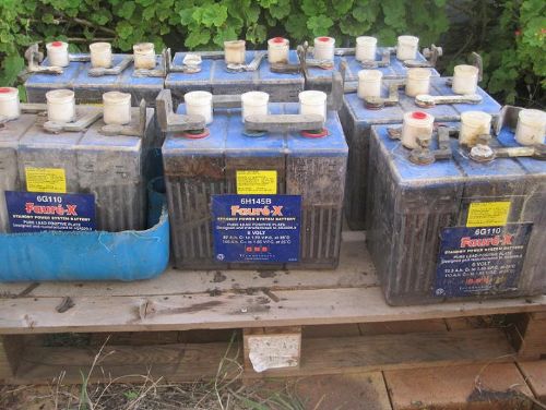

rustyrod
Joined: 08/11/2014
Posts: 121
Posted: 10:37pm 15 Dec 2014
Thanks Bob I was wondering how your batteries were progressing.
You have given me the courage for this challenge or experiment.
These batteries were picked out from some scrap metal place about 14 years ago.
There are four at 110 Ah, two at 105 Ah and the one in the middle at the front is 145Ah and I got it later.
The other batteries seemed to have been originally purchased at different times.
I got them home and added some “magic desulaphation fluid” as per instructions.
I connected cells up for 32 volts and charged them with my Moffat Virtue 32 volt generator set for a couple of hours.
Then over the next 3 or 4 years I dragged them around various old machinery rallies with the Moffat Virtue 32 volt generator set, displaying 32 volt equipment and appliances.
The batteries were able to run a radio and a few lights all night without any problems and charged again next day.
I never had a hygrometer then, so I have no idea what state or condition they were in.
About 5 years ago I had a 32 volt radio playing away on them for a couple of hours.
Then I have not looked at them since.
The one at the left front was holed by a piece of gravel about 10 years ago at the last rally I attended, so I put it in the tray to catch the drips. Incidentally the fluid in the tray has a SG of 1260, indicating that it indeed leak out whilst the cell was charged.
The one at the front Right has the positive terminal fallen off now and the cell is completely empty.
Some of the others have completely empty cells, Most cells are low in acid.
All the cells with liquid do not move the hygrometer.
The 145 Ah battery has 3.4 volts total, measured with a digital multimeter.
All the other cells measure about half a volt except the cell with the missing terminal and no fluid which measures 1.5 volts.(dry charged?)
There appears to be no indication of them leaking on the wooden bench where they were stored, so where did the missing acid go? Surely it can’t evaporate? They were not connected to anything or each other.
When I take batteries to the scrap I always drain the acid to use to clean copper ect.
This old stored acid will just move the hygrometer, and tastes mildly.
The liquid in the cells has no taste or extremely little.
NO, I usually do not go around tasting batteries, but I wanted to know how weak the acids were. Now I need some cold liquid to wash the taste from my tongue.
SO, I will use my collected very mild acid to refill those that are empty and distilled water to top the other low cells up again.
I will build some of these 555 desulphators, connect the batteries in a 12 volt configuration and see what happens.
The 145 Ah battery will be charged by it’s self, for a start then combined with the big 6 volt truck battery. Yes a big mismatch, but good for an experiment.

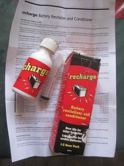

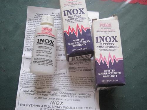

rustyrod
Joined: 08/11/2014
Posts: 121
Posted: 12:48pm 17 Dec 2014
This is what I used. Lucky I kept some of the boxes for 14 years.
Can you guess I NEVER throw anything out!
The little bottle cost $4.95 each then.
The bottle held 92 ml.
The instructions said for 60 ml for a 150AH battery so I halved it and I put 46 ml in each cell.
There was 30 cells originally so I got 15 bottles.
Well the batteries were pretty cheap at the time, swapped for a carton of beer.
Point of interest---The inside of the case of the empty cells in the batteries has a coppery coloured residue on it.
Looks like the plastic has a pale rust on it.
Could it be the remnant of the cadmium sulphate reaction.

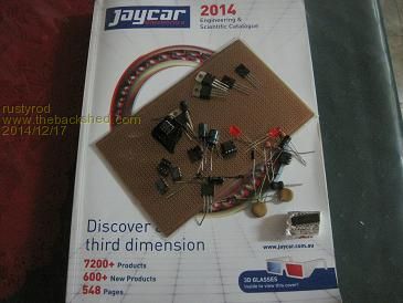

rustyrod
Joined: 08/11/2014
Posts: 121
Posted: 11:48pm 17 Dec 2014
I am going for the 12 volt one first. Smaller smoke?
No, I hope to get it to work on the 6 volt big truck battery.
The Mosfet IFR9Z34 is rated at 60volt 18 amps [from specs off Bob's link]
And D1 GI826CT Fast recovery diode, >6 A, 100 V [from parts list]
I will try these
Jaycar specs
Cat No… ZT2467…Mosfet IFR9540N rated 100volt 23 amp…$4.95
Cat No… ZR1028…BY229 Fast Diode rated 600 volt 8 amp…$5.95
Cat No…ZL3555…NE555 Timer Ic…………………………...$1.25
Cat No…PI6500….8 pin ic socket……………………………...$0.32
Cat No…LF1267…220uF 6amp Ferrite Choke…..ordered……$4.95
(Couldn’t get a 1000uF choke so I will series these 2)
Cat No…LF1108… 470uH Ferrite Choke by 2x.60c.........$1.20
Cat No…RE6310…100uF 16 volt Low Impedance Electro...…$0.36
Cat No…RE6332…47uF 35 volt L I E (for C1)……………….$0.36
I had ceramic caps…but all are 32c for 2, so 2 pkts……………$0.64
I had resistors………but all are not much……………………...$0.05
Cat No…HP9550…Vero board 95 X 72 mm…………………..$4.50
If I added it right…………………………………sub…...…$24.53
Labor with Coffee or beer and patience...sundry bits………lots of ?
But will it work?
If it will, then I MAY make 2 more for the old lighting plant batteries. I’m expecting failure at recovering them or it will be a long process.
I am thinking I will connect them up as three sets of two with sets of thin leads from the charger and a desulphator across each pair.
Wait a minute, get one desulphator going first, I haven’t turned the soldering iron on yet.
Then I need to fix the batteries. Liquid and terminals ect.
Nothing like ambition or is it dreaming?
Well anyway it keeps me in “The Back Shed”
I have my insect singing sweetly. It's loud so listen carefully and you will hear it ringing in your ears.
Now I have to wait "patiently" for the big choke.

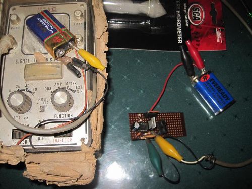

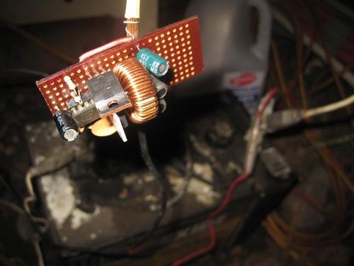

The choke came Friday, so soon had it soldered in.
I hooked it up to the big 6 volt battery this morning.
Is it working?
I have connected my signal tracer directly to the battery and I have a slight 50Hz hum as you would expect from the battery charger AND the high pitch squeal.
So I connected the signal tracer to a battery with the commercial desulphator, there is the hum and each time the led flashes a similar tone.
Mine is louder and constant.
Next I connected an amp meter between the battery charger and the commercial unit and it draws about .001 of an amp then I connected the battery and it draws .005 of an amp.
This is only when the indicator led is on.
Ok, what about mine?
Connected to the battery charger it draws .005a
With the battery connected it draws .25a.
The Mosfet and the Fast diode are nice warm and the choke is just warm.
I am looking “in the shed” for Dad’s frequency counter and will compare the frequencies.
Remember this is all on a 6 volt battery.
In the circuit the 12 volt version has a 220uH choke and the 24 volt version has a 330uH choke
SO, I put a 100uH choke in my 6 volt version.
If the commercial unit draws 1/20 of an amp and mine draws Ľ of the amp,
IS MINE 5 TIMES MORE POWERFUL ?
Is it dissolving crystals or just using up power from the battery charger?
Time will tell I suppose.
What other tests could I do, Please?
A BIG thanks to VK4 bob for showing me in this direction.

Hi Rusty
Sounds like you have a real success on your hands there, to have a look at what it is doing you will need a CRO to read the waveform a little test I do with the Infinity ones is to see if there is arcing when you connect to the battery, if it is working there is a nice fat continuous arc.
It shows that we can stretch the skills a bit and save money, but as you say the proof will be if it works and desulphates the battery, for that we have to wait a couple of weeks.
I have been going through my battery banks desulphating them after the big dry out and most are responding well just a slow process, I will have to build a few of these and spread them around the battery bank.
One thing you could try is to get a little transistor radio set on AM it should pick up any radiated signal from the device.
All the best
Bob
