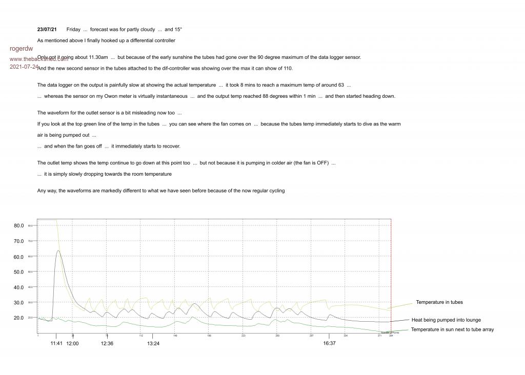

rogerdw
Joined: 22/10/2019
Posts: 957
Posted: 02:12pm 23 Jul 2021
I haven't posted any charts for a while but thought it was worth showing how things look with the new differential controller looking after things. Thanks Tony.
Hopefully tomorrow's will be better again seeing it can be ready to go with the first sunlight  ...  assuming of course that we do get some.
And I really do need to pull apart another of the data loggers and fit the sensor externally, so I get quicker and more accurate readings. At present it takes 8-10 mins to catch up  ...  and if there are any wild swings it misses them altogether.
I might go out and modify one now  ...  and be ready for the morning.
Cheers,  Roger
Warpspeed
Joined: 09/08/2007
Posts: 4406
Posted: 02:14pm 23 Jul 2021
Right now, we are at the shortest day plus one month, so it's probably about as bad as its going to get cold weather wise.
It might be interesting to log it over the next few days and see how much temperature increase throughout the day can be achieved.  Multiply that by the increase in the number of tubes in your final design, should give a pretty good idea of the final potential.
Cheers,  Tony.
rogerdw
Joined: 22/10/2019
Posts: 957
Posted: 11:55pm 23 Jul 2021
I don't know if this is a normal winter or not for us over here  ...  but I have been amazed at how many days the sun does shine at least for a few hours  ...  and how few days it is grey and overcast all day.
Another observation is that it doesn't seem to matter how cold the ambient temp is  ...  if the sun shines, we can pump heat.
At present I have 18 tubes and the new one will be 60  ...  so potentially 333% higher  ...  plus being on the roof, will not be shadowed by the fence in the mornings and later afternoon.
It started off early this morning, soon after 8 am  ...  though I wasn't able to concentrate much on what was happening. Seemed like it maybe should have been allowed to build up more heat before it came on  ...  I'll have to look at the data tonight to see if it makes more sense.
I did crack open the logger that sits at the warm air outlet and drilled a hole so the sensor is exposed directly to the airflow  ...  so will hopefully be a bit more responsive.
Cheers,  Roger
Warpspeed
Joined: 09/08/2007
Posts: 4406
Posted: 12:11am 24 Jul 2021
It does not need very high tube temperatures to work. As long as the tubes are warmer than the house, there will be heat to harvest.
In fact, the blower will cycle and keep the tubes at a just sufficiently high temperature to work.
That is excellent, because heat losses through the ducting will then be far lower if the warm air coming back to the house was at a much higher temperature.
The whole thing will be much more efficient than allowing the tube temperature to get really high before turning on the blower.
The data logs will tell the story...
Cheers,  Tony.
rogerdw
Joined: 22/10/2019
Posts: 957
Posted: 10:19am 24 Jul 2021
Okay, well I thought this mornings figures were a bit dodgy  ...   but while I had drilled the outlet data logger case to expose the sensor to make it more responsive  ...  and it does seem a bit better  ...  it still seems a little slow.
I might bring it right out on stilts into the airstream to see if that helps.
Apart from all that, it looks like the system is working very well
With the conditions we've had since the rain set in at lunch time, I normally would have just turned it off  ...  but like you suggested Tony, the system still managed to eke out half a dozen more bursts of heat that I would have missed out on.
Cheers,  Roger

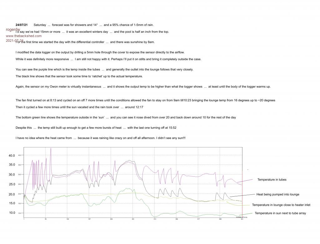

rogerdw
Joined: 22/10/2019
Posts: 957
Posted: 03:35pm 24 Jul 2021
  Davo99 said  Looks very Promising!
I'm sure the heat output was not a lot but the fact you got any is the takeaway here.
When the clear days do come, going to be very worthwhile.
Thanks Dave. It did actually start out very well because of the early sun  ...  and took the room from 16 degrees up to just over 20.
Then of course when the change came through and the outside temp dropped considerably  ...  the guts dropped out of it.
I need to address that data logger because I was getting away with its sluggishness before  ...  because it used to have time to catch up to the changes in temperature  ...  they were long slow changes   ...
...  but now that the temp goes up and down over only a 5-10 min cycle  ...  the device takes far too long to respond and reads 5-10 degrees too low sometimes.
If I could use my good meter to log the readings, it would look far better.
  Quote  The controller seems to work with my solar PV belief, Get in early and keep it flat out long as you can.  This is generating heat soon as the sun hits it and beyond and now you are able to take advantage of that. Will make a big difference to the total Kwh of heat you get in the house.
Yes, this is what Tony's been trying to get across to me all the time  ...  and now that I'm already seeing the effect, I'm a convert too.
  Quote  Multiply this by 3 Odd on the big array and will be impressive.
Definitely hanging out for that, though hoping I'm making the right decisions.
Weather here has been OK till about lunchtime and then turns to crap. That wouldn't be a total loss for your system though. If you got good sun in the morning, it would recover the house heat from the night possibly to carry you through 4 hours or so till late afternoon where the sun falls off quick anyway.
The August winds have arrived here already and plenty of gales blowing up.  I surmise the beauty of the tubes is they won't be affected by wind too much.
We don't seem to have that problem here, though there are enough grey days to take the edge off the enthusiasm sometimes. Of course when the sun comes out and the heat goes up  ...  it's all smiles again.
  Quote  The tubes definitely have the capacitor effect so can be charged up with heat over time then that is dumped into the house. Brilliant.
It was funny this afternoon. I came in from sawing and splitting the last of our wood and it was already 4pm  ...  so normally it's all over by then  ...  but the tubes were hovering just one degree below where the fan would have turned on again  ...  31 degrees.
As I said above  ...  I have no idea where the heat was coming from because it was 10 degrees outside and had been raining virtually the whole time since lunch.
  Quote  I have been looking to see if I can find any cheap Tubes as this all has me quite intrigued with the things but so far all I have seen is what I would consider well over priced and none really local but they seem to be popular around Canberra judging by the number of ad's I'm seeing.
I haven't looked since getting this big batch  ...  but I'd be ringing around to find out who installs them and get friendly with them  ...  or find out if any local plumbers regularly "uninstall" them because they can't make them work properly as water heaters. You seem to have that knack with pv panels, just work your charm on the plumbers.
  Quote  I am so looking forward to seeing what the big array will do in Summer.  :0)
Is there a way to take output measurements In KW?  Can you  ( or the other smart people here) work it out on the temp through the outlet and the airflow which I take it is also Fixed?
Haha, me too.
For outputs in kWs  ...  I did use Tony's suggestion where I added an electrical heater in the outlet tube  ...
...  then once it was running smoothly on sun power and I had a consistent temperature  ...  then turn on the element and wind it up until the output temperature was exactly double.
Then work out what the element was drawing in watts  ...  and that is the same wattage the sun was providing.
I did use that for my early 6 tube setup  ...  but once I put in the 18 tube system it got pretty dangerous trying to run an element up over a thousand watts and all inside plastic.
There is a formula you can use and which I have quoted figures from.
I did post it once before and was told it was not correct  ...  but they couldn't provide the 'correct' one.
Airflow in meters per sec x
Outlet Cross Section Area (in sq meters) x
Specific heat of air (~1000 J/kg-C) x
(Outlet temperature minus Inlet temp)
= Output Power in Watts
So today, a higher output would have been around lunch time before the rain started.
Air Velocity 4.0 m/s x
Outlet Duct C/S Area = .01779 sq/m x
1000 x
The outlet temp was 37 degrees minus inlet of 21 degrees = 16 degrees
4.0 x .01779 x 1000 x 16 = 1,138 watts
Yesterday when I turned it on late in the morning and the output was 88 degrees  ...  minus the input at 16 degrees = 72 degree difference.
4.0 x .01779 x 1000 x 72 = 5,123.5 watts
Of course that was only an instantaneous reading because it very quickly dropped back as it removed the stored heat from the tubes  ...  but it was still pretty impressive standing in front of the duct pumping out that level of heat.
I like to imagine the new one at 3.3 times that output  ...  though that sounds almost dangerous  ...  but I'll be happy if it can be pumping out 3 or 4kW on a regular basis.
Cheers,  Roger
Warpspeed
Joined: 09/08/2007
Posts: 4406
Posted: 03:55pm 24 Jul 2021
That all appears most encouraging.
Even when the blower is cycling and the system struggling the temperature is rising.
If you can get a nice clear day, that should be really interesting.
With three times the power and some better weather ahead, this is showing some great future potential.
Cheers,  Tony.
rogerdw
Joined: 22/10/2019
Posts: 957
Posted: 04:20pm 24 Jul 2021
Yeah, thanks Tony. Despite being the middle of winter we still do get some great days of sun, even though the wind can be biting. I can't wait for another of the good days to see how this new controller performs then.
I just went out and modified the data logger again and fitted the sensor fully outside the case. I think that is what worried me this morning seeing it still lagging behind the actual temperature  ...  and of course making the graph I showed look poorer than it should.
It's funny how different results can take the edge off the enthusiasm  ...  and then some good ones can bring it all back.
Thanks to you and Dave for all your advice and support, it really helps.
Cheers,  Roger

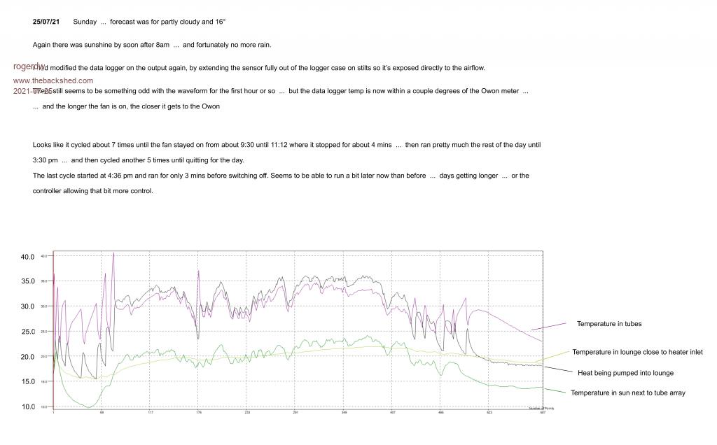

rogerdw
Joined: 22/10/2019
Posts: 957
Posted: 02:13am 25 Jul 2021
  Warpspeed said  Wind and a low outside temperature should have little or no effect, the only real killer will be big black nasty clouds that block the sun.
Yes, that seems the case.
What surprises me most is it doesn't seem to need direct sun either  ...  just light  ...  though of course the output is not that spectacular until the sun pops out.
My modified data logger is working better than yesterday  ....  much more responsive  ...  though still 2 degrees below for a minute or so  ...  and finally as close as .5  if the fan runs for long enough.
Looking forward to seeing the chart tonight.
Cheers,  Roger
Warpspeed
Joined: 09/08/2007
Posts: 4406
Posted: 02:54am 25 Jul 2021
If your logger uses thermistors, try getting some of the really small bead thermistors.  These have a very short time constant, well under one second.

rogerdw
Joined: 22/10/2019
Posts: 957
Posted: 09:44am 25 Jul 2021
Here's todays figures. Was a nice day  ...  cool enough, but sunshine on and off all day.
Nice to see the lounge temperature go from 16 degrees up to 22 degrees.
The charts are certainly quite different to before fitting the differential controller, with the switching on and off until the sun is sufficient to allow the fan to run continually  ...
...  and then later in the afternoon as the sun reduces and it comes in cooler  ...  then the fan switches in and out again until it gives up for the day.
Another thing I should mention is that I have had the fan switched to high speed ever since fitting the differential controller. Just about all my graphs in the past were with the fan on the low setting  ...  except on really sunny days.
Something that seems odd is the temperature of the outlet into the lounge is higher than the temperature in the tubes during the middle of the day. Not sure how or why that is happening.
