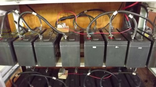

The sparking when you connect the desulphator is normal and that is one way of checking it is working.
I use the Infinitum desulphators my self and found them very good and reliable, I have only managed to destroy one a 12 volt unit, I think I put it across 24 volts by mistake and it died I will cut it up and see whats inside I may be able to repair it if its not fully encapsulated.
If your battery is sound just down on capacity you will get it going again but it may take a few weeks, keep your charge rate low preferably around 2 amps as if you go to high you loose active material from the plates.
This is the desulphator across 24 volt 250 AH not ideal but it works slowly, I am going to put 12 volt ones across the split bank when I get around to making them.
This is the charge rate across 24 volts 250 AH pack this is desulphating without boiling the active material off the plates
The exception to this rule is on a badly sulphated battery that won' accept charge, you need to give a king hit to get it conducting maybe 60 volts to break the resistance then reduce voltage and current until the battery is bubbling lightly and evenly across all the cells, when you have a proper voltage across the battery indicating no shorted cells reduce to below five amps for a day then go back to 2 amps for several weeks.

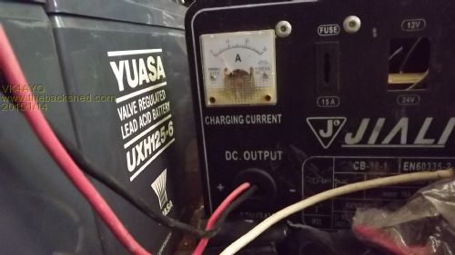

Progress report
Hi All
All voltages have stabilized on the bank number one batteries all are within .1 of a volt and a 48 hour sit test showed stability in all batteries, so I started reassembling the bank today. Once both banks are hooked up Ii will do a load test with a 2 KW heater and record the voltage and capacity. The combined capacity should be 1500 AH but I suspect it will be lower as the first few cycles generally show less capacity until the batteries settle to chemical balance.
In this case it should yield 1500 AMPS over 20 hours as per battery spec rating that equates to a 75 AH load for 20 hours but as I only want to discharge to 50% it means a test to 75 AMPS an hour for 10 hours final voltage will tell me the overall capacity of the bank without full discharge.
Considering the trauma these batteries have been subjected to I would be surprised pleasantly if they show 50% of rated capacity, they should build more capacity with ongoing use, but that remains to be seen.
All the best
Bob
