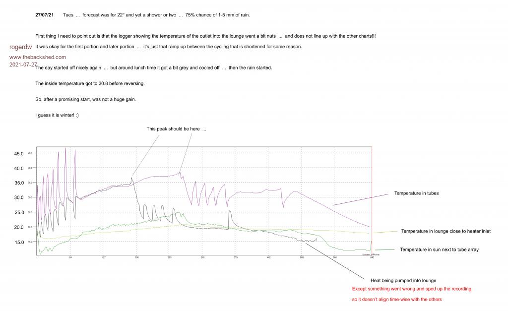

Today started off well  ... but a change with rain came in about lunch time.
On top of that, one of my loggers glitched for some reason and must have changed its recording times somehow. If you look carefully you can see where it should line up  ...  so it's still worth posting to see what poor conditions do to the results.
Cheers,  Roger

  Warpspeed said
  Davo99 said
And Might be Cold and sunny and your setup will work a treat!!
The coldest frosty mornings usually go with a clear bright starry night, along with a cloudless sunrise. Perfect scenario for the "Roger Tubes".
Haha, yeah  ...  I didn't think it was all that cold this morning when I got up  ...  but it's certainly come in cold now. Came in for lunch and put on my ugg boots and beanie.
It's cold, blustery and has been raining  ...  but the whole time I've been in here I can hear the fan running.  I don't know how it's getting any heat out of anything but it's pumping 34 degrees at the moment so I'm rapt.
I'm also changing my thinking for when the big one goes up.
Before I had just planned to have an outlet in the lounge and one in the games room which is always cold  ...  but now I'm thinking I need the main one here in the kitchen/living area  ...  even though that's where the wood heater is.
That way, with the wood heater off, it is still the first area that gets warmed, because that is where we all mostly spend our time inside.
Once it's warm enough in here  ...  we can switch in the inlets to those other rooms to spread the warmth further  ...  which I have no doubt we'll be able to do fairly often. A couple of those damper valves should handle that ok, along with some smarts of some kind.
Cheers,  Roger

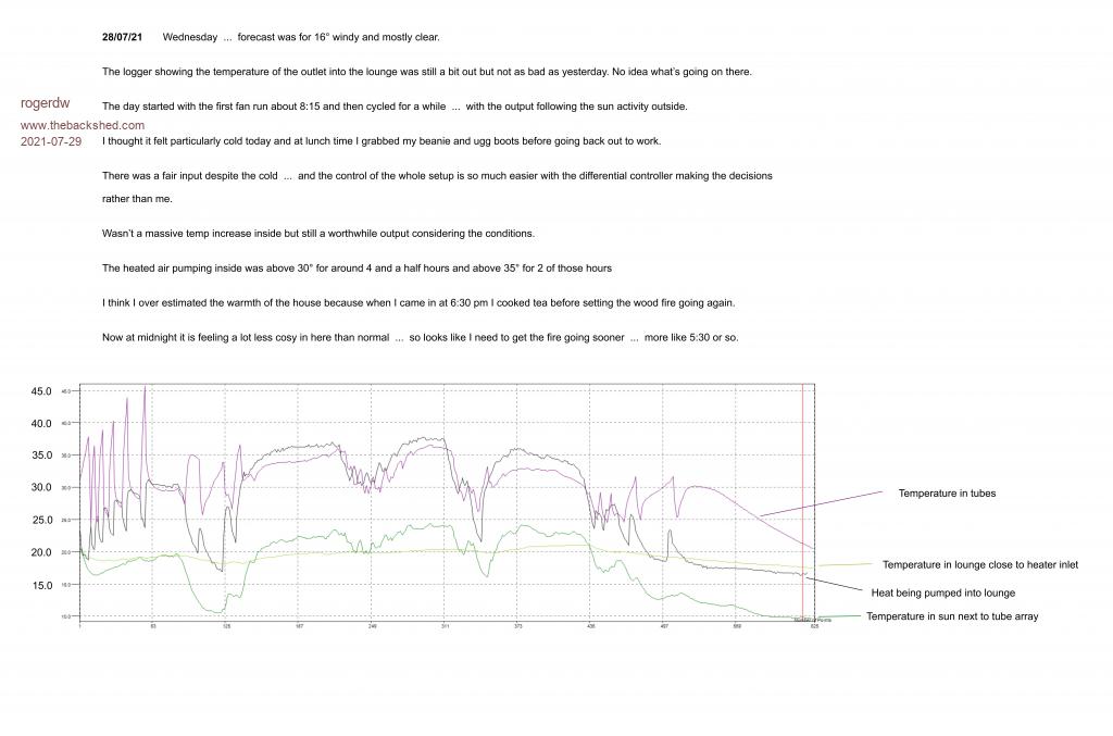

  rogerdw said
In fact I had figured that it would be cool to set up a raspberry pi or something to monitor the output when it has one  ...  and actually record the kWhrs it produces. Shouldn't be that hard if I only have one or two fan speeds  ...  log the temp in and out  ...  and the length of time it's on. Pipe dream of course, but nice to think about.
Maybe I just don't know enough to know what I don't know.... But seems to me it should not be that hard apart from programming the PI itself.
You have 2 of the 3 parameters, air flow speed and diameter of the Pipe so qty of air. Even if you didn't have that, Mass air flow sensor like in a car wouldn't be hard to work with, seen that done many times on DIY projects.
All you need is a sensor for the temp and surely there should be a calculation you could plug into the Pi to give both an instant and cumulative output in KW.
And that's why I also have to fit a dc motor to run off pv panels  ...  so the uneducated can't point to the little 50 or 100 watt fan and say "but it runs off electricity  ...  that's where all the heat comes from"
Although we think so much alike on so many things, we also think very differently.
Now if this was my work of art and engineering Genius and someone told me all the heat was coming from a 100W Motor, the LAST thing I'd be doing would be trying to change their minds!
I'd be saying "ya know, you are dead right, you figured it out.
I'm making 4Kw of heat from only 100W of electrical input.  I was going to market this myself but my wife wants me to spend more time with my family ( guess where I stole that line from? )  so I have decided just to sell the rights to this.

  Warpspeed said  Yup.
Easy enough to do with one or more room thermostats and some relay logic.
Once your main living area is up to temperature, divert the heat somewhere else, then maybe to a third choice on a priority basis.
Yes, makes a lot of sense now, thanks.
After this evening where I didn't relight the fire until 8:30pm, I think I'll make sure I do it earlier as it is noticeably less cosy in here now than usual.
Must have had a false sense of security because it did feel nice and warm when I came in at 6:30 after a day of the solar heater supplying heat  ...  but obviously that disappears fairly soon.
Cheers,  Roger
Warpspeed
Joined: 09/08/2007
Posts: 4406
Posted: 09:40pm 28 Jul 2021
the temperature rise is considerable, and will be about three times as high with the big system.
I think were gonna need a bigger blower
Cheers,  Tony.
