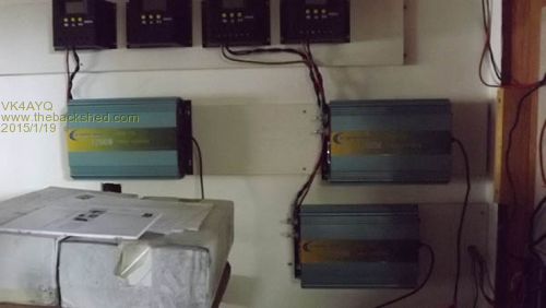

The smaller Chinese GFI are nor as efficient as the normal GFI the one I run at the moment is 600 Watts and is good for 80 % I have 1.2 KW ones as well and on testing they are good for just over 90% but some I have bought do not work at all

A couple of the plug and play GFI units could return excess power from the panels to the grid and run your meter back a bit, when connected across the panels the GFI draws only a few milliamps until the regulator shuts power to the batteries then the panels increase in voltage because of no load and it fires up the GFI 55 Volt ones in your case, I use 28 volt ones on my system.
You could do the same with your turbines feed them through a solar regulator for the same effect. Better than wasting all that excess power and gives you a bit up your sleeve from the grid when needed.
