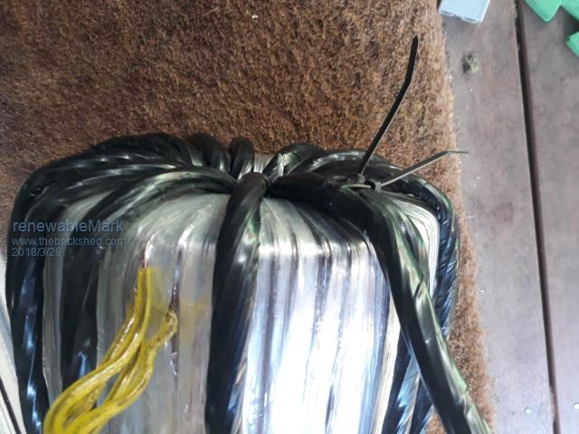

Hi Mark and crew,
this takes me back to finger-breaker days ! Bending that 25mm sheathed cable ,ouch!

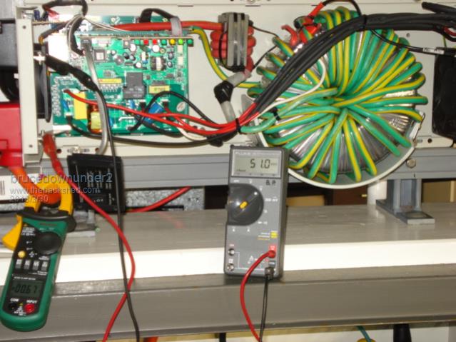

This is my W7 that now is a boat anchor ,if I can't get it repaired--hit by a lightning surge,not a mark on it ,so that makes it all that more difficult to find ,or even start.
Bruce

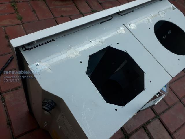

I made up some plates and extedned the front by 50mm.
Took the mounting plates off the aerosharp and fitted them to the extension.
Now I'm thinking, BUGGER, I could have not cut the heatsinks down so much.
Oh well, second one will be a ripper, this will be my reserve unit.
Cheers Caveman Mark

Bruce Ha! 25mm, that's for babies!
Try bloody 70mm2, it actually wasn't that hard to be honest, but there was lots of swearing, more because of the awkwardness.

Using old wire is much harder due to hardening.

Thanks Mad, it came up pretty good, with some paint it shouldn't look out of place.
Yeah, I sat the torroid without any rubbers etc in the case and layed a bit of wood across the top of the case, there was only 5mm gap, so by the time isolators and a big washer and nut go on it would have been way over.
Thinking about what Tinker said, I might just get a single sheet of Al for the cover. It will just need some holes drilled for the bolt locations, I have to paint the case anyway so no big deal.
Leaving as many parts captive to the case is a great idea though.
Might be an idea to hinge the cover and have all the connected displays close to the hinge side.Edited by renewableMark 2018-03-31

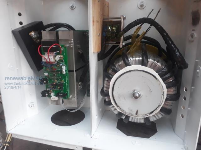

Made a bit of progress.
I got a forklift battery too, it's only 620AH @48V, not as big as I would have liked, but it can be replaced or added to.
Cheers Caveman Mark

Re case, it got primed and sprayed white inside, just a nice and fresh look.
That black box on the left is a project box for the neg dc shunt, haven't worked out how I'll mount that yet.
I clamped the ferrite core with capton tape the way Klaus does his, but I just butchered a clamp by smashing some 4mm al in the bench vice redneck style.
I'll have to look into the other choke he uses, I'll just try and get something working first and make refinements from there.
Once this is tested I'll add more mosfets and with some luck it doesn't go pop.

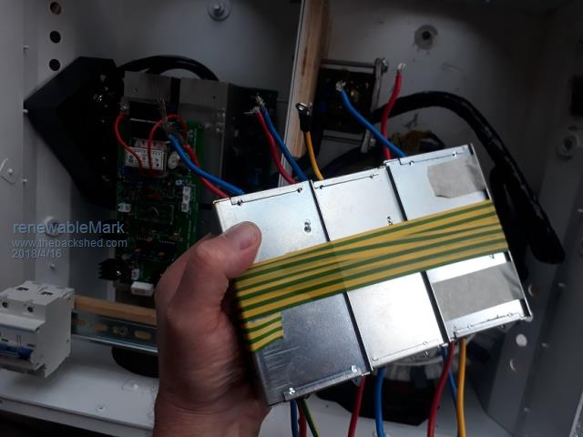

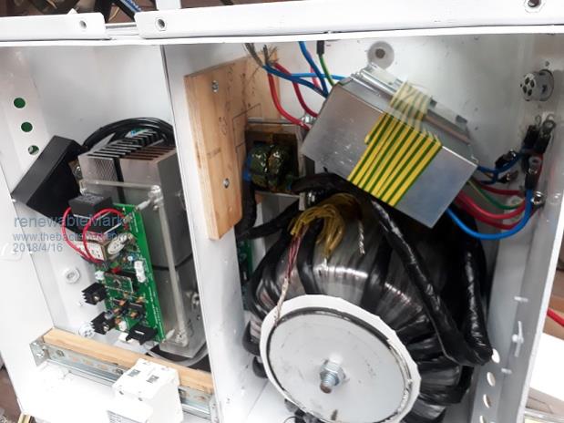

Thanks Tinker and Mad for that advice, it's a bit of a narrow spot that, so not much can go in there anyway. I did want to fit a meter on the inverter so I could know exactly what that unit was doing, not just the overall V in and out of battery, but that is a great idea too, shunt and meter combo's are pretty cheap so I'll get another for that too.
The issue I am having now is fitting the filters.
Unfortunately, the torroid is mounted a bit high, so it's too cramped to fit the filters vertically on the case next to each other.
What I thought of was to mount all three vertically, they'll need an al seperator, then bolt the lot down with a clamp similar to the way the choke got done.
Anyone see an issue with that?

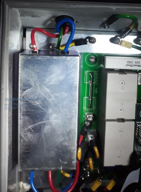

Mark, these look like the filters you got out of an Aerosharp box. I was told they are DC (solar panel) filters and not a good idea on AC in the transformer output, but I might be wrong - it was a while ago.
Why not get some proper 50Hz AC filters, like the ones you see in my or clockman's pictures? I think there were 7A versions in the Aerosharp but you need to parallel quite a few for 6KW. I bought the 20A version from RS electronics, fitted two in parallel.
You might also find them on e-bay.Edited by Tinker 2018-04-17

Pretty sure they'll be OK as it's the last thing connected before it goes to the AC output on the aerosharp.
This is a pic of my last one that's still complete. The outputs go to the black plug which is grid connect.
Cheers Caveman Mark
