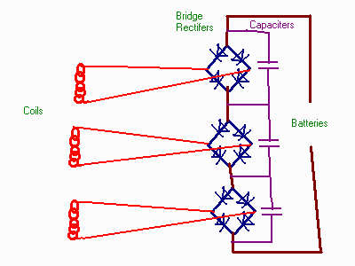

Hi Niall,
I fail to see how that can work??
You also imply a 6 phase input from what i can make of it.
Pete.

i,m not fully sure about the diagram...i,m trying to rembember it but probabely getting it wrong....nothing new there then....
its something to do with adding dc voltages through capacitors ..
the input is three phase Pete , each start and end are brought out and rectified
independently then the dc voltages are linked (added ?) through the caps ,
i think some people used it on fieldlines with car alts to get higher voltage from an existing stator without doing a rewind ....
the way i look at is , its kind off like charging three small batteries in series
then taking the sum of all three as an output .....maybe i,m just losing it...
i rembember playing around with it a long time ago and think it did work in some form
i try to find that old link....that should help
niall
niall1
Joined: 20/11/2008
Location: Ireland
Posts: 331
Posted: 05:30pm 14 May 2010
bugger...i knew i was raving...sorry about the failed auto cad experiment Bob
pic from wooferhound on fieldlines and a link
http://fieldlines.com/board/index.php/topic,143290.0.html
edit...this topic came up much further back as well but its tricky to find it
looking at the circuit now ....it doesent look like a conventional cap doubler circuit...the boost is on the dc side...??.. Edited by niall1 2010-05-16

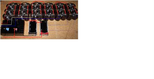

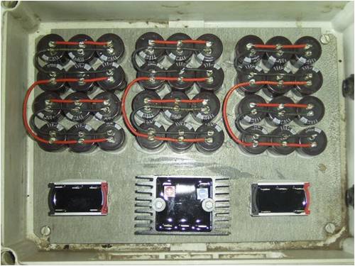

Gordon, I have sent you a PM for some advise on caps. I could not send a photo so I thought I might as well post it here so all can see. I still have trubble getting my head around the cap doubler but here goes.
I have 36 X 330 uf 250volt caps 2 X 50 amp recs and 1 X 100 amp rec and the recs are three phase. I heed some help to work out the wiring as I have not worked with 3 phase recs before. From what I can gather I was going to run the 100 amp as the main from the Gen and use the 50 amps with the caps. There is some wiring on the caps and I have posted a photo. As you can see the caps are in groups of 12.

Hi Amack ,
If you lay out your bridge recs like this the wiring flows a bit better
I will send it to you by email as well as it might be a bit small and you can use zoom to enlarge it

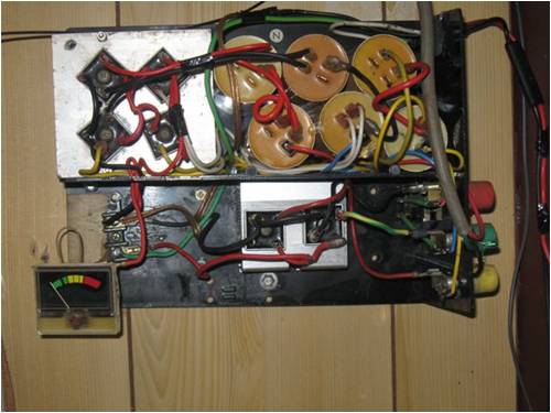

I have constructed that diagram using electric fence caps and was impressed with the results
The caps are 30uf at around 900v
The meter is looking at the cap arrangement current
I tried several configs on a small hand powered jig as I am vawt so low rpm
Once I get a few more caps I'll go back to testing again
Once I screwed this to the wall and hooked it up the wind instantly stopped
cheers
