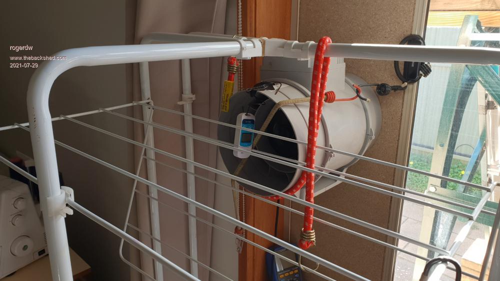

Well the air velocity is up to 6.3 m/sec from just over 4  ...  and the tube temperature is not dropping by much yet.

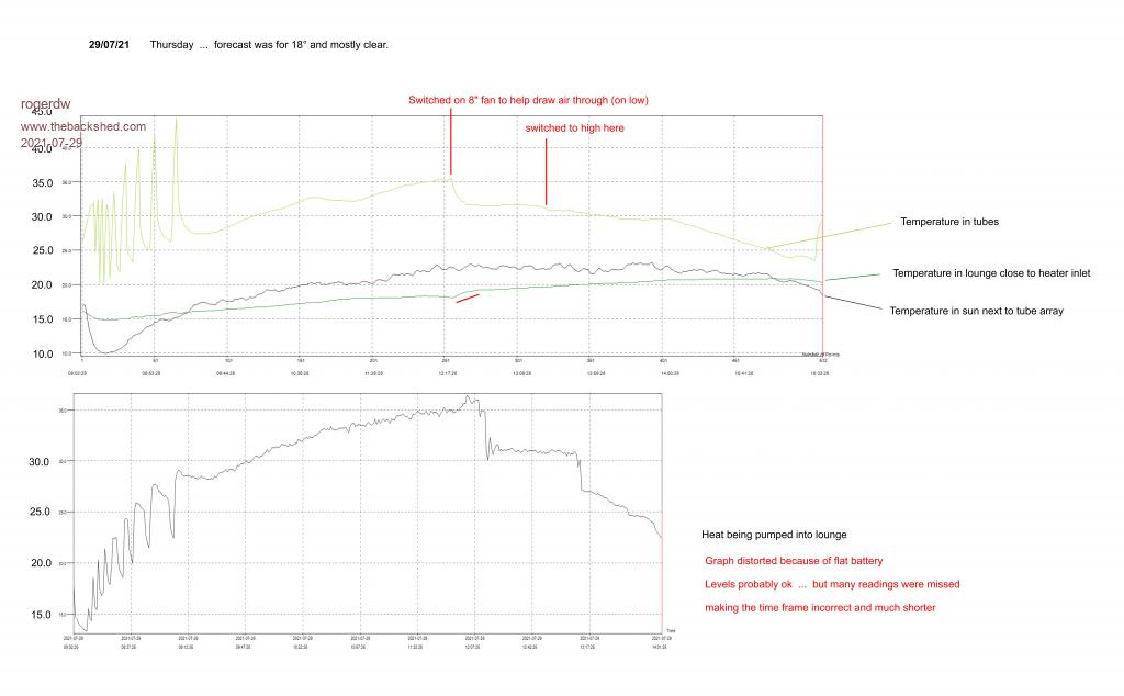

29/07/21       Thursday  ...  forecast was for 18 degrees and mostly clear.
Even though I had checked the battery voltage a few days ago  ...  I finally woke up to the fact that the battery was probably going flat in the outlet logger because the display started to look pretty faded when I pressed the button to show the display.
Under a 3mA load they all dropped to about 2.8v  ...  so tonight I replaced them all.
The day started with the first fan run about 8:17  ...  same time as last few days.
The fence shades the bottom third of the array at that time  ...  so on the roof should start earlier if good sun.
It's unfortunate that the output logger's data was corrupted as there was some useful info that was missed.
I've placed that chart below but even though it ran for the same length of time as the others  ...  its final data point was at 14:01  ...  while for the others it was at 16:33
After the discussion this morning I decided to fit the 8 inch inline fan on the outlet to help suck the air out of the tubes  ...  while still keeping the original fan blowing air through.
You can clearly see the point that I turned it on at 12:22 because the temperature in the tubes nose dived as more heat was being sucked out.
There wasn't a corresponding drop in sun temperature  ...  so can't blame that.
The only issue is that at 13:22 I switched the fan to high speed  ...  and you cant really see any major effect.
It does seem that the inside temperature took a leap forward at that point  ...  though I do wonder if it was because I was mucking about fitting the fan and held it all back for a while  ...  and then once it was free to run  ...  it caught up quickly. Not sure.
The inside temp went from a low of 14.8 up to 20.9 degrees  ...  that's a 6.1 lift.
There was no cycling at the end of the day because the big fan was not connected to the differential controller  ...  and when I saw the output was down to 25, I turned it off manually.
Cheers,  Roger

It seems more air is noticeably better.
It should make an even bigger difference with the larger system.
Cheers,  Tony.

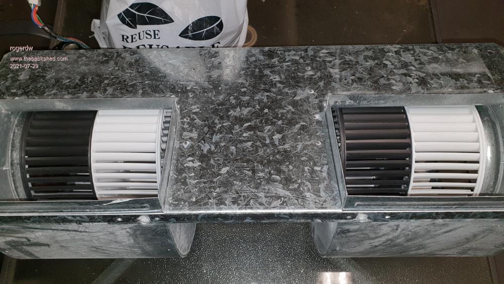

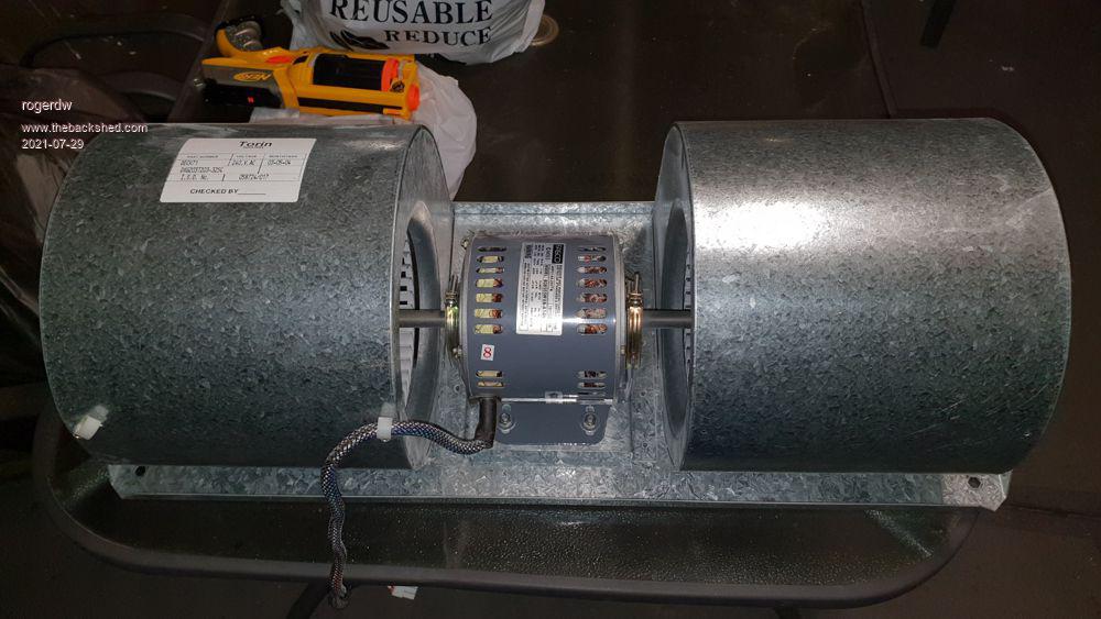

I've mentioned my scrappee mate who wrecks lots of airconditioners  ...  well when I visited him last I spotted this really clean and nice looking dual fan assy  ...  and once I'd drooled over it, he said to take it home.
I can't see this one being a fit in my new system  ...  but I'll bet he has something a lot closer in his megapile of dead aircons. Of course, there's no point going through all his stuff until I have it clear in my mind, just what I'm looking for.

  Warpspeed said  At 6.3 m/sec I think the washing will be swirling around the room.
Enter with extreme caution, and hang onto your hat.
When I switched it to high  ...  it was 7.1 m/s  ...  plus started to sound like it was going to take off.

Something like this single entry blower might have roughly about the right proportions and should develop a usefully high pressure at not too high rotor tip speed to become really noisy. Just as Dave suggests, the classic "jumping castle" style of blower might make an excellent starting point.
A big fat double entry blower like this one, can shift a lot of air, but will be very lacking in pressure. Attempting to drive it faster to gain pressure will suck up a lot of Hp.
Going to the other extreme, this really skinny blower could develop phenomenal pressure at a very high (and noisy) tip speed, but would be seriously lacking in flow.
With a practiced eye, and a few figures its possible to tell just by looking the probable flow and pressure capability, along with the rating plate on the motor.
That made me laugh!  Turn the whole room into a Clothes Drier and wouldn't they come out soft and Fluffy!  Hope the cat don't walk in there!
  Quote  When I switched it to high  ...  it was 7.1 m/s  ...  plus started to sound like it was going to take off.

I have been looking at some of the specifications of those jumping castle type blowers, two things stand out, the developed pressure is not all that high, typically 1,000 pascals, about 0.145 PSi or four inches of water rise, and they are rather noisy 70db to 90db. The airflow is quite high though.
I think the next step would be to first make some measurements on your small system on a nice sunny day. We need to know the temperature rise, the air flow, and the pressure drop across the sixteen tubes, preferably using a simple water manometer.
From that we can estimate the required airflow and pressure drop for the big system, or at least come fairly close to a blower requirement.
Cheers,  Tony.

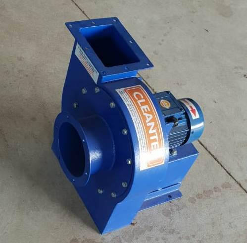

  Quote  One type I don't have and would love is the Impeller designs that have a Finned housing and often side by side inlets and outlets called Channel Blowers I think they are. Those things can Do a full PSI of pressure.
Those are called "side channel blowers" and are typically used as spa blowers.
They develop excellent pressure, but they really scream and just the highly objectionable piercing sound they produce, makes then totally unsuitable for many applications.
Dust extraction blowers might be the best suggestion so far, if they produce sufficient pressure, which is still an unknown requirement at this stage.
I think between the three of us we should be able to nail down a basic requirement and find something suitable that is not going to be too expensive.
