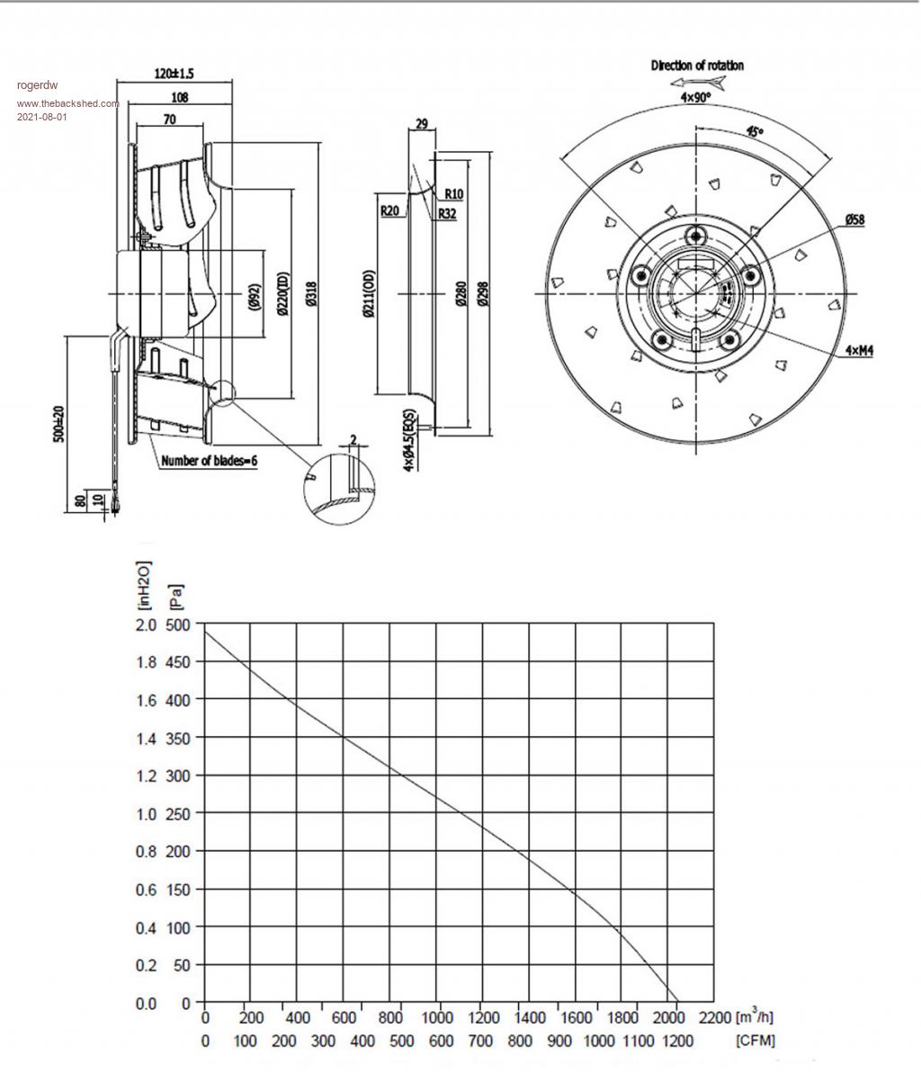

eg. my existing small 6" blauberg fan is ~50 watts and moves 500 cubic metres/hr with max pressure of 50 Pa
This fan here can move 3,434 cubic metres/hr at 633 Pa  ...
...  using 36-56V DC   5.8 A  278 Watts
So, 6.8 times more volume  ...  12.6 times more pressure  ...  5.5 times more power

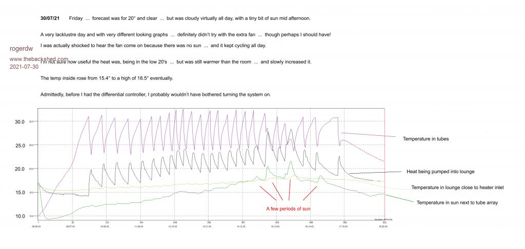

Todays results seemed a bit unusual  ...  and with the cloud we had I was surprised to see the fan run at all  ...  let alone cycle on and off all day.
Cheers,  Roger

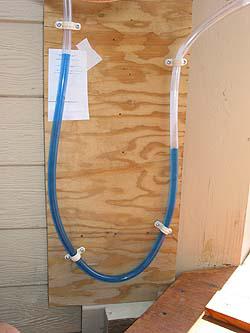

A water manometer is a very easy thing to make. All you need is some clear plastic tube with some water trapped in it.
Any difference in air pressure forces the water to rise and fall. Pressure is measured in "inches of water" the difference in heights between the two columns.
In fact it's the most accurate way to measure very low pressures.
Just drill suitable holes in your two manifolds, and insert the ends of your plastic tube, its as simple as that.

  Quote  A water manometer is a very easy thing to make. All you need is some clear plastic tube with some water trapped in it.
I watched a few youtube videos yesterday to get the concept, so that's under control  ...  but the holes we want are so we can measure the pressure near the start of the duct and also one near the end?  ...  or between the start and the end?

Thanks  ...  so one end of the tube open to atmosphere and other end into manifold.

I did quite a bit of blower testing a few years ago myself, and here is a thread on the PTS airflow bench Forum. I post over there as "Tony" but my signature there also includes my Warpspeed identity.  The facts and figures I mention there should work just as well for us here too, its very easy to extrapolate flows and pressures and drive power.
Even had a go at building a crude experimental blower housing out of an old oil drum which worked just as well as an expensive sexy commercial scroll housing.
http://www.flowbenchtech.com/forum/viewtopic.php?f=15&t=1188

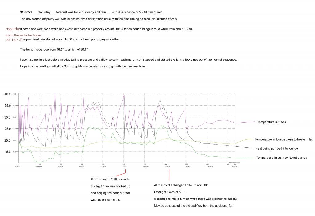

31/07/21       Saturday  ...  forecast was for 20 degrees, cloudy and rain  ...  with 90% chance of 5 - 10 mm of rain.
The day started off pretty well with sunshine even earlier than usual with fan first turning on a couple minutes after 8.
It came and went for a while and eventually came out properly around 10:30 for an hour and again for a while from about 13:30.
The promised rain started about 14:30 and it's been pretty grey since then.
The temp inside rose from 16.5 to a high of 20.6
I spent some time just before midday taking pressure and airflow velocity readings  ...  so I stopped and started the fans a few times out of the normal sequence.
Hopefully the readings will allow Tony to guide me on which way to go with the new machine.
It seems to me that the extra airflow through the system is extracting more heat from the tubes than normal  ...  and a couple times I thought that the fan turned off before it was necessary.
I finally woke up to the fact that the Ld was set to turn off when the outlet temp got to within 10 degrees of the room temp  ...  I though I had it set to 5 degrees.
Rather than make too big a jump, I changed it to 8 degrees and will watch how that affects things.
Cheers,  Roger

Output velocity 14 ft/sec multiplied by 0.1726 square feet = 2.4164 cubic feet/sec or 144.98 CFM.
The blower is rated at 560 cubic metres per hour (open flow) x 35.31 = 329.56 CFM.
So 0.4375 inches of back pressure reduces our flow from 329 CFM to 145 CFM about roughly half.
That is probably a pretty fair match between blower capacity and flow resistance, but two things stand out.
Our total airflow of 145 CFM is not really sufficient to pull all of the available heat from the tubes, the tubes still get pretty hot with the blower running continuously even on a cloudy day.  The second observation is that 0.4 inches is a pitifully low back pressure, but it is high enough to really challenge the flow capacity of that axial fan.
Now when you hook up the big 8" guy on slow speed to the small 6" guy, we get:
Inlet manifold 1.125 inches
Outlet manifold 0.4375 inches
Pressure difference 0.6875 inches.
Output velocity 19 feet/sec multiplied by 0.1726 square feet = 3.279 cubic feet/sec or 196.8 CFM.
The blower is rated at 805 cubic metres per hour (open flow) x 35.31 = 28,424 cubic feet per hour or 473.7 CFM.
The big blower is being substantially blocked by back pressure, 473 CFM drops to 197 CFM. Even on high speed the flow hardly increases any further as output velocity only rises from 19 Ft/sec to 19.3 ft/sec.  The blades are just cavitating and making noise.
Open flow at high speed is supposed to be 1080 cubic metres per hour x 35.31 38,135 cubic feet per hour, or 635 CFM.
The reality is that flow has increased from 145 CFM with the small blower to 197 CFM with both blowers going. That extra 52 CFM has made a noticeable improvement to performance, although the power and noise to get that improvement is not an efficient way to go about it.
But with 200 CFM+ I believe some further worthwhile gains in heat recovery are entirely possible.
When we go to the big 60 tube system the flow area will have increased by about 333%
And the larger blower all by itself will be much happier working against far less back pressure.
The open flow rating of the small blower is 329 CFM (high speed)
Open flow rating of the larger blower 635 CFM (high speed)
I would expect the actual flow with 60 tubes might end up about double, maybe 300 CFM or something.  But our heat input will have tripled, and our hot running tubes will reach even higher temperatures.

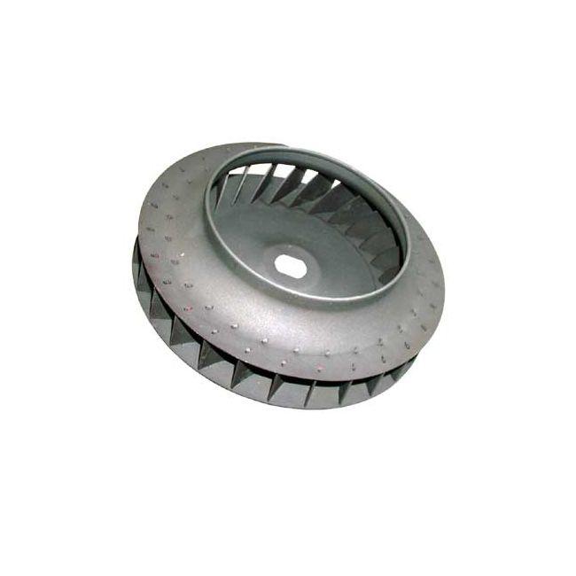

Dave, I have been sitting here thinking about what might work, and just had a crazy idea.
What do you know about the old air cooled VW engines? I have never owned or worked on one ever, but from pictures the rotor size might be just about right for diameter and width.
Cheers,  Tony.

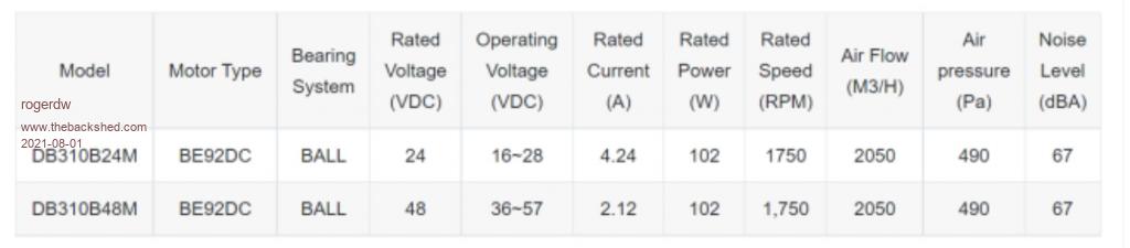

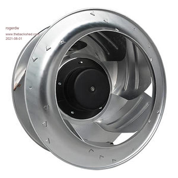

Here's a graph from a random fan I had looked at.
Has a maximum unloaded flow of 1,200 CFM but a blocked pressure of 2"H2O
  Quote  Fan Type: DC Centrifugal Fan Backward Curved 24VDC 48VDC
DC centrifugal fans with backward-curved blades are used primarily for intake suction.
Since most of the pressure build-up takes place in the impeller, there is generally no need for a scroll housing. The centrifugal fans have very good hydraulic efficiency and are ideally suited for high pressures.
The centrifugal fans are used in applications such as central air conditioning units or building ventilation systems.
This model no. is DB310B24M/48M. It works with 24v or 48v DC voltage input. Diameter size is 310mm. Impeller height 70mm. Total height with motor base is 120mm. Impeller material is aluminium sheet.
Only has a power rating of 102 watts though.
Here's the page
Cheers,  Roger
