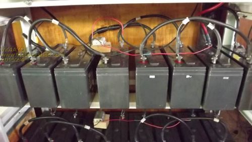

I am still waiting for some bits to finish the desulphator mentioned earlier, but from what I understand of the design it is a low to medium impulse suitable for leaving on the battery all the time, the guy that designed / adapted the circuit had that in mind when he built it.
Looking at the design of the unit the intensity of the output is governed mainly by the charge capacitor and inductor combination in the output stage and the rating of the fast recovery diode, most designs use the 555 as a driver, some with an extra driver stage before the Power FET I believe this would give a higher output and be more suitable for desulphation on a one of basis rather than being left on all the time.
I personally would use one per battery to minimize losses in the bank and be sure that each battery gets a good signal, that is why I am going to make a number of these units to go across each 12 volt pair of batteries, at the moment I am using one across each 24 volt shelf in the pack, it is OK but I think it could be improved on with more units. To do what I want would mean buying 24 units @ 12 volt and at over $60 each now our dollar has done a nose dive I decided to have a go at making some. Suffering from AIDS ( Acute Income Deficiency Syndrome) also known as Pension.
Note the desulphator across the 24 volts at the moment these are commercial units Infinity brand that have worked well for me and are rated for 1000 AH.

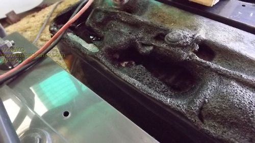

I have a battery that the top burnt out of in a fire in my shed several years ago and it sat under the bench flat for two years, after I cleaned all the ash and melted plastic off the top of it, I decided to have a go at reviving it.
The lead connectors in it where covered in white sulphate once I cleaned the burnt an melted plastic off and the top of the plates where a mass of sulphate, now several months later it has all cleaned up back to nice grey lead on the connector and no sulphate on the top of the plates, proof that they do work contrary to what a lot of the USA experts say. Note the sulphation on the connector on the left side of the picture.

I've also thought of another question (sorry):-
I gather from your posts Bob that your battery shed is generally quite warm? 30 or 40C + ? I seem to remember from school that ionic solids (like sail of sugar) dissolve better in warm water than cold which made me wonder if the sulfate would dissolve better in a warm electrolyte; i.e. if I want to desulfate my batteries, should I warm them up a bit (my shed is barely above freezing at the moment).
