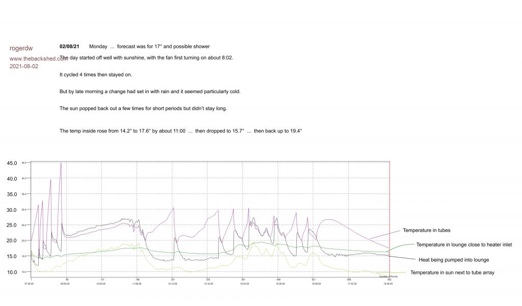

Todays results were mixed, with a great start but then a cold change came through late morning and cramped my style.
You can see the results on the chart of reducing Ld on the differential controller from 8 to 5 degrees  ...  the temperatures on the chart all appear much closer together.
The jumping castle fan is still being used.

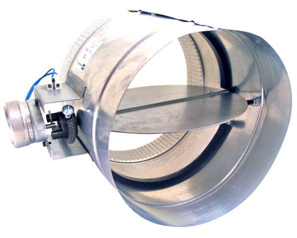

  Quote  To splice into the existing AC vents, you would just need a Damper from  The  tubes as a close off when the AC is on and a damper from the AC For when the tubes are in action.
Yes, just need to keep it simple to swap over  ...  and your remote control idea sound cool.

As far as I'm aware, the motorised AC dampers are pretty run of the Mill and not exy. Seen my mate Chuck out loads of the things.  Rogers mate should be able to hook him up with some.
From memory, The things can be set to part opening mechanically to effect air balancing in a system. Ironically, I have done that in my house just by cutting out some bits of cardboard and sitting them up above the Grilles. They can't be seen unless you look for them, ( be even harder to see if painted Black) but they do the job just fine.
Not really controllable on the fly though.  I usually have the spare room blocked off completely unless I am doing a shoot or someone is staying and then I just reach up, lift the grille and slide the cardboard out. Also tend to put some in Daughters room in summer to reduce the cold air flow so it maintains her preferred 30o c temp level.

Its just a geared motor and a potentiometer, rather like a drive by wire automotive throttle. I can see that if such a thing were mass produced, it need not be all that horrifically expensive.

I'm assuming you meant drawing from outside  ...  and if so you may be right  ...  but I suspect it will be leaky enough to accommodate quite a flow of air.
Between exhaust fans, downlights, aircon vents, doors and windows etc. Maybe it is more airtight than I think, but I would be surprised.

I didn't either until we moved here, our place has half a dozen and most have stopped working. We were quoted something like $240 each for new motor gearboxes for them  ...  and for once, I have not been able to fix them myself or find equivalent motors from China.
The motors have a built in gearbox with plastic gears and they have just been so hot that they go hard and brittle and fall apart or jam up. These also have a pair of limit switches so the motor stops and can reverse  ...  so while the tech is simple enough  ...  finding a replacement has been the issue.
Having said that  ...  I may simply be better off pulling out each complete damper assembly and fitting new ones with a different type of motor.

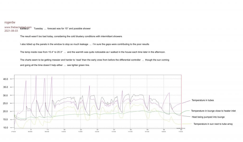

Here's todays results. Cold, blustery and intermittant showers  ...  but also intermittant sun.

There is more now happening, and the temperatures are closer together, so the charts will look a bit mote tangled than earlier.
But the overall slow steady heat gain in the house is definitely there.

  Warpspeed said  There is more now happening, and the temperatures are closer together, so the charts will look a bit mote tangled than earlier.
Yes  ...  really have to look closely to see what's happening  ...  but the end result with a higher inside temperature is good to see. Always looking for more and quicker, but that's human nature.

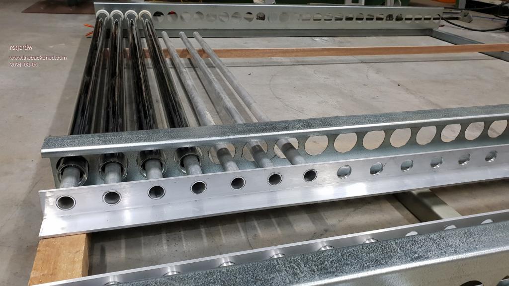

My 'how can I save effort/time' or I like to call it my 'lazy' gene was trying to kick in this morning when thinking about the aluminium tubes.
I was thinking that because the tubes are going to be horizontal and with no real force on them  ...  why can't I just assemble it on the roof and simply glue them in.
If I used high temperature silicone, something like Selleys RTV  ...  that should be enough to hold in place and provide an airtight seal  ...  and it should be able to cope with the extreme temperature too.
When I did my apprenticeship, and they still used to fix stuff like that  ...  we used RTV silicone to seal the soleplates on irons  ...  and it coped perfectly well with high temperatures, steam and pressure.
Anyway, it's just an attempt to get out of what I know I need to do and that is weld them all in. The only way I can see to do it is to clamp them all together vertically  ...  then set up a platform or something so I can reach to weld them around the top.
It's going to be difficult enough to do the job without trying to do vertical welds  ...  I need to get them so the weld action is horizontal.
Get onto your AC mate Roger. He should get them regularly from upgrades and probably just chucks them like my mate. Even new he should be able to buy the whole Duct for about $60 or so each wholesale.
All you do is untape them from the duct and put the new ones in. They are double layered, the inner duct that carrys the air, the insulation layer and then another duct to hold in the insulation that goes over the top.
3 turns of tape on each duct sleeve ( which your mate will have  boxes in stock of) re connect the wires and that's it. They may have to start in the open or closed position for the controller but other than that.... Done many of them myself and it's an unskilled labour Job.... which is why my mate takes me along to help.... :0)
Whoever quoted $240 ea was having a big lend of you unless that was supply and fit but even then....

Yes, that is what I plan to do. Drag up the basic frame first, then each set of 30 tubes, then the ducting sections and covers, and last the glass tubes.
My comments related to using Selleys RTV Silicone to glue the tubes into the centre duct  ...  rather than weld them in before I lift them on the roof. It was a dumb idea really, just being lazy.
Maybe if I blow too many holes in the tubing as I weld them in, I can use the silicone to fill the gaps.
